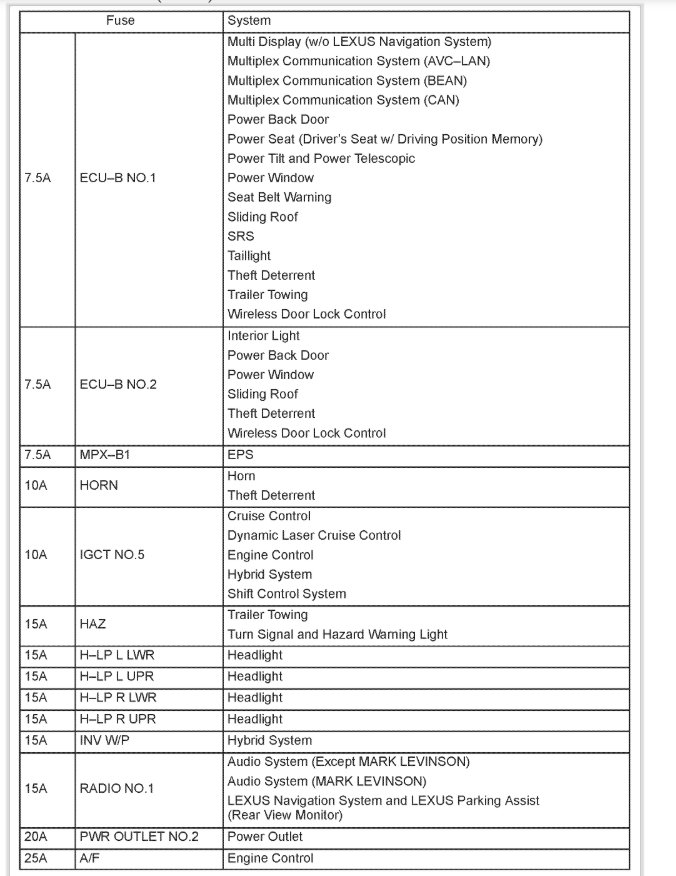

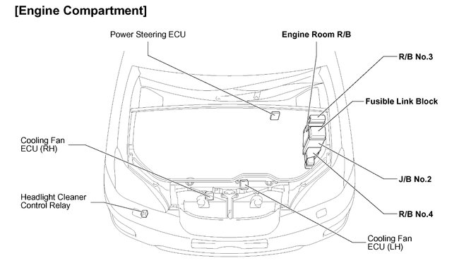

After battery change, when I select reverse gear the display changes to the rear camera but without the green/red guide lines which should appear. Instead 'System not ready' is written across the screen. Is this a known fault that anyone is aware of? Already I have disconnected and connected again the battery, with no result.

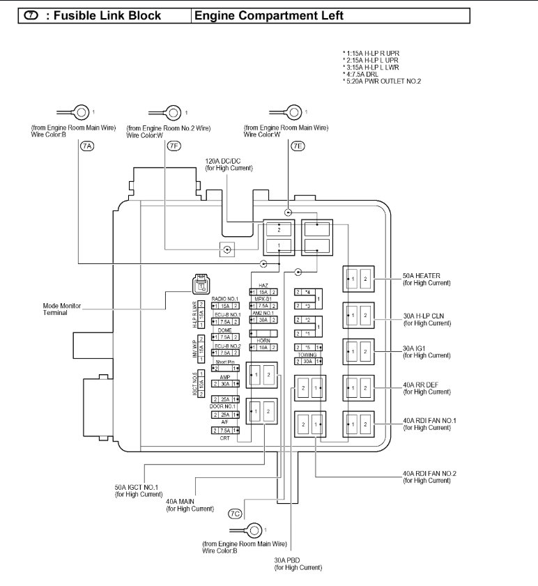

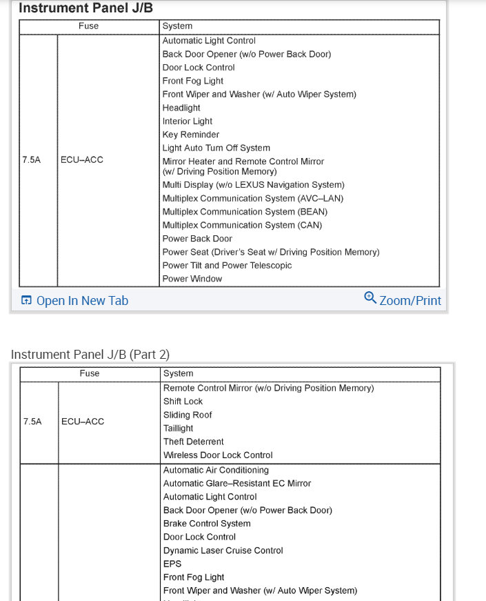

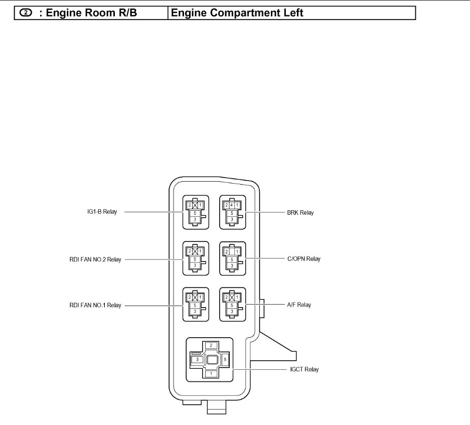

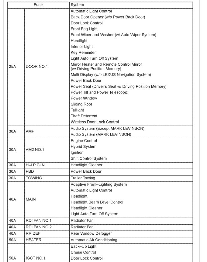

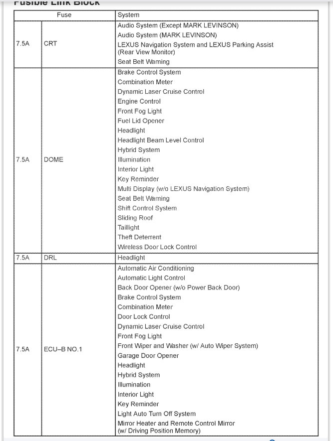

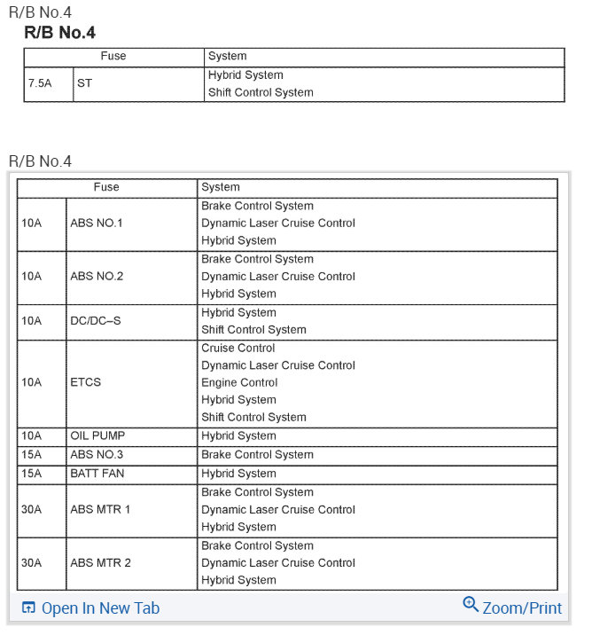

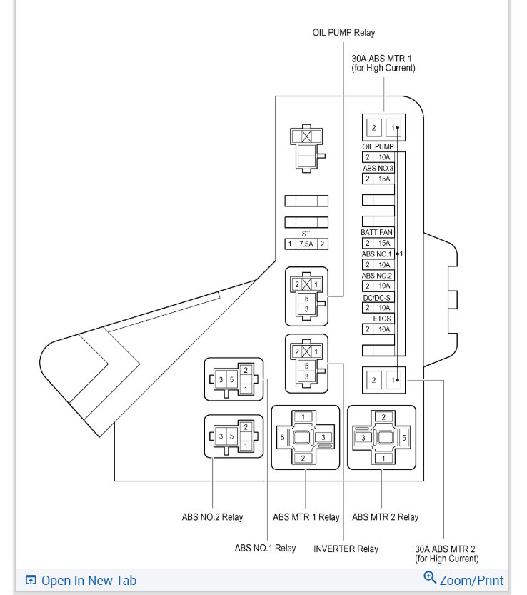

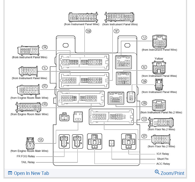

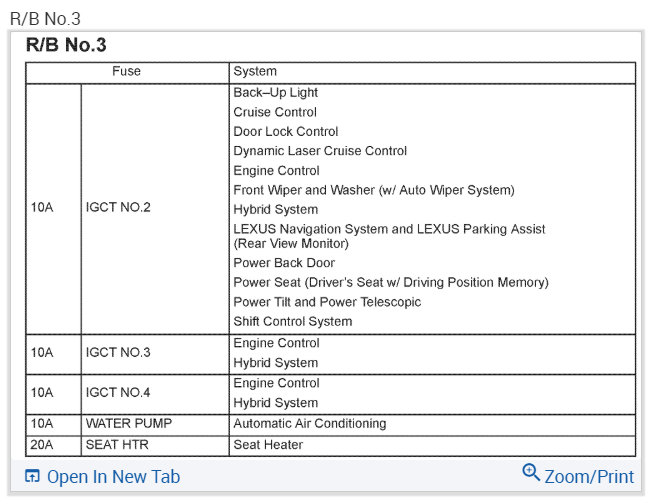

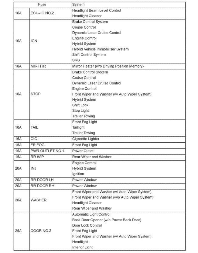

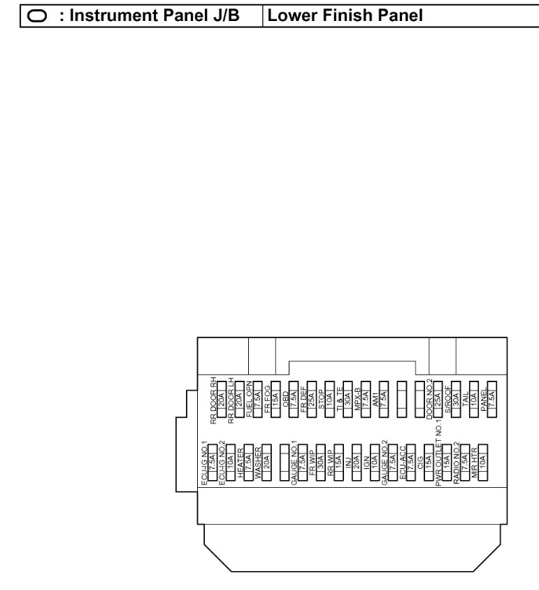

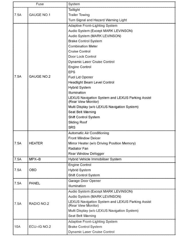

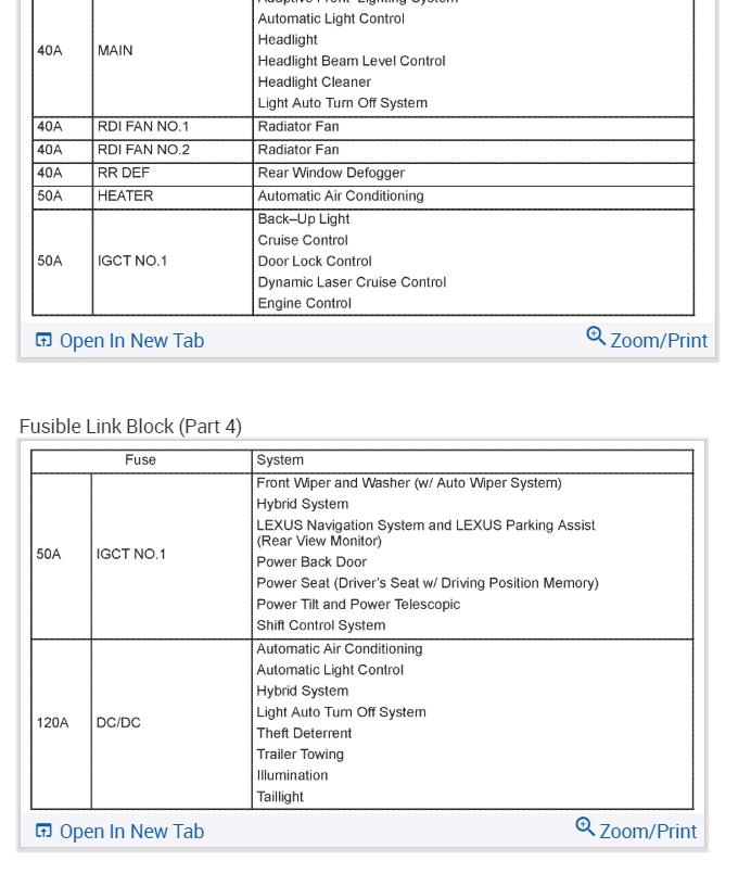

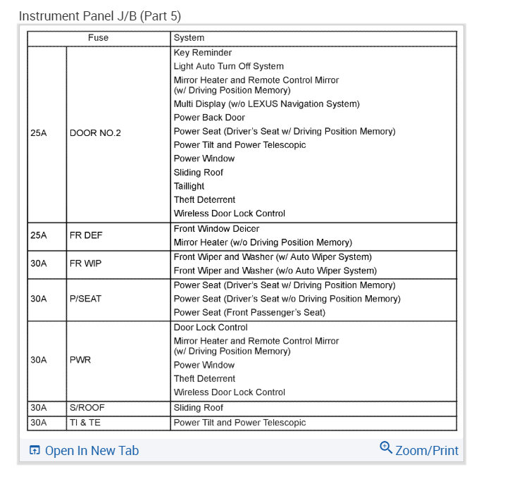

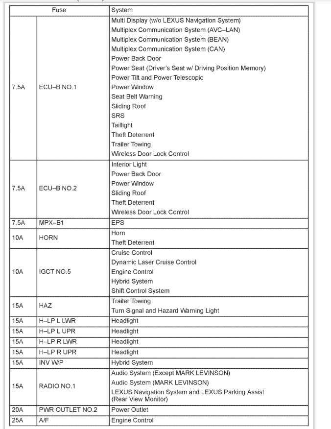

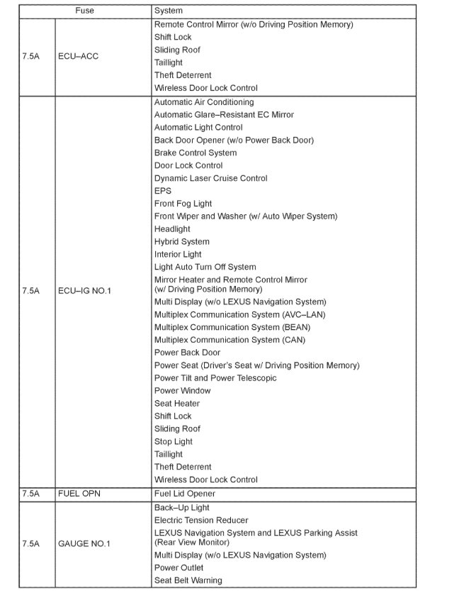

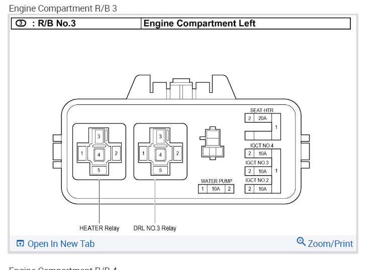

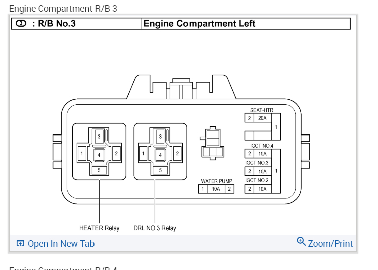

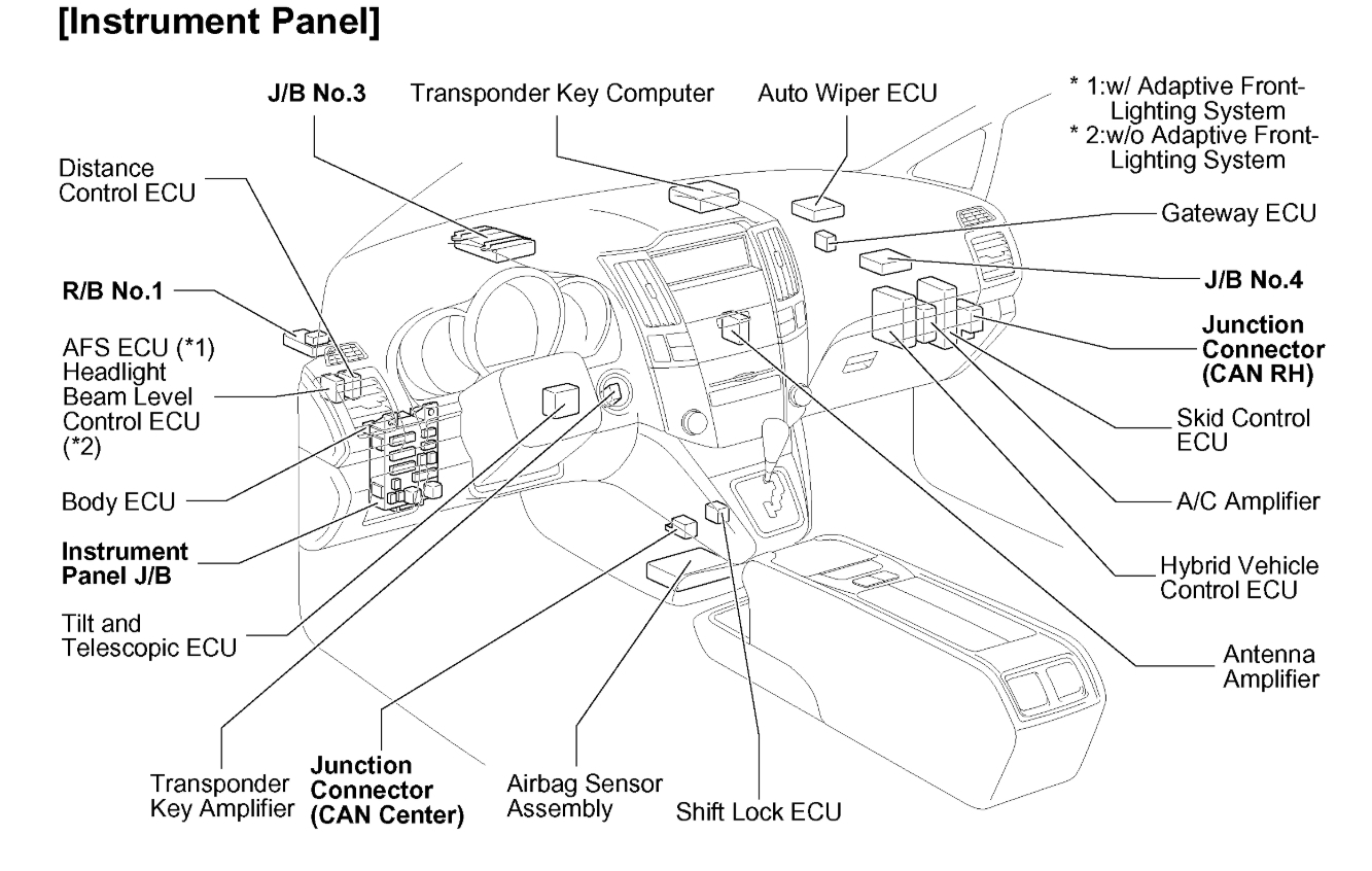

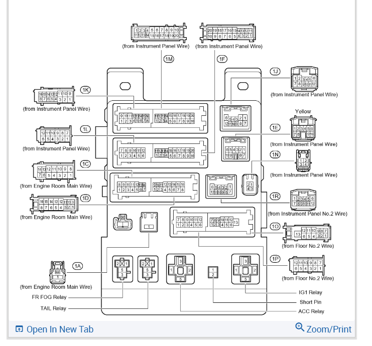

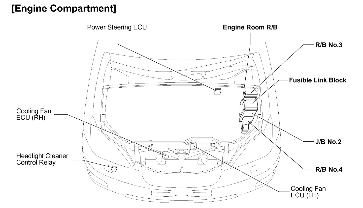

It sounds like the 7.5 amp CRT fuse popped under the hood which is common when replacing the battery here is a guide to help make sure and the fuse location as well.
Here are all fuses and relays to help you in the future you can save this page too your favorites. Check out the diagrams (Below). Please let us know if you need anything else to get the problem fixed.

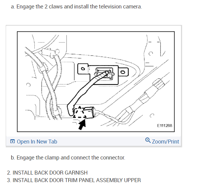

I have the same problem. I just replaced the 7.5 amp CRT fuse and the problem is still there.
I used the fuse which was in the fuse box (as replacement).
My question: is the solution 100% the crt fuse? Did i had bad luck and had also a bad fuse in the replacement box? Or could it be another fuse to replace?
Thank you

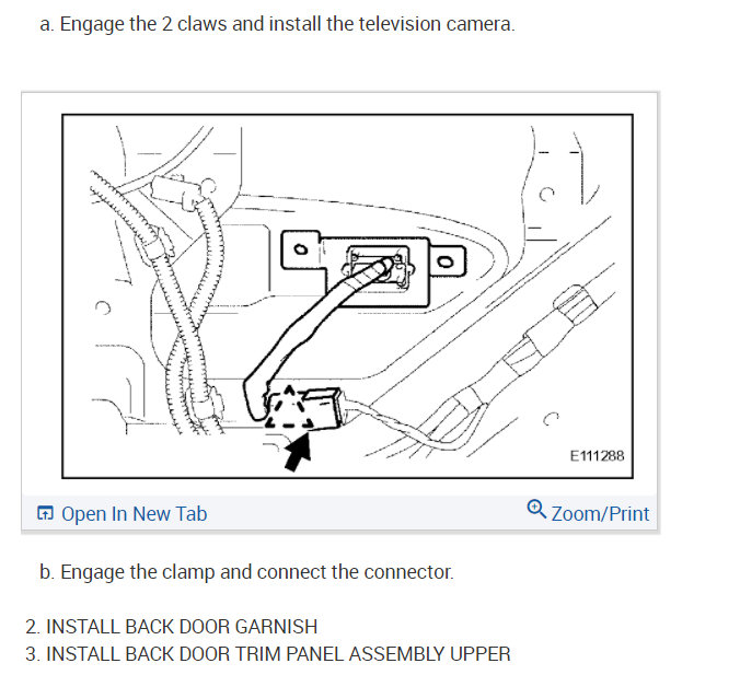

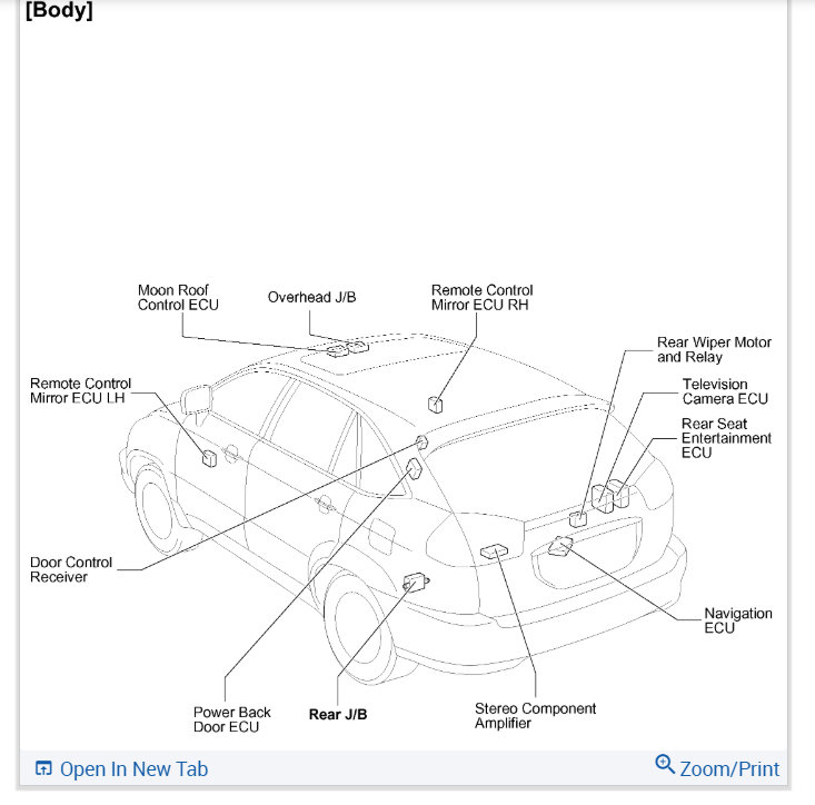

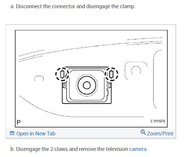

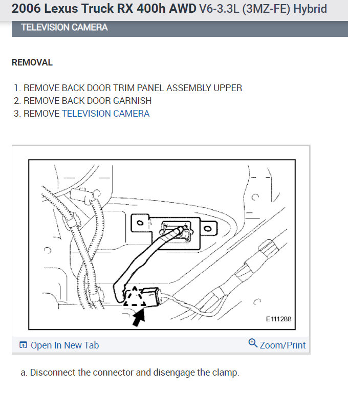

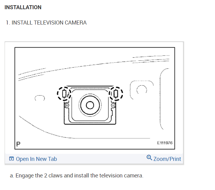

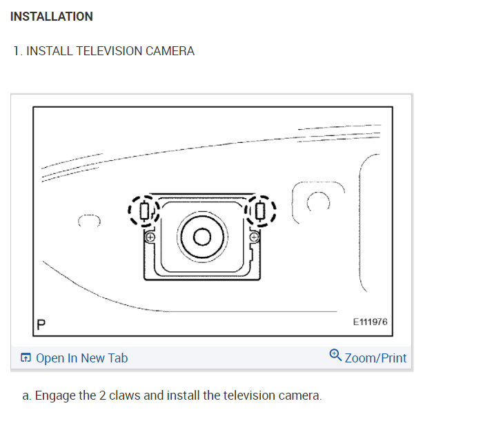

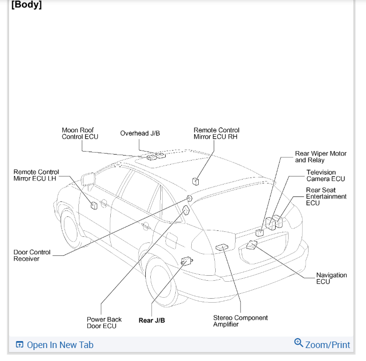

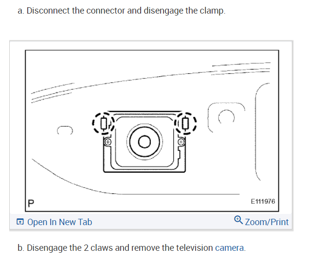

9 times out of 10 it will be the camera that is out. here are the instructions on how to replace it in the diagram below. Check out the diagrams (below). Please let us know what happens.
