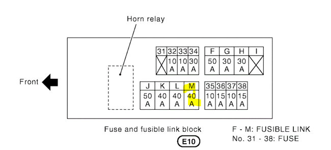

Hi, please i need to figure out why my key won't turn on ignition on, insert the key but it won't turn over.
I do not know what voltage need to come for it to turn over, i have controlled everything, lights and horn okay, which means BCM is okay, i even swap BCM, also change fuse box in the engine compartment. all fuses have been 10 times checked.

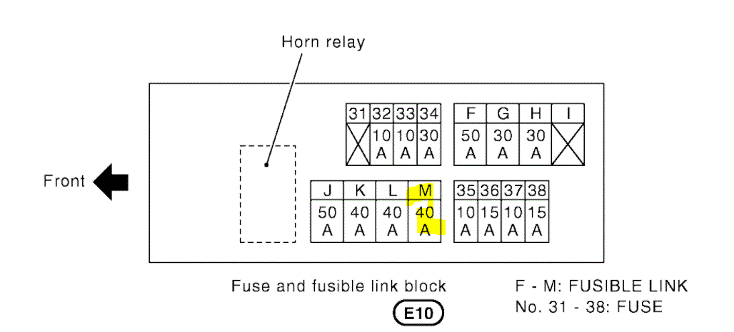

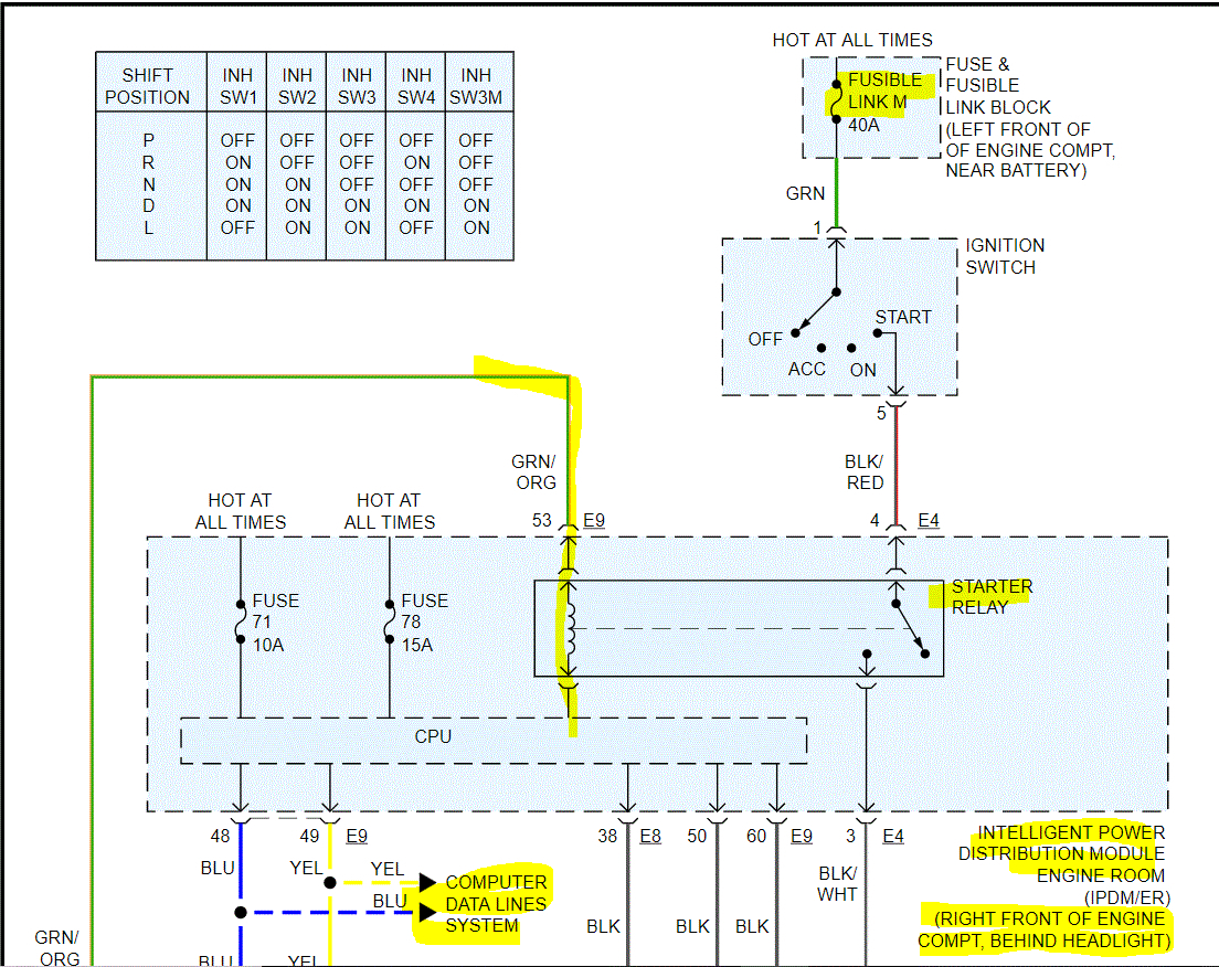

If the starter isn't working, we need to confirm a few things. You indicated fuses are good. Is there power to the fuses involved? Also, there is a fusible link that powers the ignition switch. It is fusible link M. Make sure there is power both to and from the link.

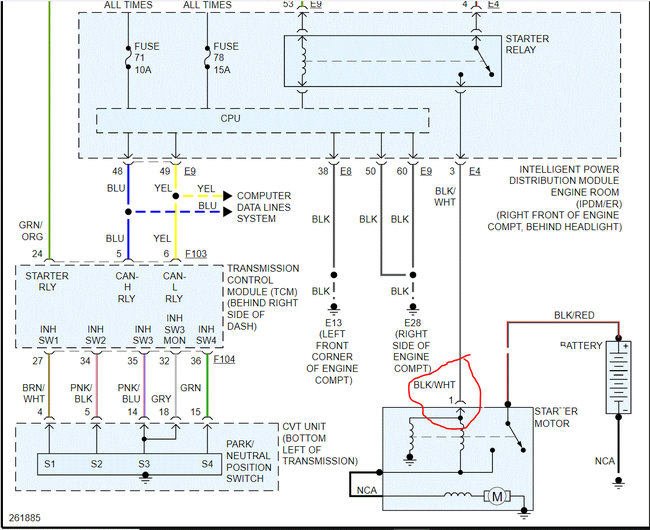

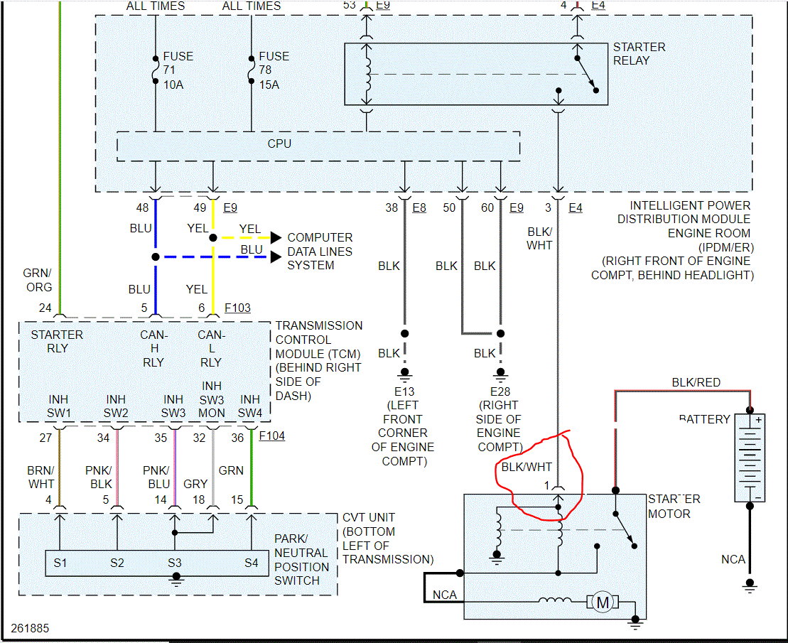

If it is good, then we need to see if power is getting to the starter itself. There are two wires at the starter. One is larger in diameter and has 12v at all times. The smaller one, which is black with a white tracer, only gets 12v when the key is in the start position. Have a helper turn the key to start while you check that wire for power.

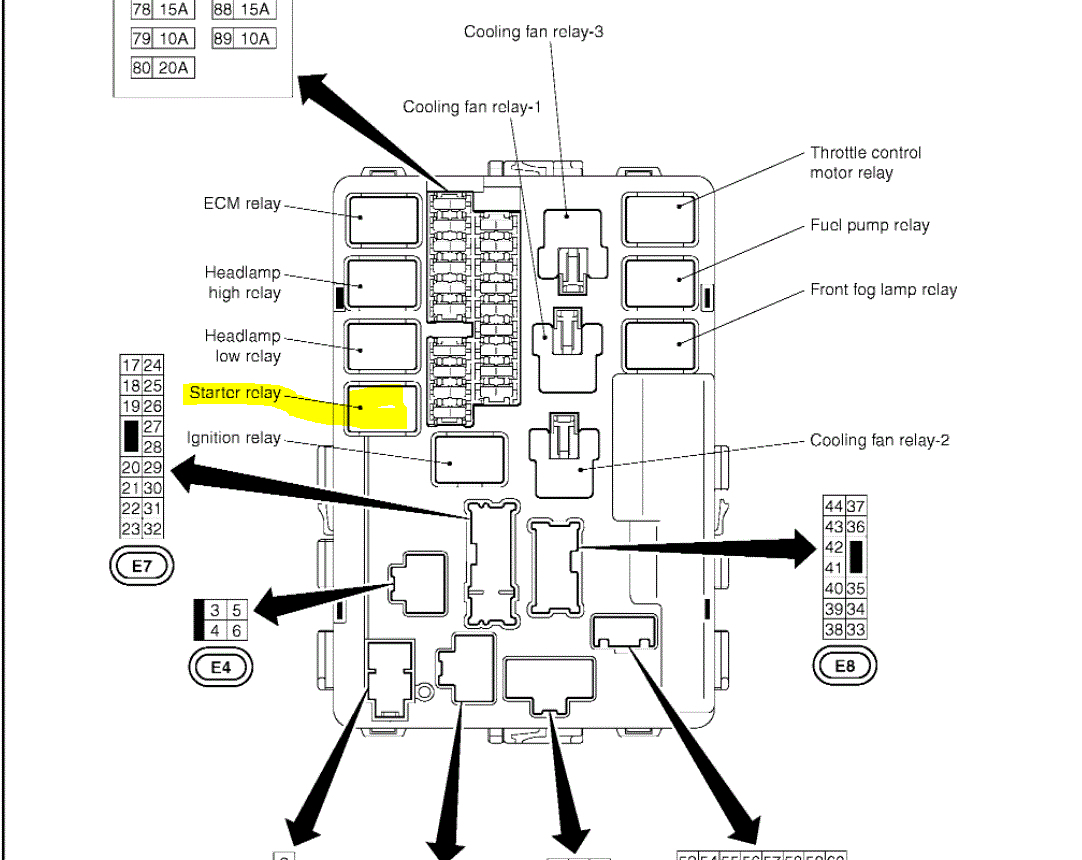

Also, if you haven't checked the starter relay, I recommend it. If there is a different relay that has the same part number, switch them to see if it makes a difference. If there isn't one, here is a link that explains how to test a relay:
If you look at pics 1 and 2 below, I highlighted the fuse and relay I need you to check. Additionally, pics 3 and 4 are the wiring schematic for the starting system.
Let me know what you find or if you have other questions. Also, let me know if there is any sound from the starter when you try to engage it.
Note: The schematic was one page long. I had to cut it in half to make it readable for you. I did overlap them so you can follow from one to the next.
