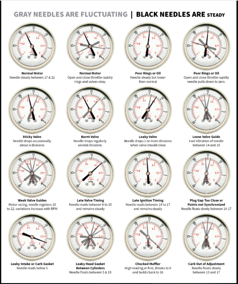

There are a number of things that can cause this, but we need to start with the basic things that can cause this. That means we need to find out if we have a fuel pressure issue using this guide to help with this:
We need to know what the pressure is when this issue is happening and then we need to check for a vacuum leak when this is happening as well.
More than likely you will find a vacuum leak but if not, we need to put a vacuum gauge on the engine and that will tell us if we have an intake valve issue as well which would cause all these issues.
Below is a chart that will show what the vacuum gauge should be, and issues based on what it is doing.
So, let's run through this and we can go from there.
