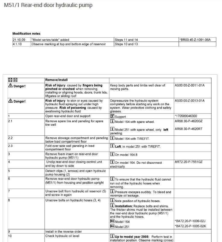

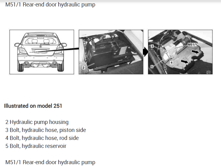

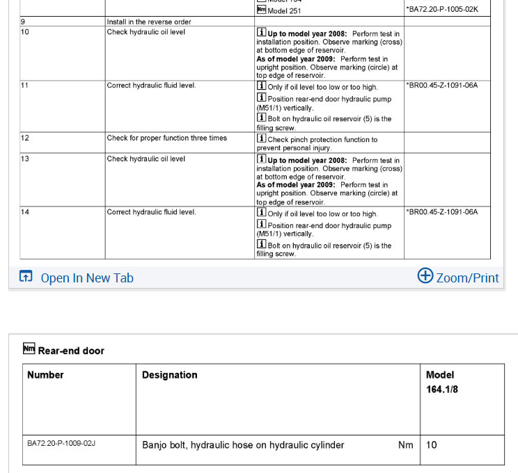

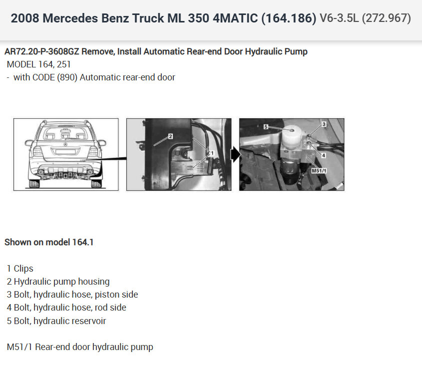

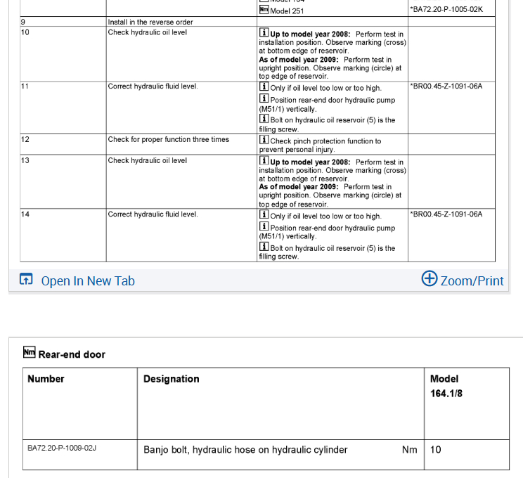

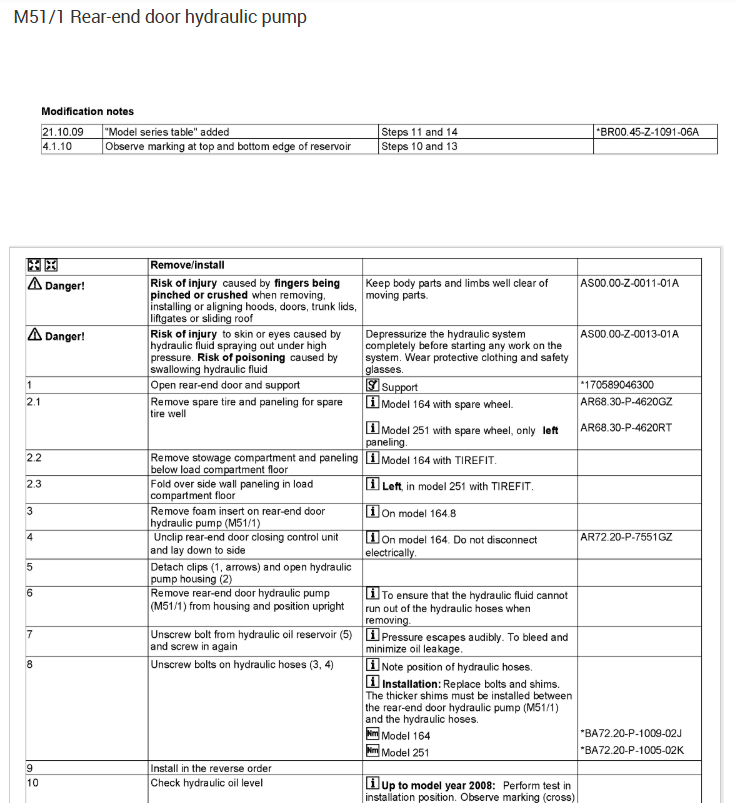

Yes, I would clear the codes due to the battery being low and see if any come back. As far as the liftback, the hydraulic pump does not like to be forced so I would say it needs to be replaced to help fix the problem, here is how. Check out the images (below). Please upload pictures or videos in your response of any problems so we can see what to help you with.
