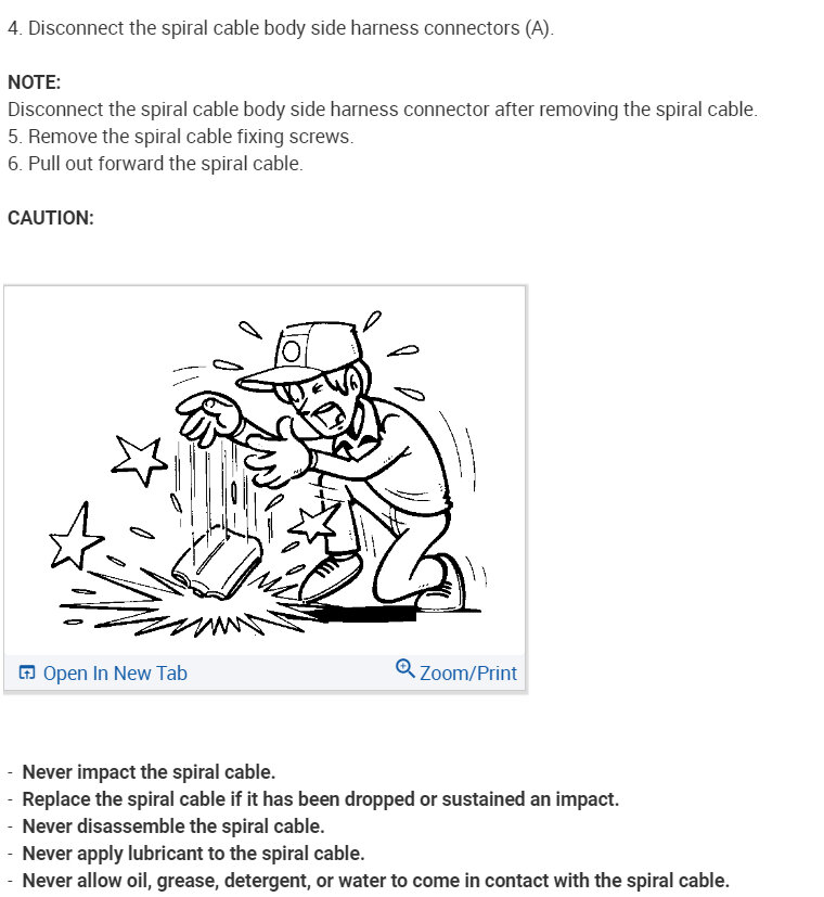

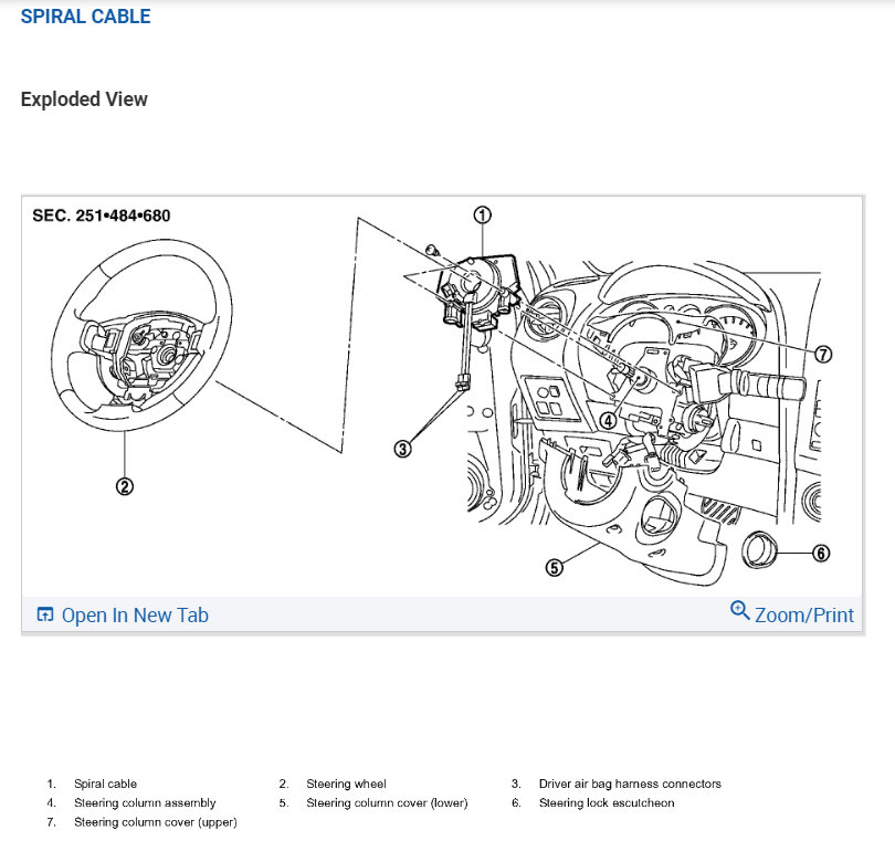

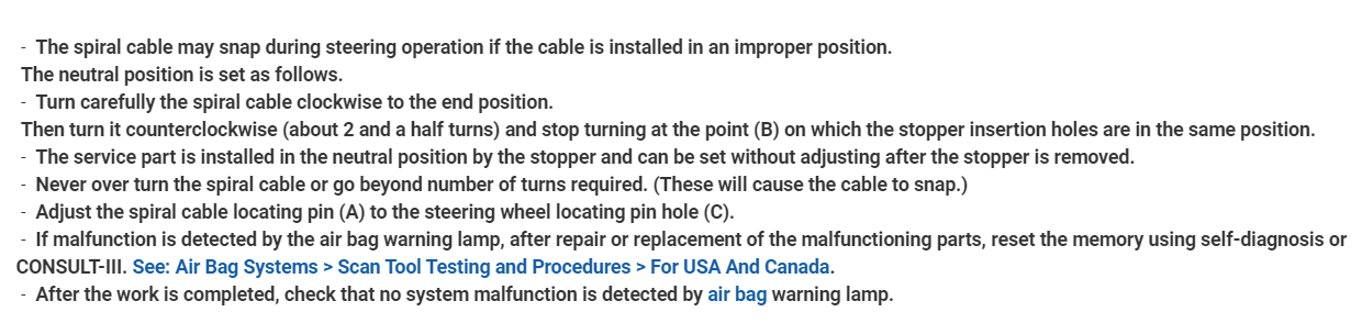

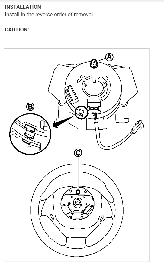

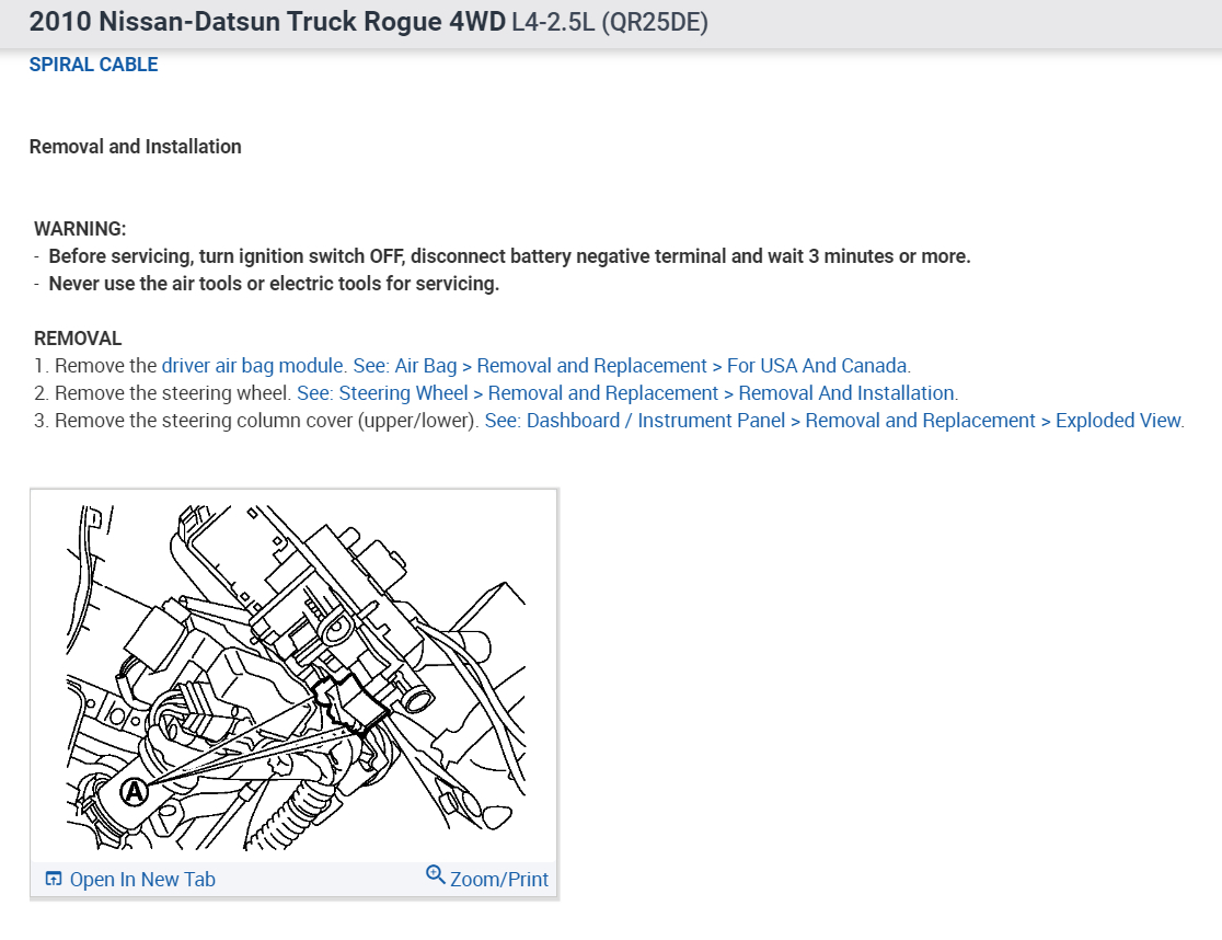

I don't think the brake noise will be replaced so please start a new question for that issue. It sounds like the clock spring is defective or it got installed incorrectly which can damage the clock spring internally. so, I would get a replacement and do the repair again. Also, I would recommend an OEM part if the problem continues. Here are the instructions on how to replace the clock spring correctly.
