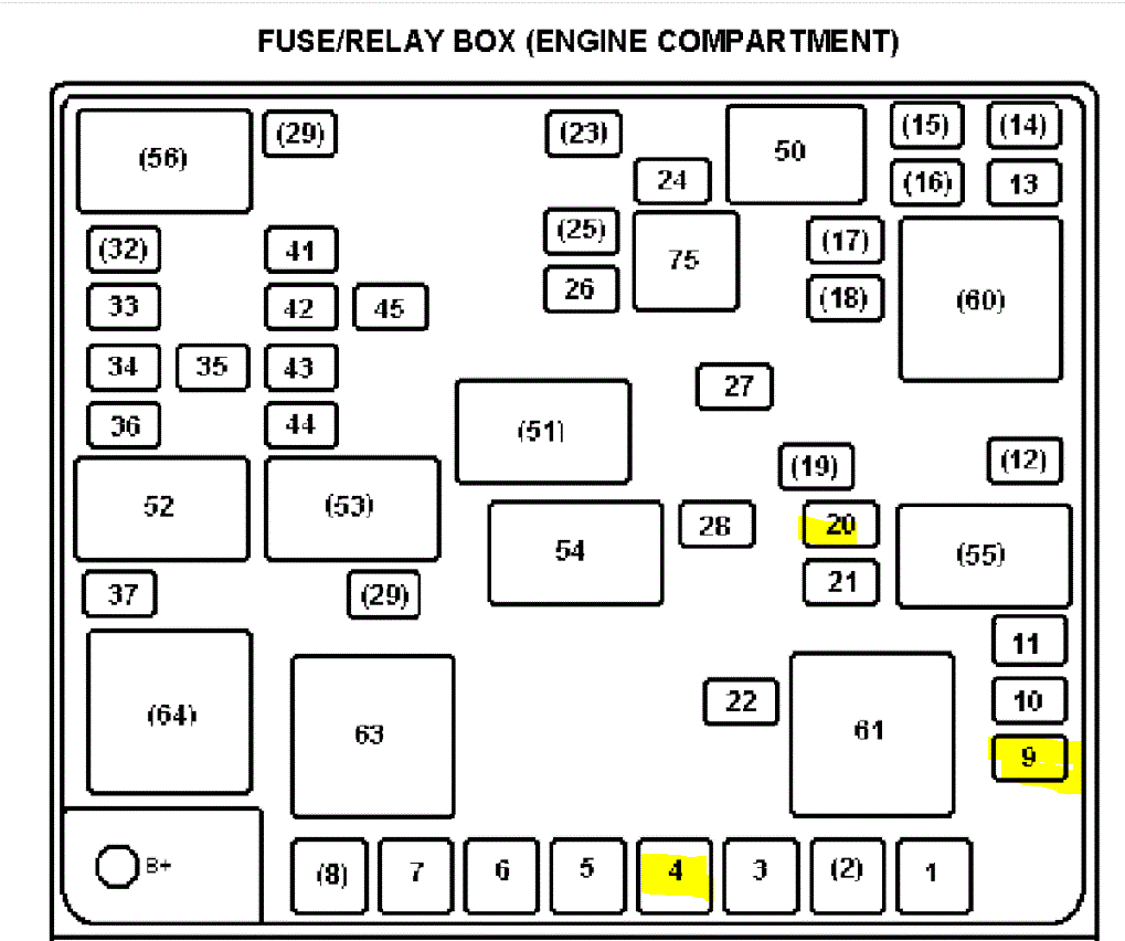

I will try my best to help. Here is what I need to know. First, when you turn the key, does the starter engage and turn the engine, or does it just click and that's it? You mentioned both above and I just want to confirm.
Next, chances are the transmission doesn't need to be removed again, so relax. However, I recommend checking the fuse box you moved. Make sure nothing is loose, damaged, and there are no blown fuses. One other thought. You indicated the voltage goes from 12.4v to 9.0v. Is that when the key is in the start position? If it is, that too is normal, but the starter should be engaging.

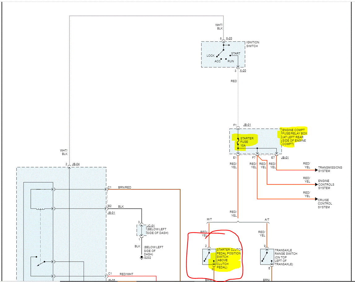

If possible, record what it is doing and upload it for me to hear. Additionally, check the starter fuse in the engine compartment fuse box and the starter relay. One other thought is the clutch position switch on the clutch pedal assembly. Since you had the clutch MC out, make sure the connector is plugged into the switch and make sure the switch is properly mounted and working to allow the flow of power to the starter. If the switch doesn't fully actuate, the starter will not engage.
Here is the list I need you to follow:
1) Check all fuses in the under-hood fuse box. (See pic 3)
2) Check starter relay in the under-hood fuse box. Note: If there is a different relay with the same part number, switch them. If there isn't, here is a link explaining how to test:

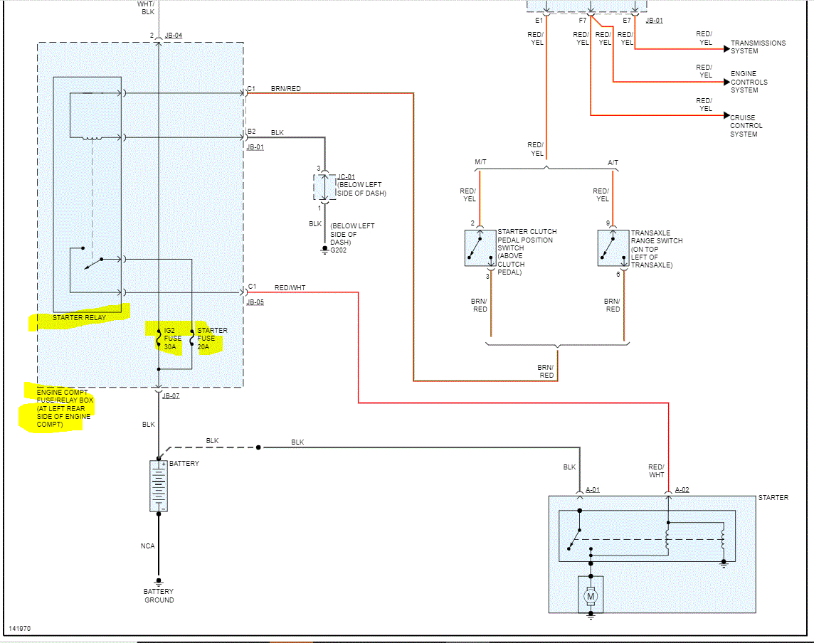

3) If the relay is good and fuses are good, go to the clutch safety switch at the top of the clutch pedal. There will be a red wire with a yellow tracer going into it. That wire is from the 10-amp starter fuse. It will only have power when the key is in the start position, so you will need a helper to confirm power. If there is power, depress the clutch and check the brown wire with a red tracer for power. This wire completes the circuit and will only have power when the key is in the start position and the clutch is depressed.
4) If the clutch switch is good, go to the starter motor. The heavier gauge wire will have 12v at all times, so make sure not to short it. There will be a smaller trigger wire which is red with a white tracer. That wire will only have power when the key is in the start position and the clutch pedal is depressed. Again, you will need a helper to confirm. If that wire has power, the heavier gauge wire is good and has 12v, and the battery terminals are clean and tight, either we have a bad starter, or something may have gone wrong when you reinstalled it.
