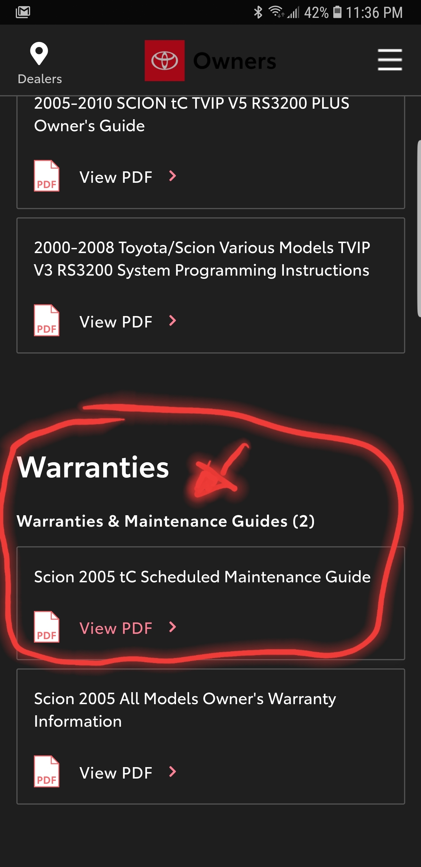

As for the oil consumption, Toyota did have an issue with piston rings. But you are way out of warranty to address it now. I would maybe recommend 3,000 mile oil changes at this point. But if your using synthetic you should at least check the oil level and top it off every 1,000 miles. But here is a link you can scroll down to maintenance. You will be special coverage and follow it. The owners manual will be the final say so on what needs to be done.
https://www.toyota.com/owners/resources/warranty-owners-manuals/tc/2005
