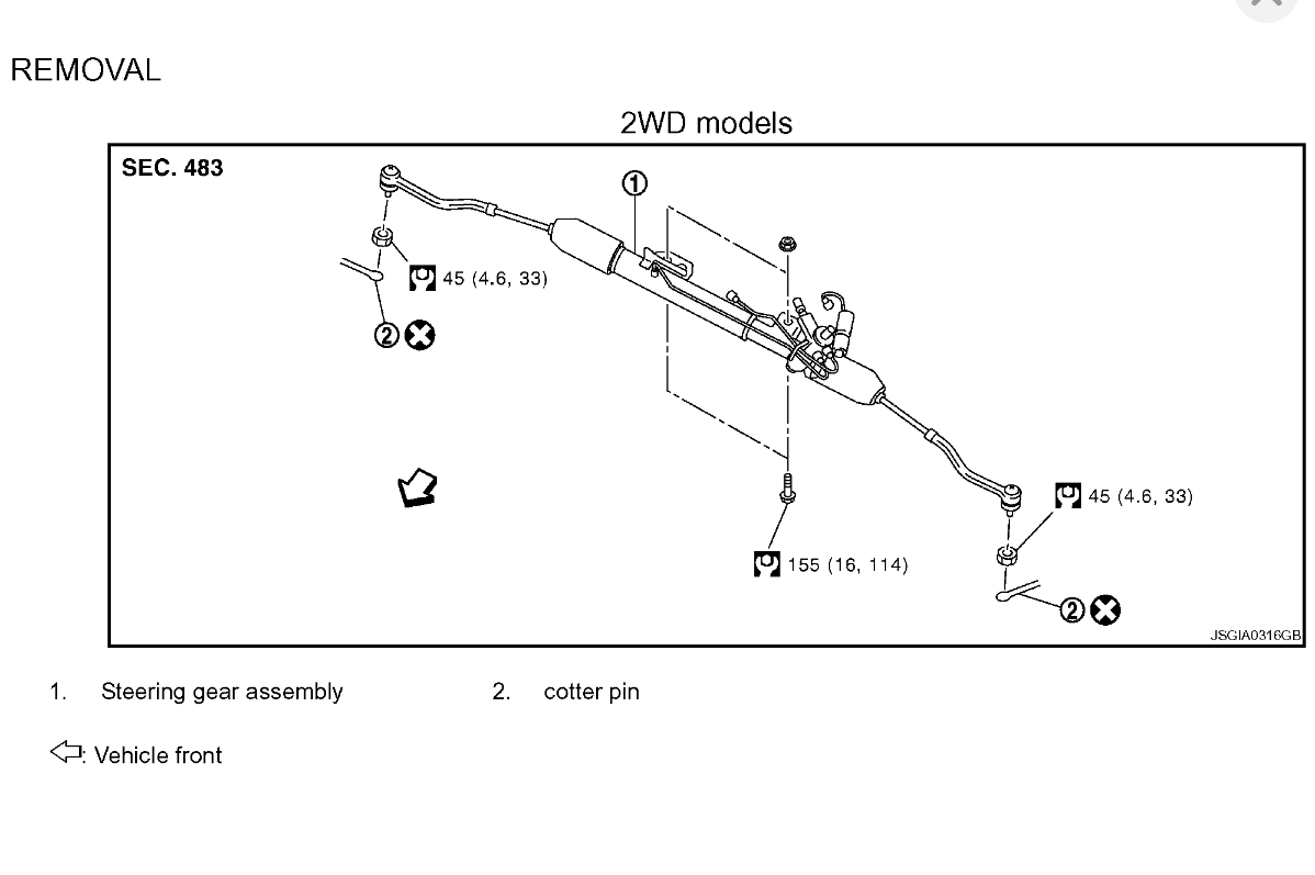

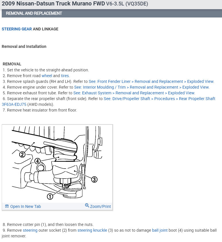

Can I get step by step instructions on how to replace the rack and pinion?
155,000 MILES • 3.5L • V6 • 2WD • AUTOMATIC
VERONICA WIMMS
  • 144 POSTS

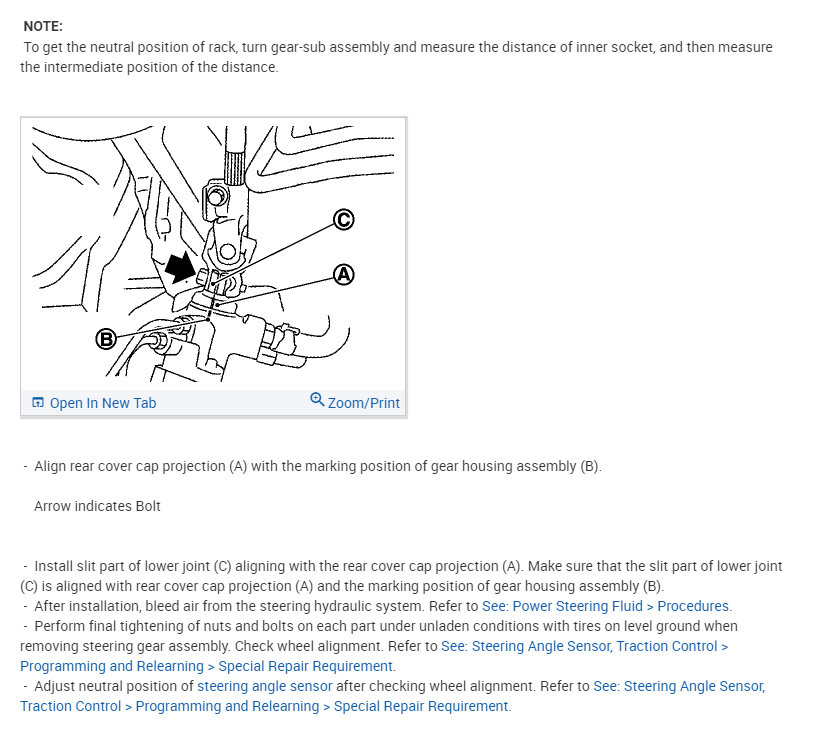

Power steering/rack and pinion issues. How do i remove step by step the rack and pinion and what tools are needed to do it?
Oct 31, 2021 at 3:34 AM
SQM
  • 6,383 POSTS

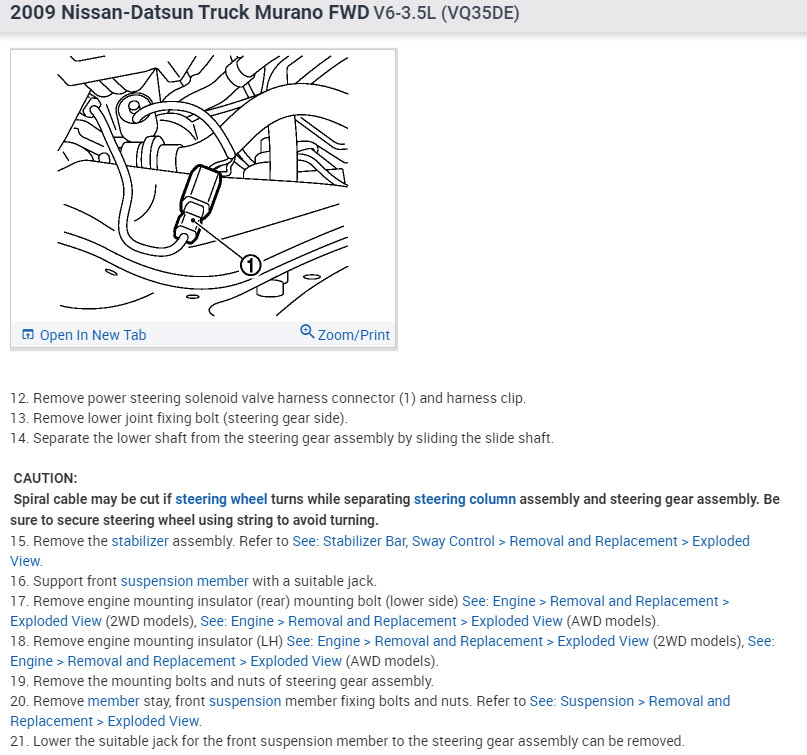

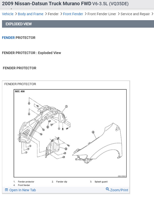

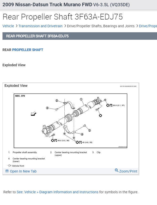

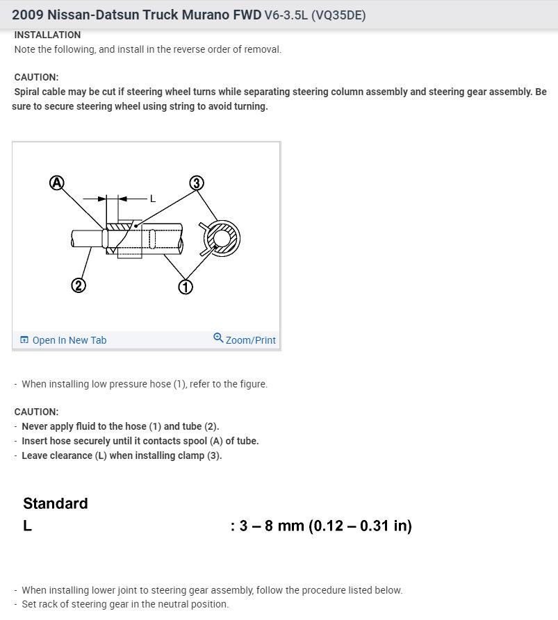

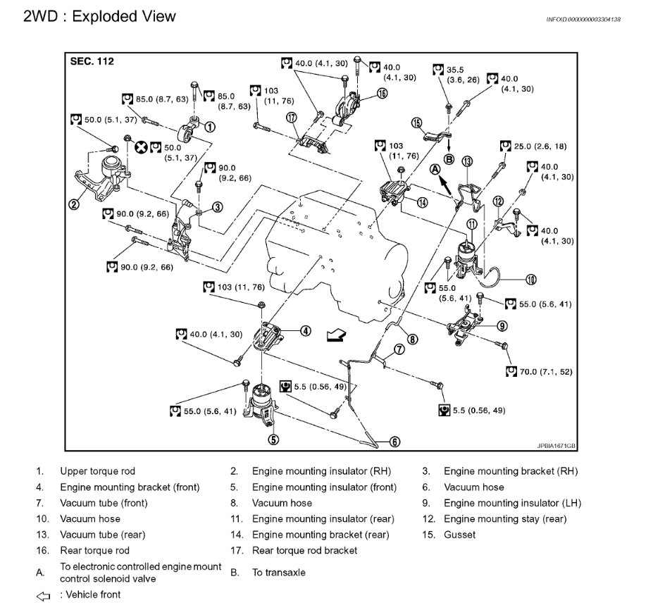

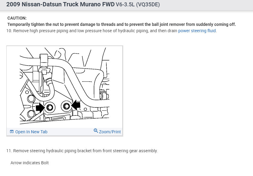

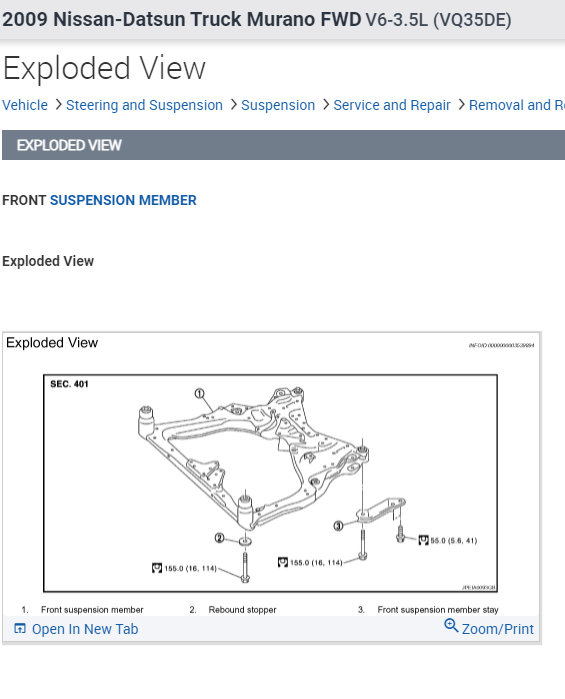

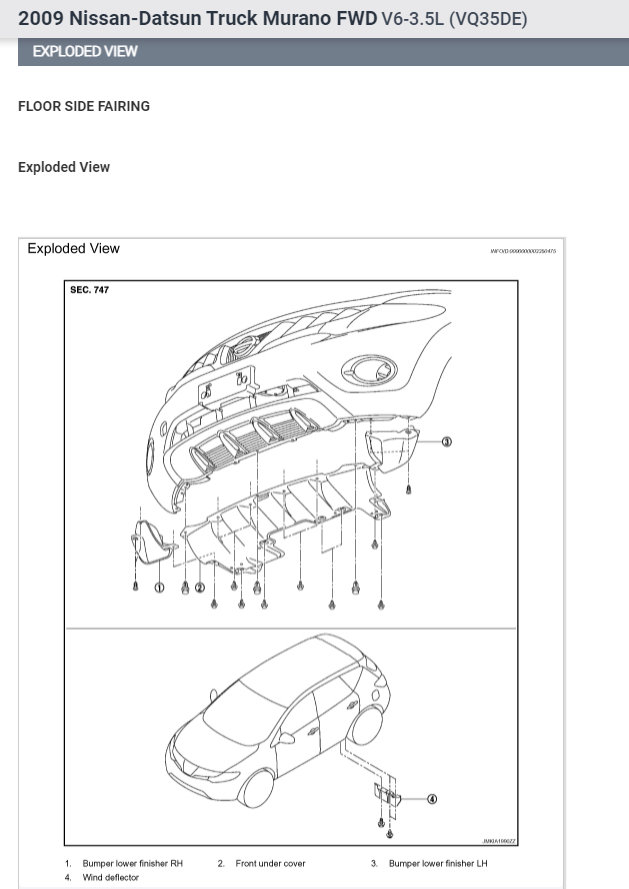

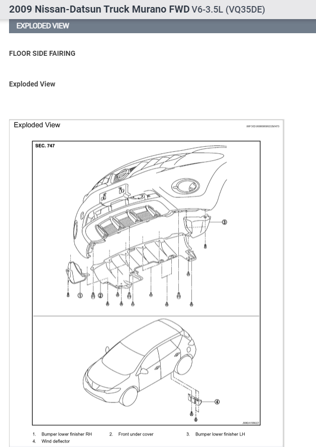

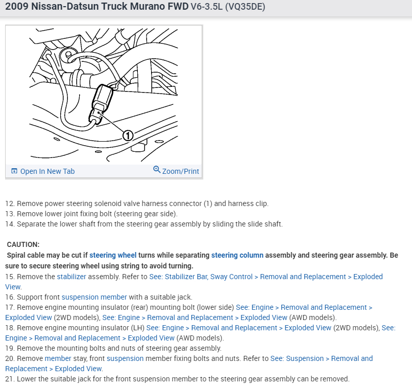

In order to remove the rack and pinion, there are few other components need to be removed. Both fender liners, engine splash guard, motor mount, disconnect propeller shaft.

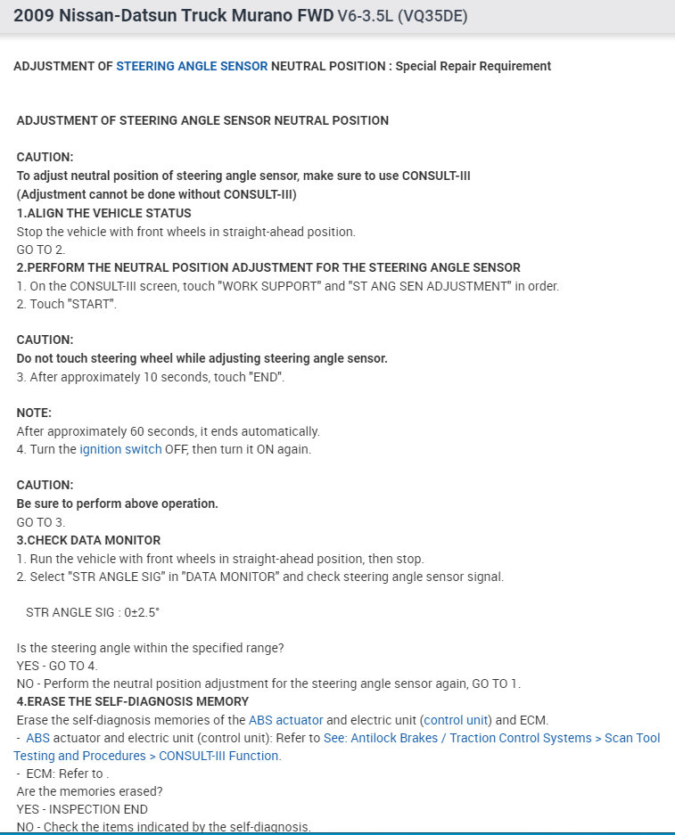

It will be required to re-program the steering angle sensor, which will require a special scan tool.
There are no required special hand tools for this task. You will just need basic hand tools like different size wrenches and sockets, along with breaker bars.
