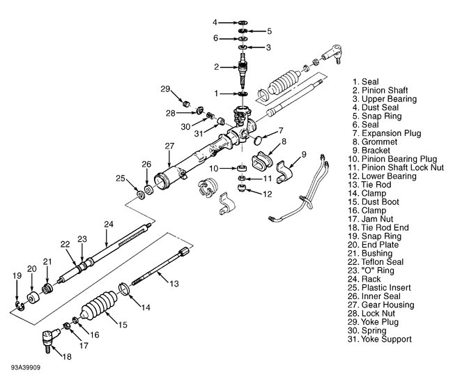

Power tube is leaking and has to be changed. Necessary steps without removing completely the rack and pinion?

Hello and thank you for using 2carpros.com. To begin, to access the hoses, chances are you will need to loosen and lower the rack. Access to the hose is extremely limited and requires the gear to be loosened. Note: You referred to the damaged component as the "power tube". I am basing my reply on that meaning the high pressure hose which runs between the pump and the rack. If that is incorrect, please feel free to let me know. Additionally, I have attached a picture of the entire assembly for you to use when in process. It should help guide and indicate part locations and names. These directions are quite extensive, but it is the proper way to remove the gear assembly. If you have additional questions, please feel free to ask.
Thanks,
Secure radiator and fan shroud assembly to upper radiator support, using mechanics wire.
Remove oil level indicator, three exhaust heat shield bolts, and cooling tube nut. Position cooling tube bracket aside. Remove exhaust heat shield stud and shield.
Remove two engine intake air resonator nuts and bolt, loosen hose clamp from inlet tube, disconnect Mass Air Flow (MAF) sensor, and remove intake air resonator.
Remove four nuts retaining Three Way Catalytic (TWC) converter to manifold.
CAUTION: Since struts must be moved to remove halfshafts, struts must be loosened to prevent damage to strut piston rod.
Loosen left and right front shock absorber upper mounting nuts, five turns counterclockwise.
Support engine with Three Bar Engine Support 014-00750 (or equivalent).
Raise vehicle on hoist.
Remove front wheel assemblies.
Remove nine radiator air deflector screws and deflector.
Remove four bolts retaining left and right lower radiator support brackets to front of subframe. Turn brackets forward.
Remove two screws retaining bumper cover braces to left and right sides of subframe. Rotate braces forward.
Remove the two bolts retaining A/C accumulator to subframe.
Disconnect steering oil cooler hose clamps at right subframe, remove hoses, and drain power steering system.
Remove nuts from outlet flange on TWC converter and remove gasket.
Disconnect EGR valve tube fitting from TWC converter. Disconnect the Heated Oxygen Sensor (HO2S) connector pushpin from right subframe and disconnect H02S connector.
Loosen clamp from TWC converter assembly. Remove bracket nuts and bracket. Remove TWC converter assembly from rubber exhaust hanger and remove assembly.
Remove nut retaining steering cooler lines to right front of subframe. Remove two bolts retaining cooler lines to the rear of subframe.
Remove steering gear pinch bolt.
Lower vehicle.
Remove right and left pinch bolts and nuts from front wheel knuckles at lower arms.
Using Tie Rod End Remover TOOL-3290-D, disconnect left and right tie rod ends from front wheel knuckles.
If equipped, remove the ABS wiring harness from stabilizer bar link stud. Remove left and right front stabilizer bar link nuts from front strut assemblies. Disconnect both front stabilizer bar links from front strut assemblies.
Raise vehicle.
Remove through bolts retaining left and right front engine support insulators to the subframe.
Position Powertrain Lift 014-00765 or equivalent with wood blocks approximately 1016 mm (40 inches) in length, secured to lift under subframe.
Remove four subframe-to-body bolts.
Allow subframe to lower slightly. Disconnect steering pressure and return hoses from steering gear. Gently pry the lower control arms from steering knuckles and steering gear coupler from steering gear. Lower and remove subframe.
NOTE: Mark location of insulator prior to removing insulator from subframe for reference during installation.
Remove two rear insulator bolts and insulator.
Remove four remaining steering gear cover bolts and cover.
Remove two steering gear bolts and steering gear.
