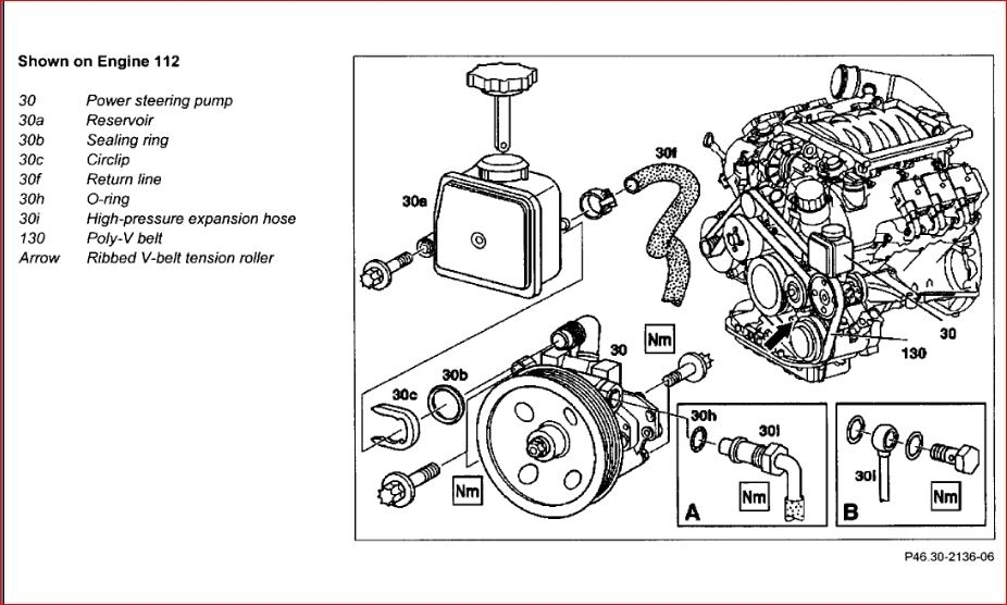

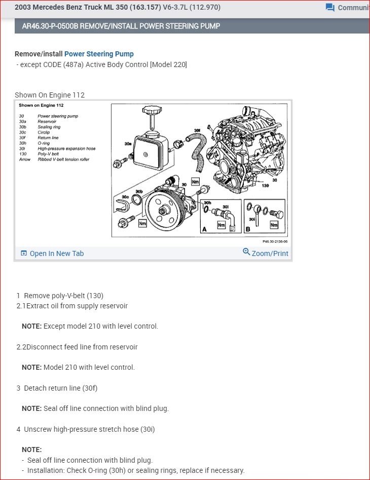

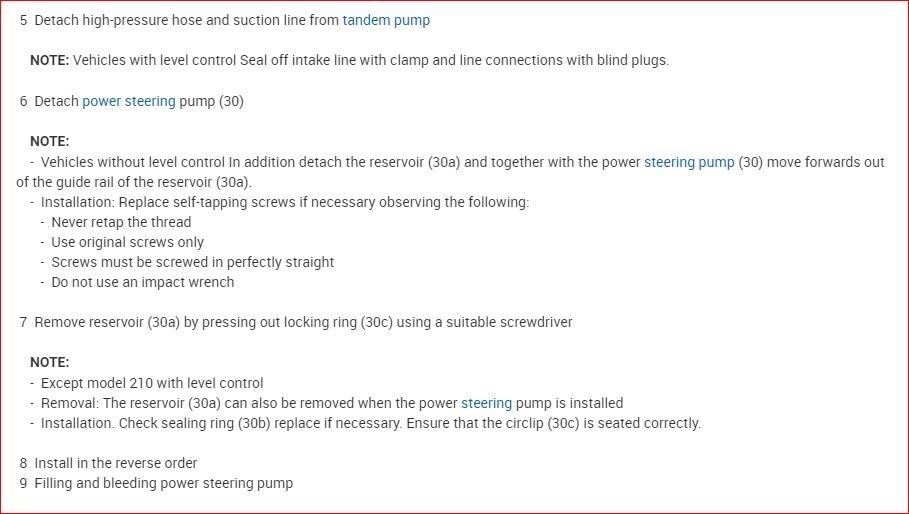

I watched your video on power steering pump repair on a ml350 and checked your website. A tool list accompanying a how to is very helpful. You showed tools but not sizes. And sometimes only specific tools will work ie snapon wrenches because of the thin design, etc. Would it be possible to get specifics?
Jun 18, 2019 at 8:36 PM
Hi J Manuell,
Here is the actual procedure on how to replace it. Unfortunately, we don't have a list of wrench sizes and other hand tool sizes. This is something that techs find out while doing the repair. I understand the desire to have it all laid out but unfortunately they don't invest the extra time and money it would take to label every bolt size and best tools to use for each and every repair.
Please let me know if you have other questions. Sorry we couldn't provide the exact detail that you are looking for.
