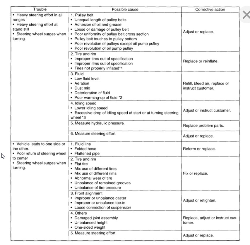

Installed new power steering pump, filled reservoir, moved steering wheel all the way right and left numerous times, checked fluid level, still no power steering.
How do I know if the new pump is bad? Thanks for your help!

This could be a power steering pump issue but what was the issue from the start? Did changing the pump change it all?
We will need to check the pressure coming out of the pump but I am thinking you have an issue with the steering rack.

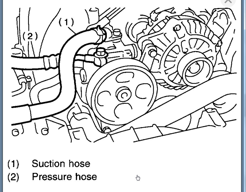

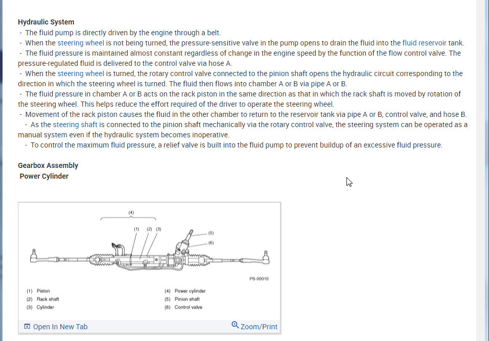

I attached the info below on how it works. Basically the pump is always generating pressure and when you turn the wheel the pressure is directed to that side of the rack to assist with steering.
So I would lift the front wheels and then route the pressure hose into a bucket and turn the wheels when you have the engine running. Clearly you will need to make sure the reservoir stays full but you only need to run it for a second or two just to find out that there is pressure.
Then I would replace the pump or rack depending on the results.
https://youtu.be/C1h8Xl1E8hI
If there is not much pressure, the pump is faulty. If there is pressure then you need to replace the rack.
Let us know if you have questions. Thanks

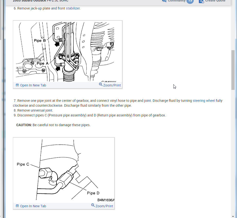

So, the pump is working fine, lots of pressure.
There is still no steering though.
Is it a major fix to replace the rack?
I'm afraid it is and probably more than a backyard mechanic
could handle.
Thank you for your knowledge.
May 10, 2021 at 8:56 AM

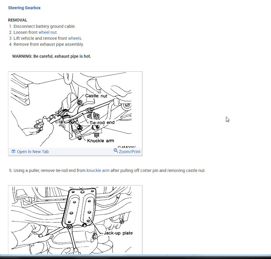

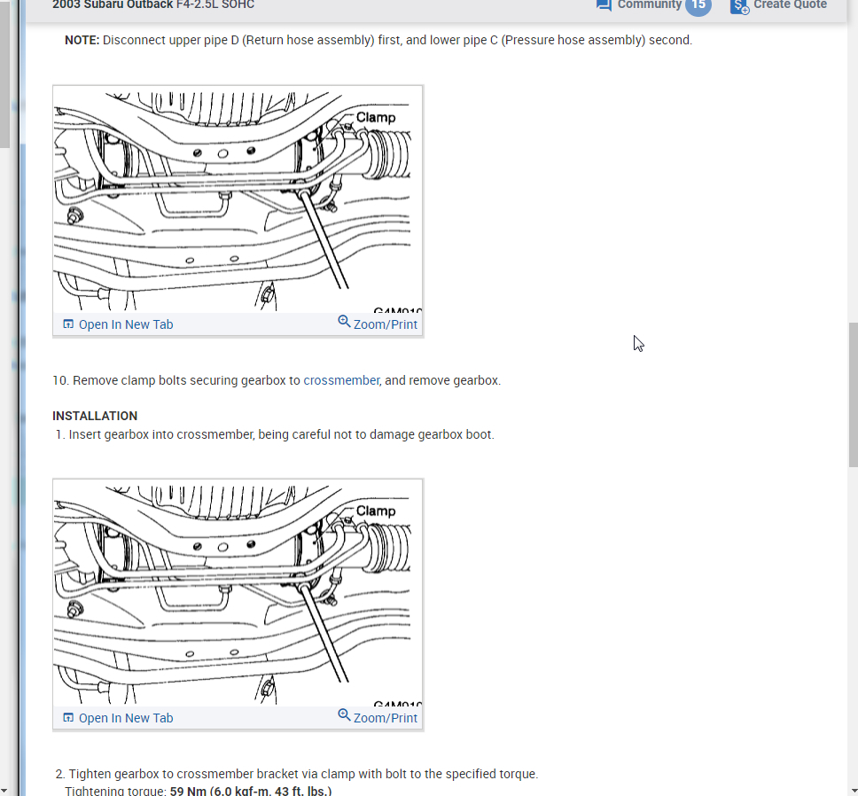

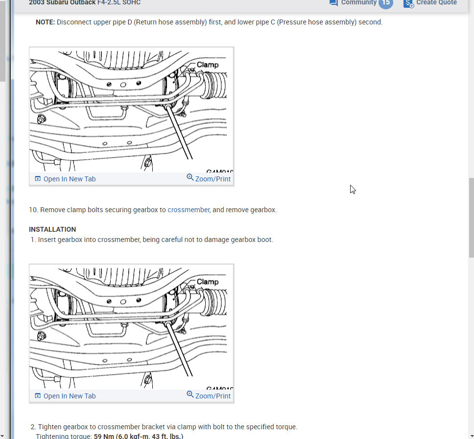

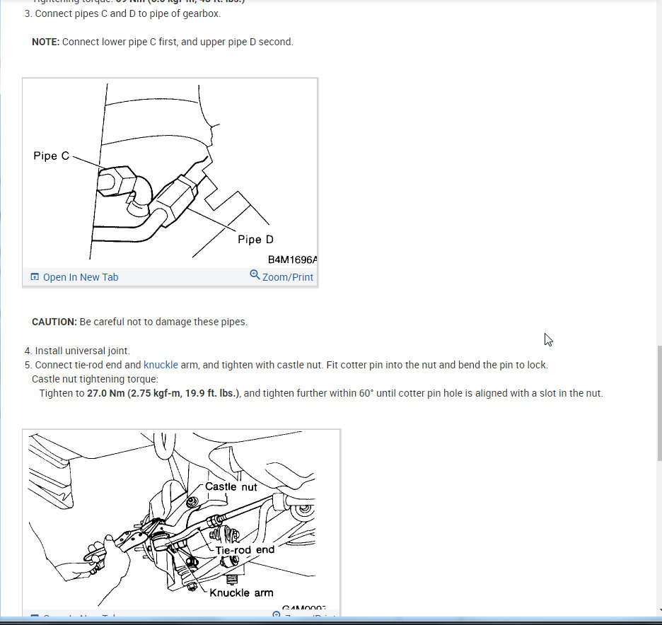

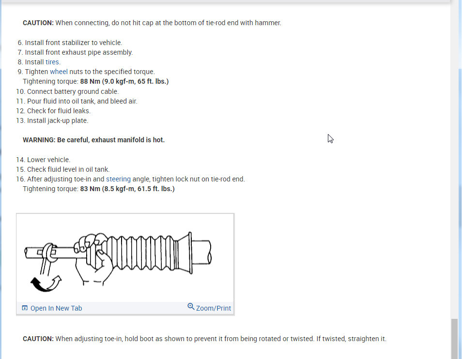

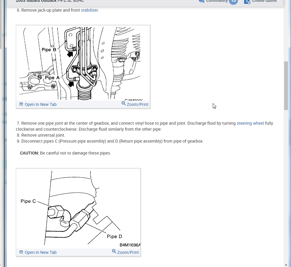

It is not that bad but you will need an alignment afterwards.
Here is the process from the manual that will help with this.
Take a look at this and let us know if you have questions.
