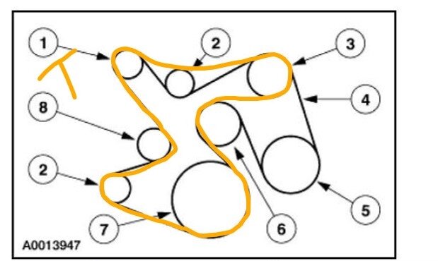

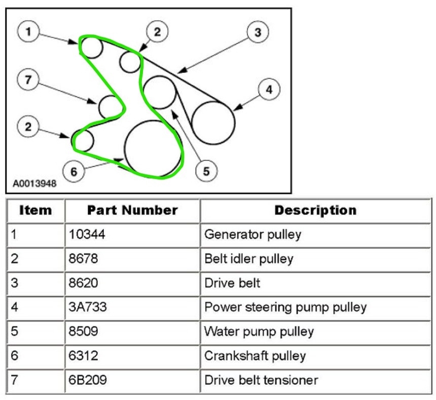

I'm stuck on the side of the road with my 2000 Econoline e-150 with a 4.2 l V6. my power steering pump pulley sheared off. I'm trying to find out what size belt I would need to bypass my power steering pump to get me home.
Feb 7, 2025 at 7:42 AM
STEVE W.
  • 15,295 POSTS

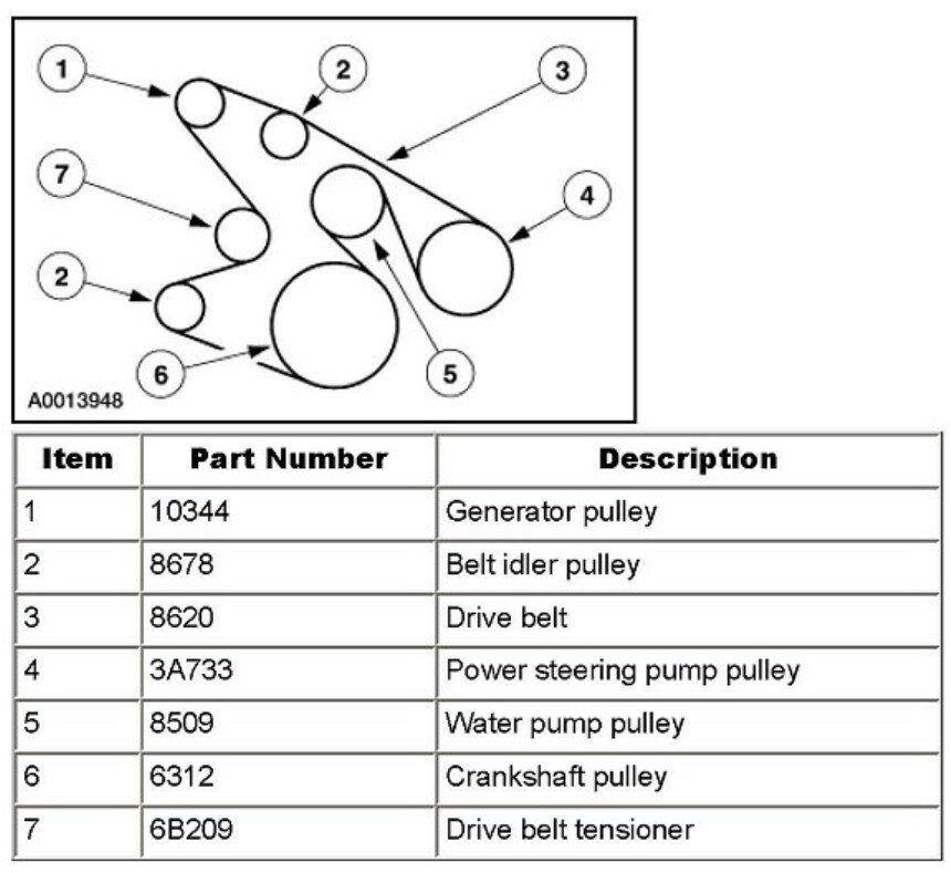

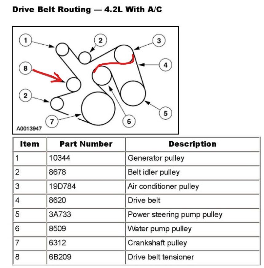

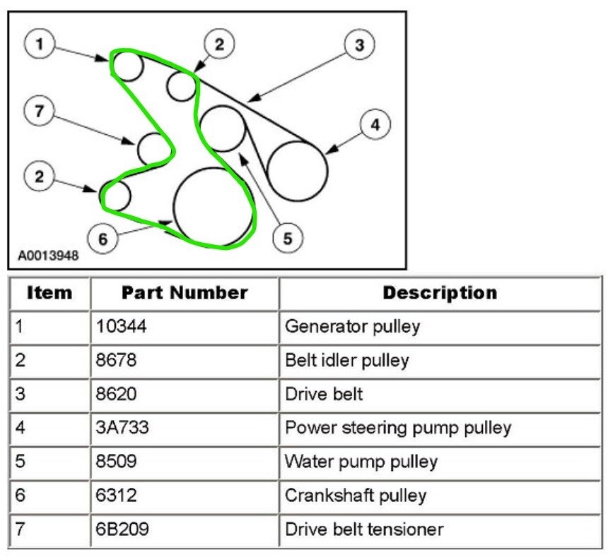

They didn't install that engine in an application that didn't have PS so there is no real number to go by. What I would do is take the old belt. Cut it. Then wrap it around the pullies like the yellow line in the second pic. Mark that length. Take that to the parts store. and get a belt as close to that length as possible. The idea is that running it on the idler should make it short enough that when you route it like the first image with the red bypassing the PS pump, the tensioner #8 will hold it tight enough that it will work.
The OE belt is a 6 rib 103-inch belt. I suspect you will be closer to an 86–88-inch belt but never measured the run around the PS pump. Now this is for one with AC. Without AC (image 3) you will probably have to route the belt like image 4. However, that is going to cause far less drive to the water pump so you will want to keep a close eye on the coolant temperature. For it you would still do the cut and measure, but you will want to move the tensioner out so that you get a belt that will stay tight when it moves back into place.
Feb 8, 2025 at 2:04 AM
JULIENT94
Thank you so much. What I ended up doing was scouring the web and I found a guy who had a 2003 Ford f150 with a 4.2l V6 and he had the same thing happen and he used a 90.5-inch belt so that's what I did, and it worked. My question is now will I damage anything by driving this huge van with no power steering?
