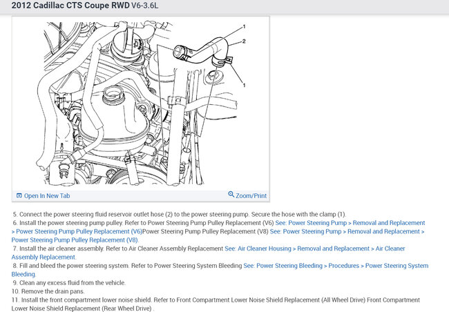

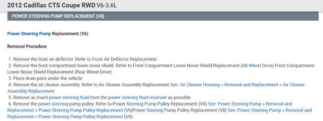

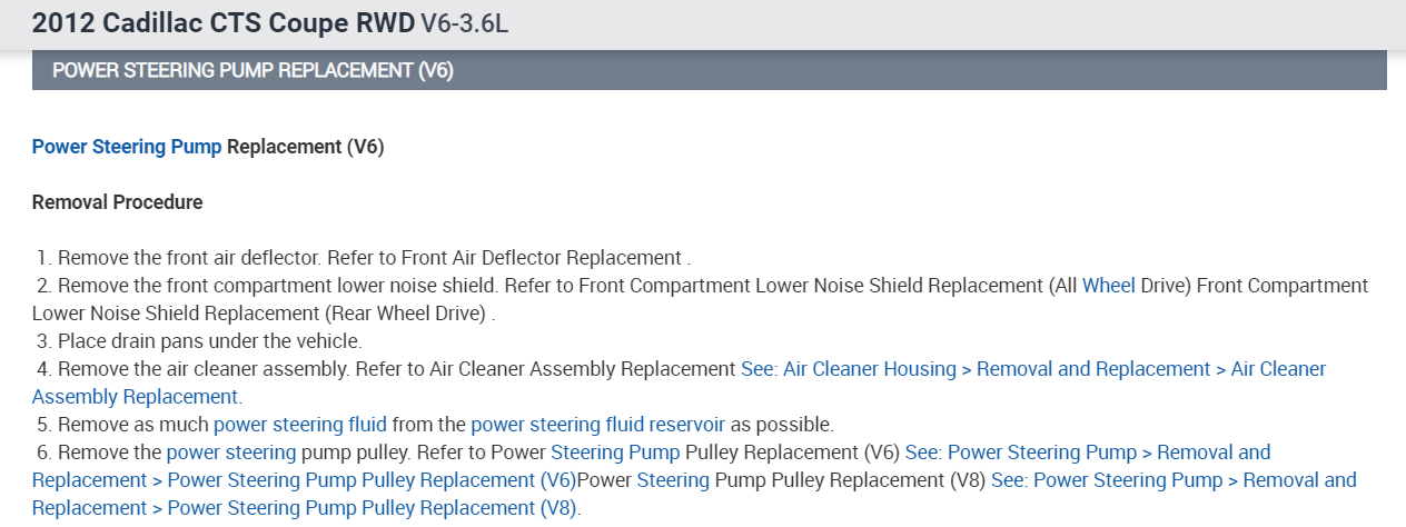

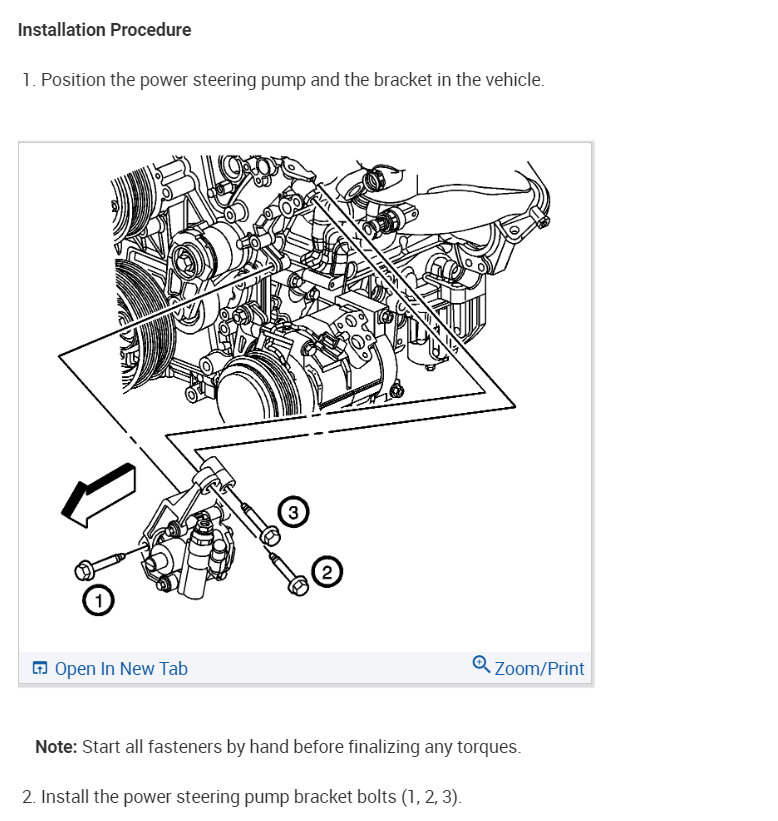

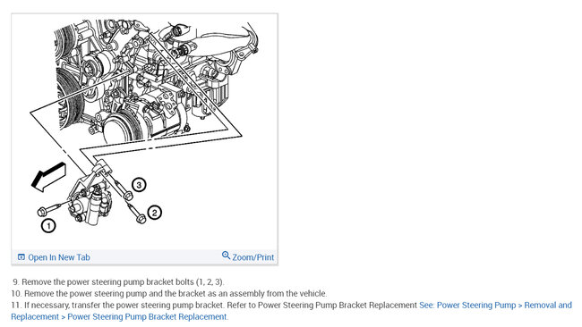

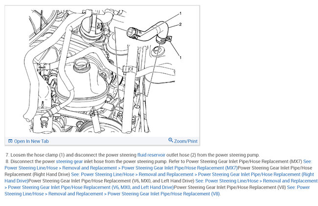

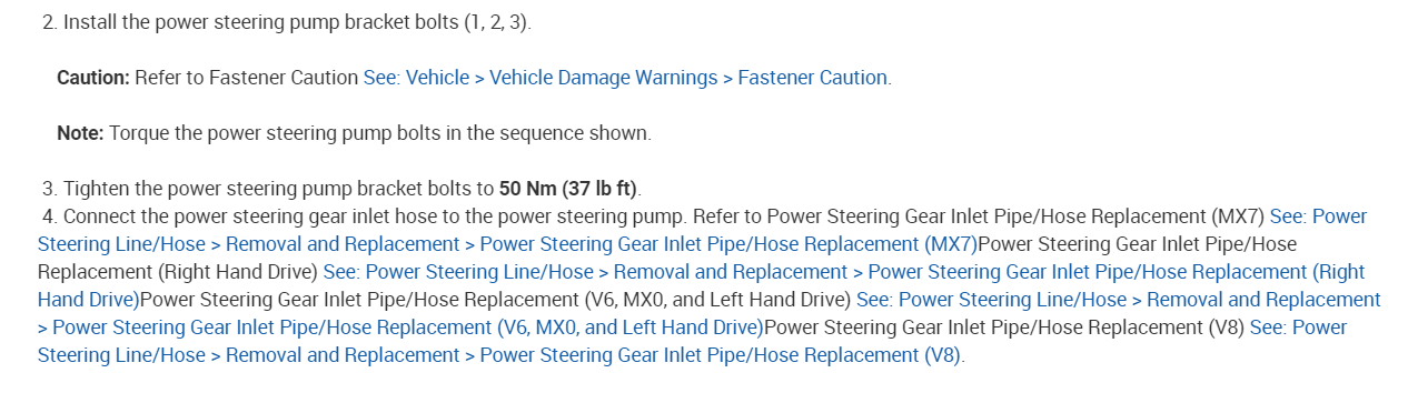

9 times out of 10 it will be the power steering pump. Here is how to replace the pump in the images below.
This guide can help as well:
https://www.2carpros.com/articles/power-steering-problems
