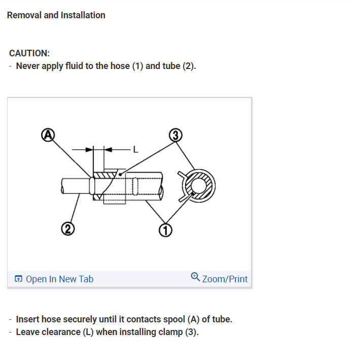

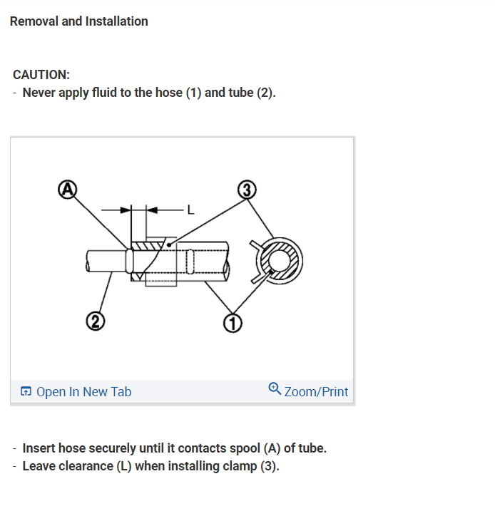

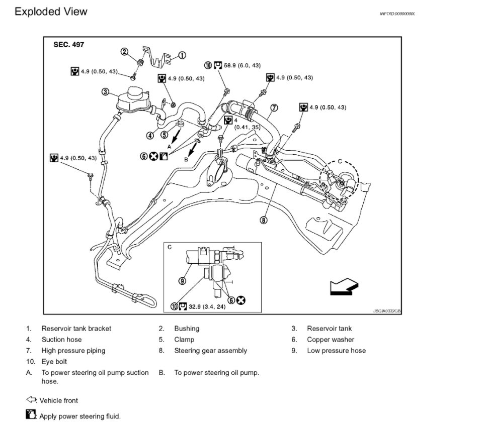

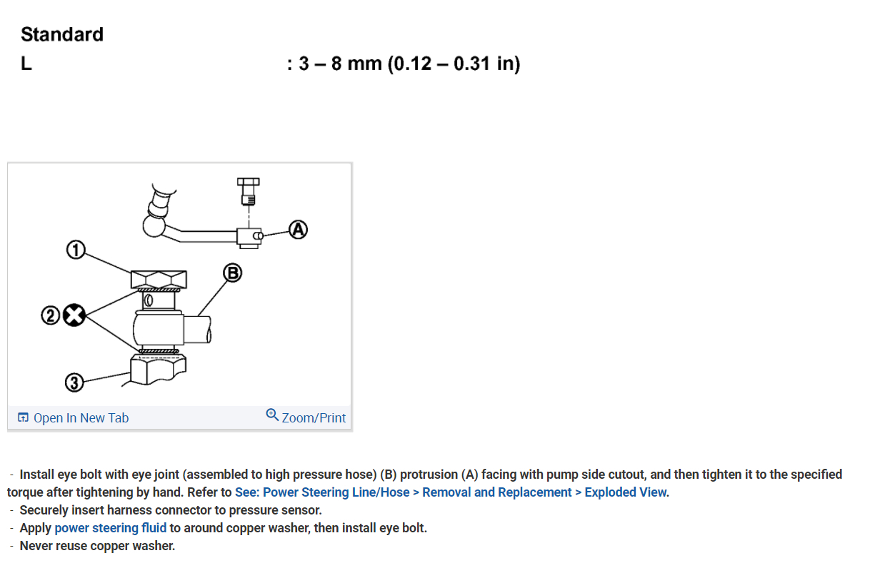

It sounds like the high side hose is leaking. to but sure can you please shoot a quick video with your phone so we can see what's going on? that would be great. You can upload it here with your response. Here is how to change out the hose in the diagrams below. This video shows the job being done on a similar car but the process is the same:

So far I have managed to disconnect and drain the reservoir and feeder hose the drive belt i removed the cotter pin from the tie rod but can't get it out the knuckle itself and found that the boots on the rack are no longer connected at the rack. my haynes repair manual tbh is useless when it comes to details or step by step instructions on how or in what order to remove parts in order to remove the rack. as for puddles they are mainly under the area where the pumps located but I will attempt to video the situation shortly. I was given some pics of the hose diagram to the power steering but it was confusing and i'm unable to clock the links given in the diagrams. so i'm a bit frustrated and lost at this point. please help

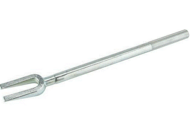

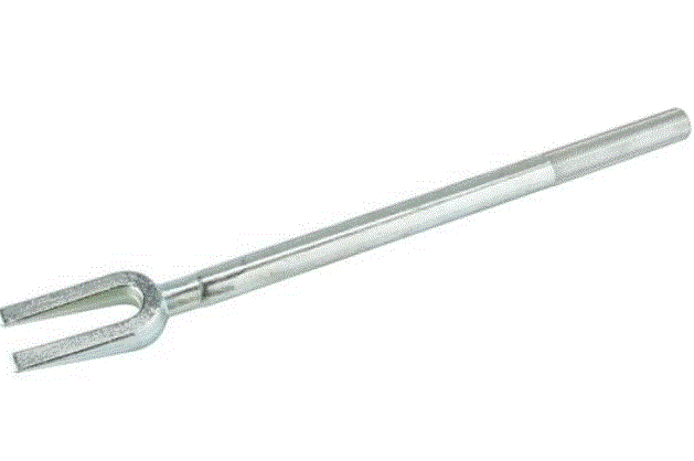

I'll help you through this. First, the tie rods have a castle nut which the cotter pin goes through. Once the cotter pin and castle nut is removed, you will need a pry bar and a hammer. The easiest thing I can show you is the following link. It is for replacing the tie rod, which I don't think you are, but it shows how to disconnect it from the steering knuckle.
https://www.2carpros.com/articles/tie-rod-end-replacement
Also, if you look at the attached picture, it is what is called a pickle fork. Ugh! I call them a tie-rod fork. You can see how it's tapered. Carefully slide it between the tie rod and the knuckle and as you hammer it in, it will release the tie-rod. This is an option. Most parts stores will lend one to you.
