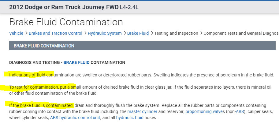

It wasn't much; however, I did start the car (it's a push start so I had to press the brake) I realized immediately what I did. I turned the car off and proceeded to suck all the fluid from the reservoir, added more brake fluid and after that drove it home about 15 miles. I pulled much of the fluid off but unsure if it made it down the lines, should I take it in the shop and have the brakes drained? I have seen horror stories here and I'm getting a bit paranoid.

I attached the directions from my manual for checking. See pic below.
Let me know if you have other questions
See pic below.

Many of those stories are from me. Every year I did a demonstration for my students where I started with two beakers partially filled with clean, fresh brake fluid, and I dropped in a new wheel cylinder lip seal into each one. In one beaker I added one drop of engine oil or power steering fluid. One week later, the contaminated seal had grown by about 20 percent and was mushy and slimy.
My concern gets pretty harsh, but since you sucked the contaminant out right away, there's a really good chance the system can be saved. Even though you pumped the brake pedal a few times, the contamination didn't go far down the lines. The fluid only goes a few inches, then it returns when you release the brake pedal. What I'd suggest you avoid now is any type of bleeding or flushing at the wheels. That IS going to make any remaining contamination go down all the way.
A better solution is to suck all the fluid out of the reservoir, then remove the two front wheels. Use a large flat blade screwdriver to pry the piston back into one caliper housing. That's the same thing we have to do when installing new, thicker brake pads. The caliper doesn't have to be removed to do this. Doing so will push all the brake fluid behind the piston back up into the reservoir. Depending on how worn the front pads are, that could fill the reservoir anywhere from just a little to well over quarter full. Now suck that fluid out. If there's any power steering fluid still present, it will all be in the reservoir now.
Repeat this with the piston in the other front caliper. Use a clean rag to wipe out the reservoir as well as possible. If you are able to remove it, the better approach is to wash it out with Brake Parts Cleaner in a spray can. Let it dry for a few minutes, then pop it back on and refill it. Be aware most reservoirs are rather difficult to remove. They have a pair of tubes that extend out the bottom and plug into rubber grommets. They go together a whole lot easier than they come apart.
