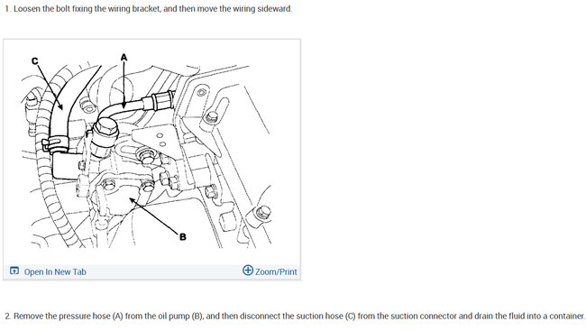

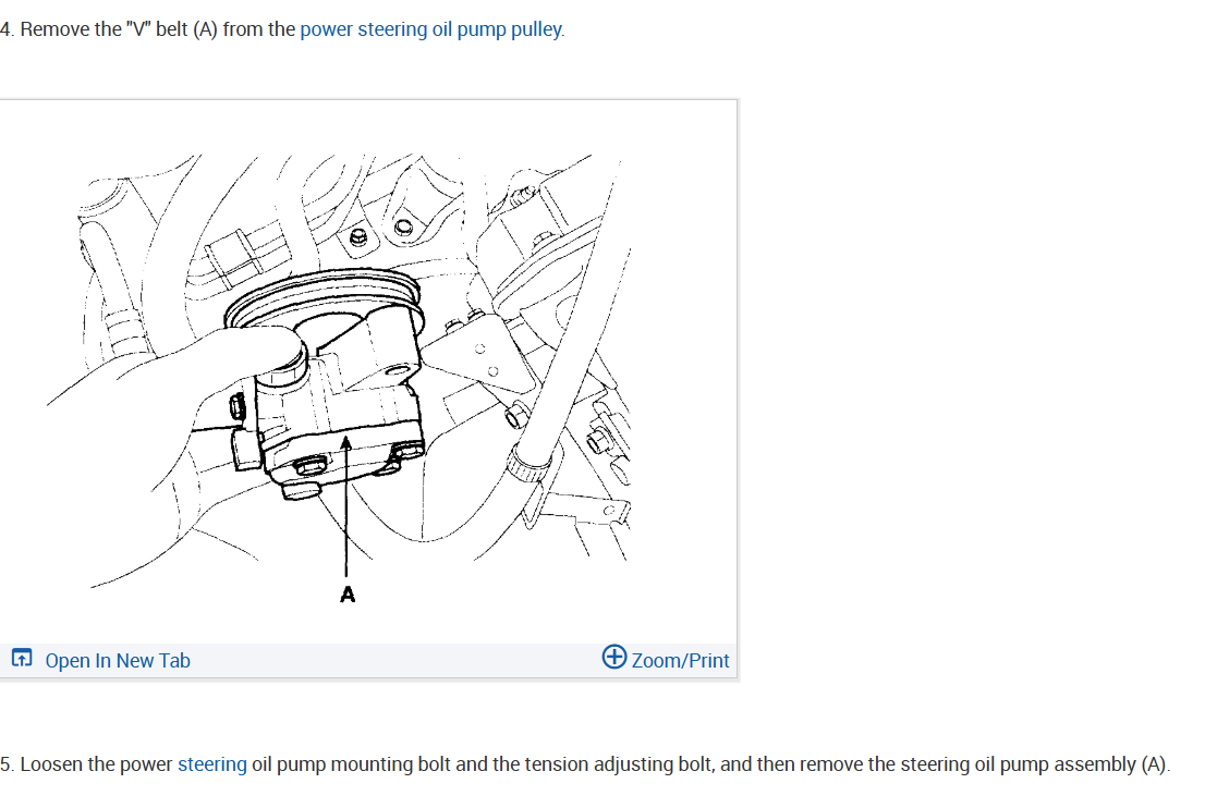

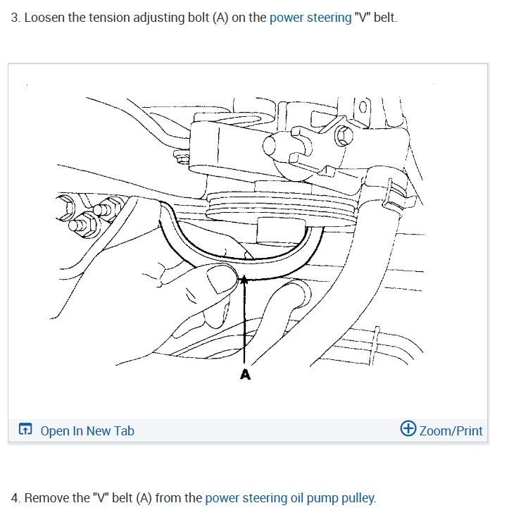

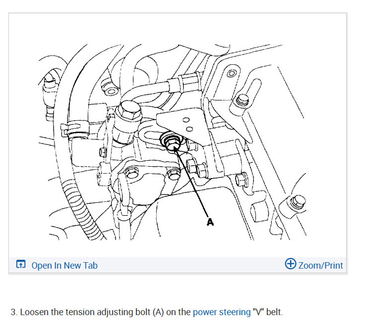

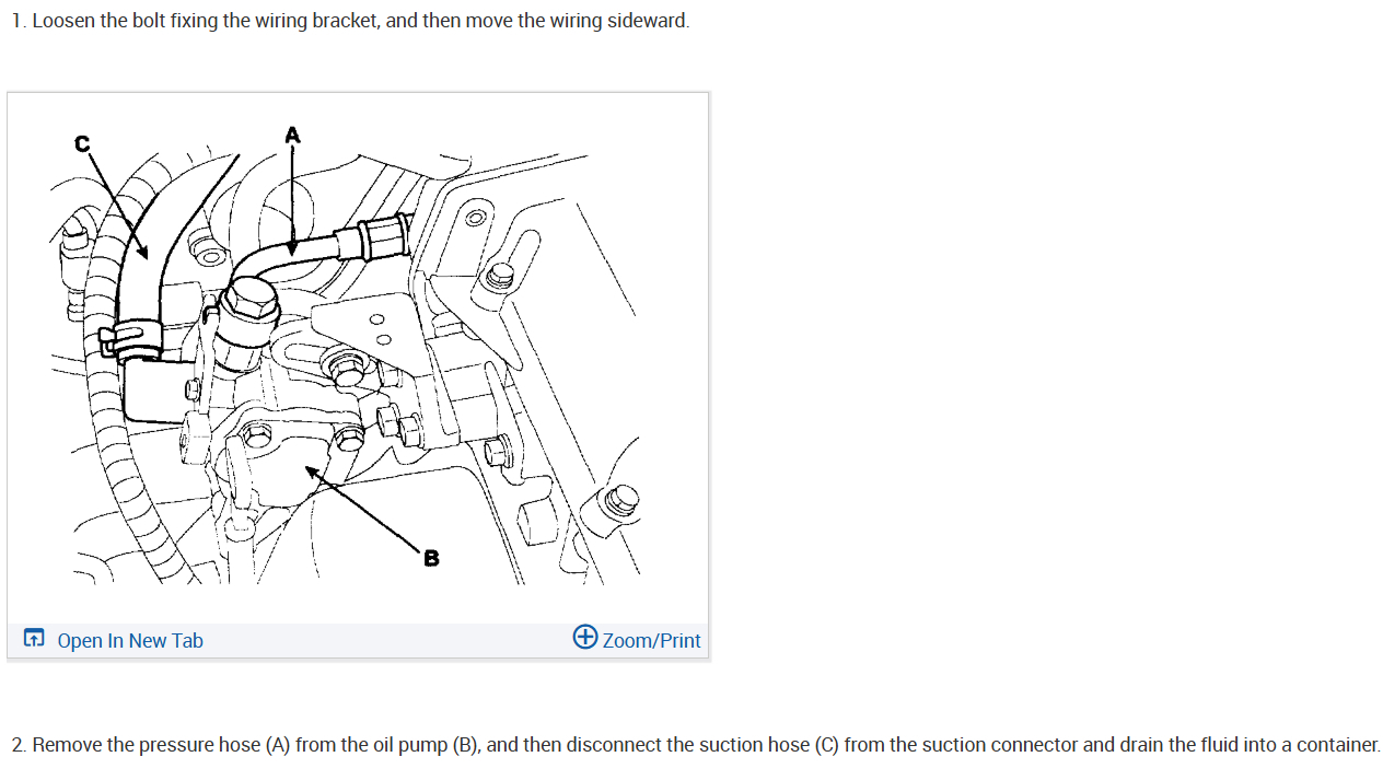

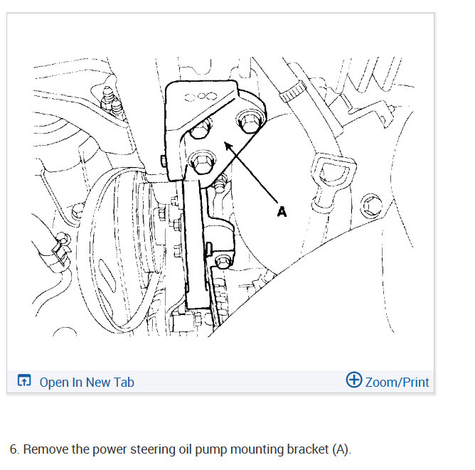

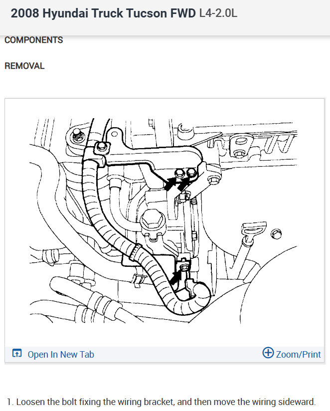

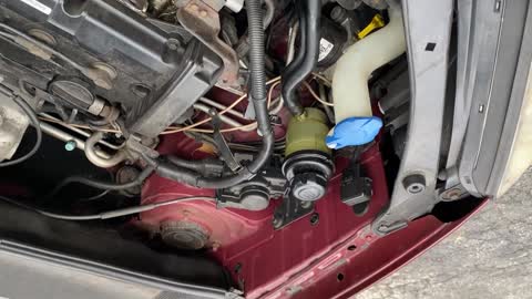

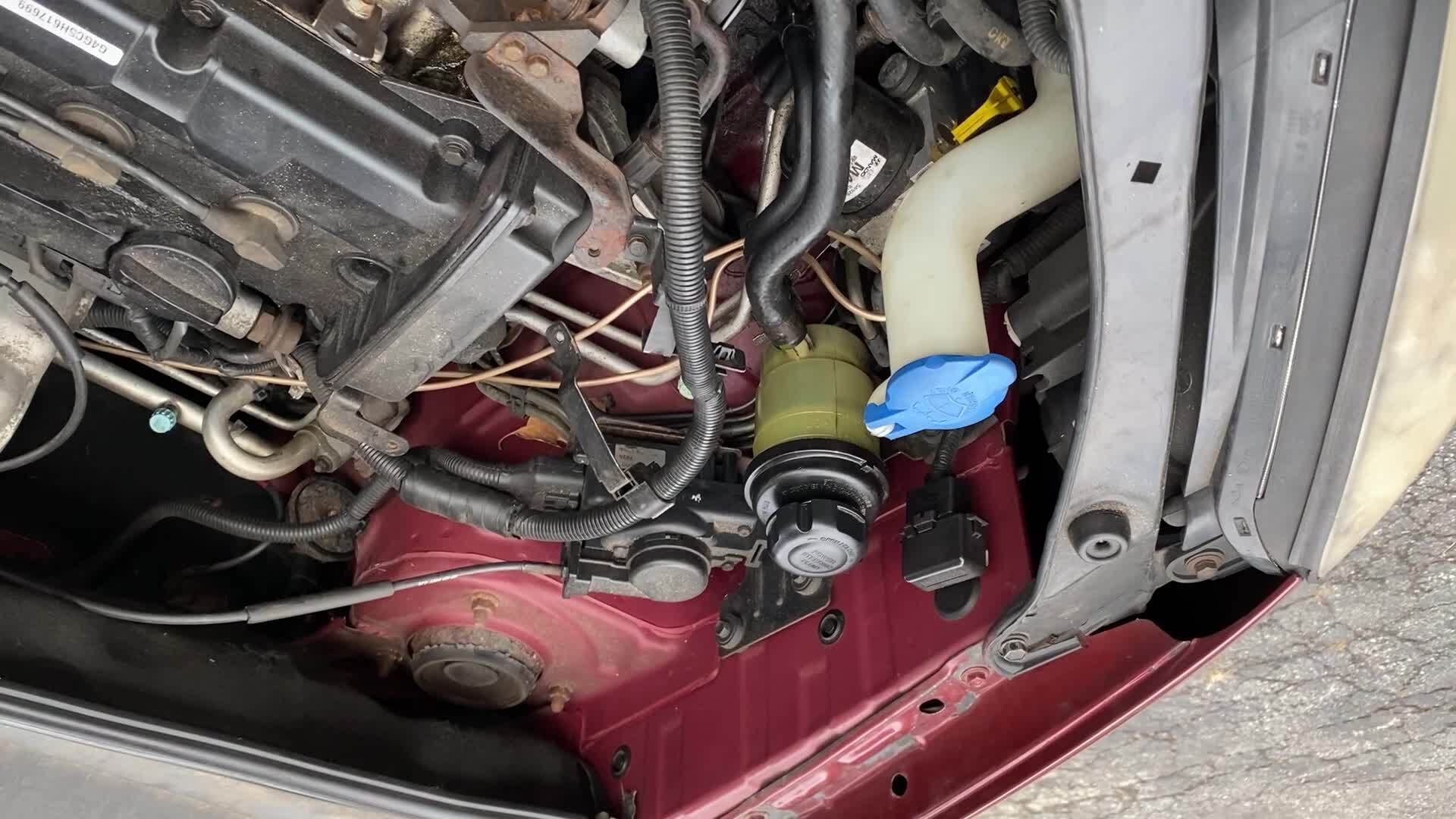

I’ve had an issue with keeping power steering fluid in the reservoir. At one point it also looked like foam was in it. The power steering fluid was coming out very rapidly. It would be gone in about 10 minutes. As of recently, it’s very hard to turn so I decided to watch and see if it came out quickly and from where, soon as I put it in and turned on the vehicle and turned the wheel a little bit, I seen that it just go down very fast. I then looked underneath the vehicle because I didn’t see any leaks from the view of the hood, I looked underneath the car and I see that it was spewing out very fast. I didn’t know how to explain it because it wasn’t like I seen a leak in the reservoir or any holes from the top view of the Vehicle so I would hope that someone can watch this video and help with diagnosing it whether it’s a line or the pump.

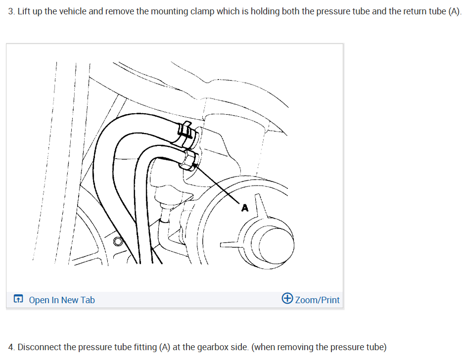

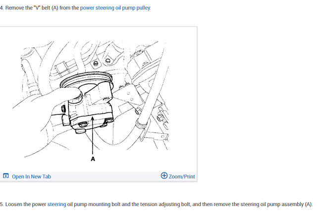

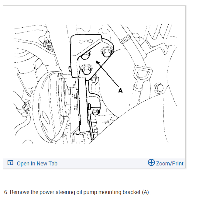

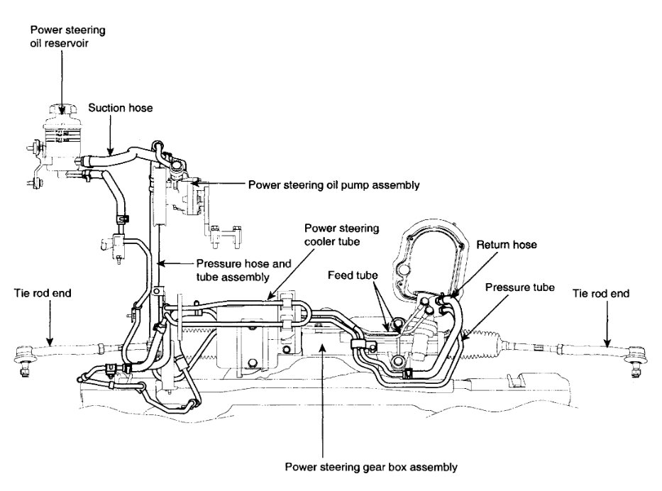

Please watch the video you uploaded; I can see what you are trying to show? Typically leaks like this can be either the front pump seal or the main pressure hose.
Dec 4, 2024 at 3:18 AM
RWARREN35
Is it expensive to change both?
Dec 4, 2024 at 4:15 AM
  • 55,423 POSTS
No it is not too bad, most people replace both anyway, here is how the job is done. Check out the images (below). Let us know how it goes.
