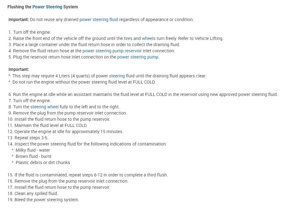

Good morning,
Yes, the first thing I would do is flush the system. There could be dirt or debris in the passages that cause this. I attached the procedure below for you to view.
https://www.2carpros.com/articles/power-steering-fluid-flush
Keep us updated with the result.
