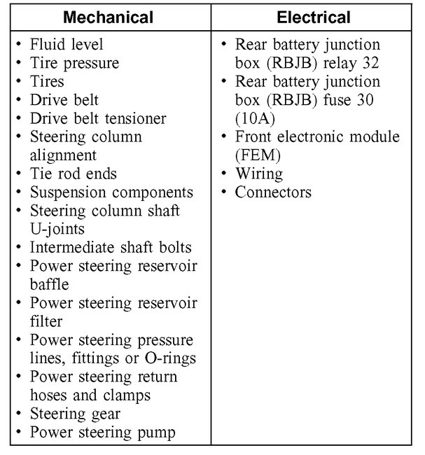

Your vehicle has variable assist power steering. Based on your description, it sounds like you are getting some assist, but not the full assist that should be there when under two mph.
Here is a definition of the system which explains how it works. Additionally, I attached directions for checking the system to find the problem. However, the test requires specialized tooling. Regardless, I attached it in case you have the tools and want to give it a try. All attached pictures correlate with these directions.

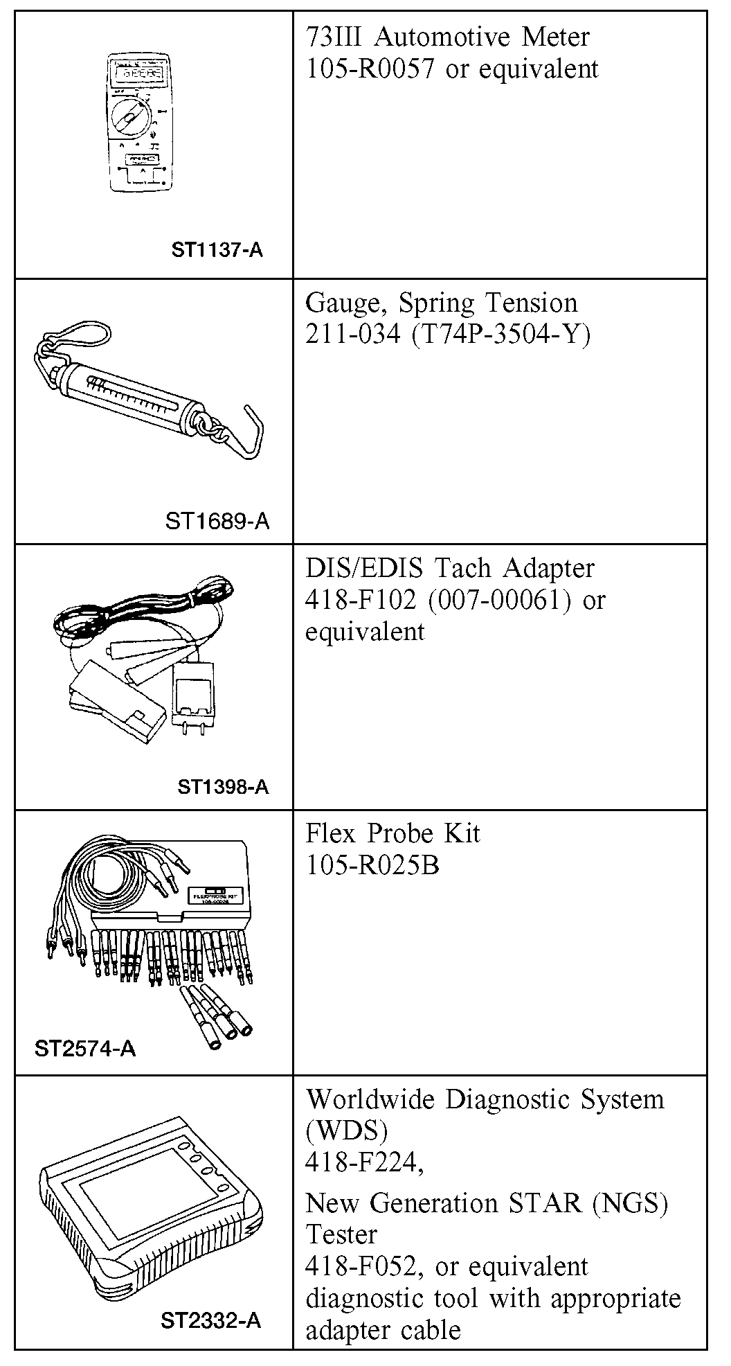

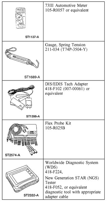

Special Tool(s)

Visual Inspection Chart

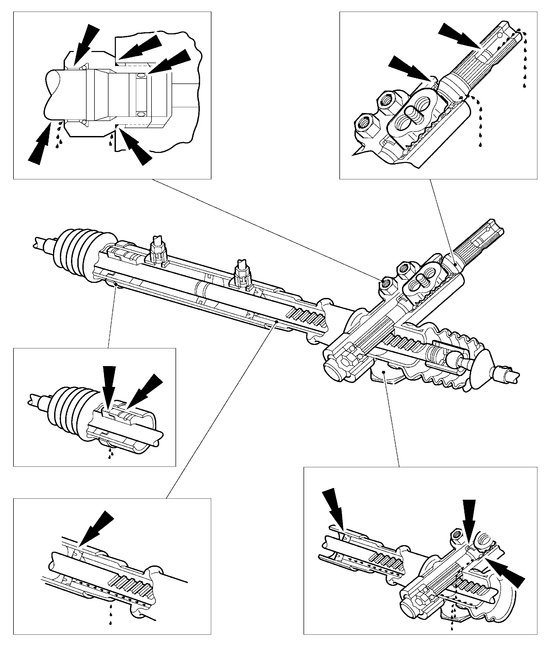

4. Check the power steering system for fluid leaks.

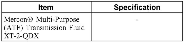

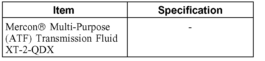

NOTE: It may be necessary to add power steering fluid to achieve the correct level.

NOTE: To inspect for leaks it may be necessary to remove the squeeze-type clamp from the steering gear boots.
6. Inspect the power steering gear for leaks. If a leak is detected at the power steering gear, install a new power steering gear.

8. If the concern remains after the inspection, connect the diagnostic tool to the Data Link Connector (DLC) located beneath the instrument panel, and select the vehicle to be tested from the diagnostic tool menu. If the diagnostic tool does not communicate with the vehicle:
