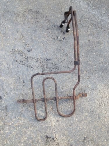

As an addition, one popular leak on the steering system is the power steering cooler. It is mounted in front of the radiator and is nothing but a S-bend piece of tubing, they rust through and leak, usually at the bends where they go through the radiator support. If that is the case and you do not run it off road a lot you can just bypass the cooler.
