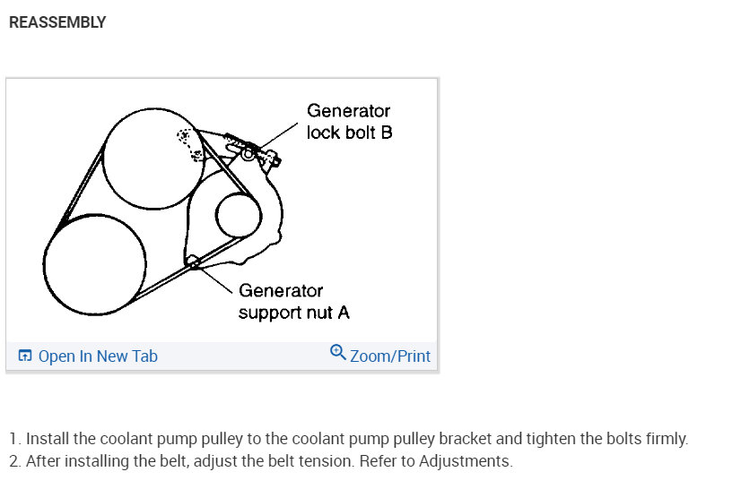

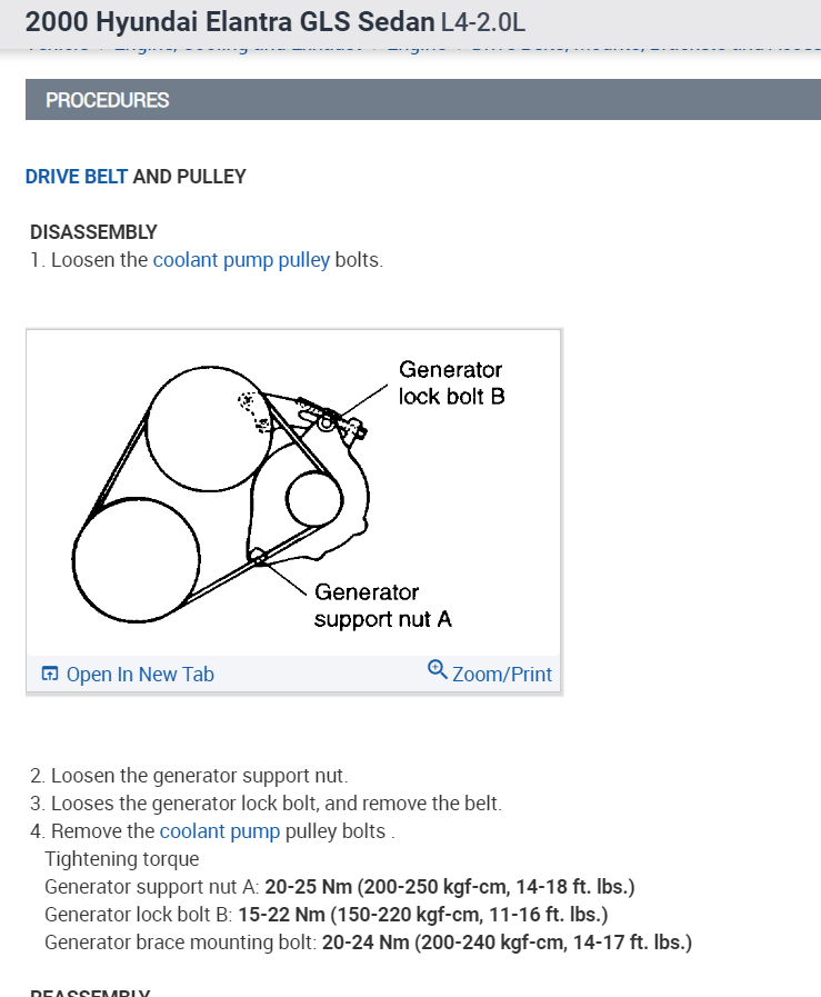

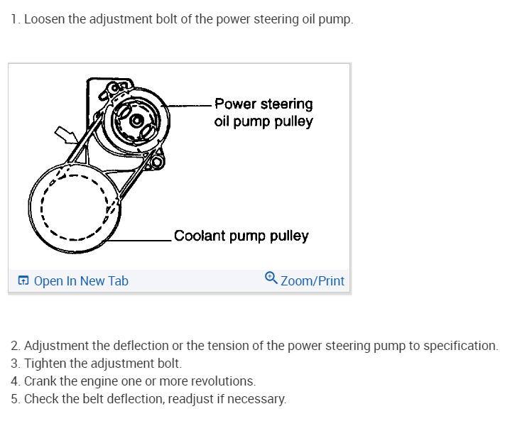

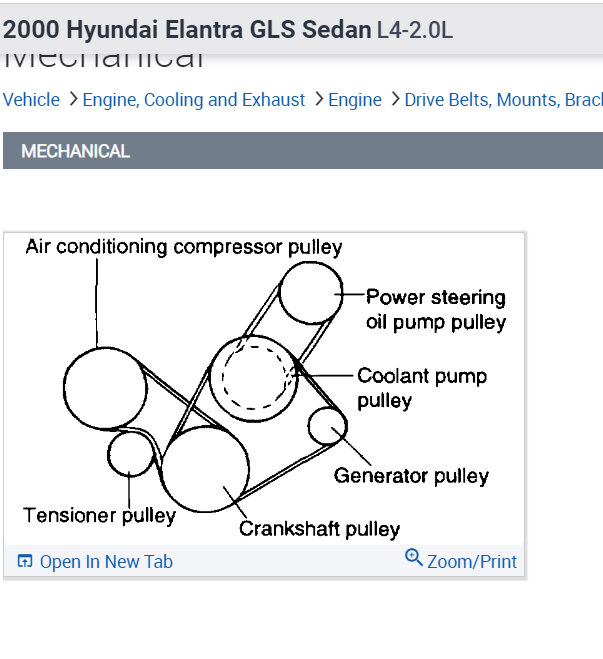

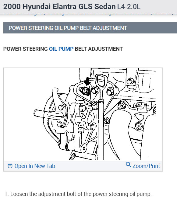

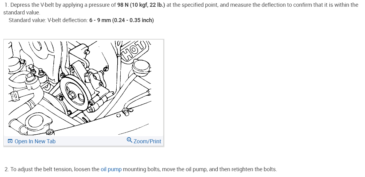

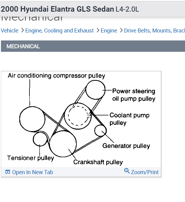

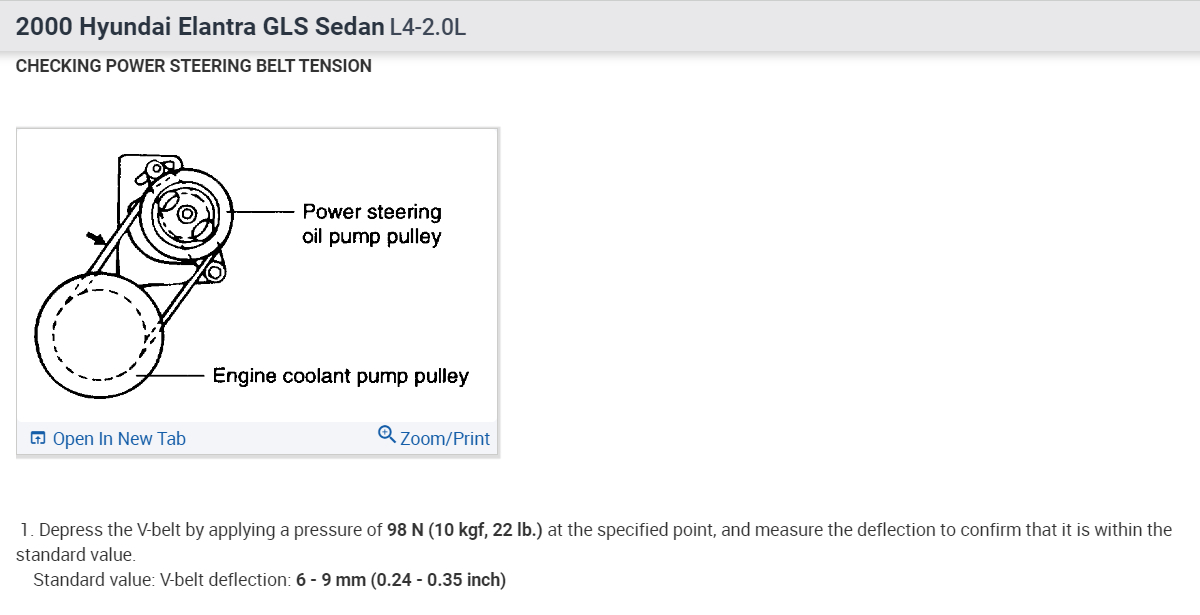

I just purchased the vehicle and I know it needs some TLC saw that the power steering belt is gone hence the stiffness on the steering wheel. If you can send me the steps and torque specs for installing the power steering belt, thank you.
Aug 17, 2023 at 11:26 PM
  • 55,456 POSTS
Here are the steps and torque specs for installing the power steering belt. Check out the images (below). Please let us know if you need anything else to get the problem fixed.
