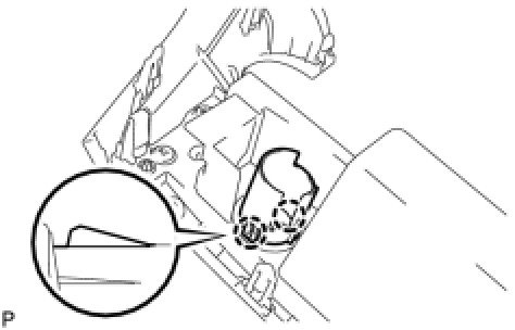

You will need to remove the center console finish to remove and replace the cover assembly. I have attached the directions for removal first. The second set of directions refer to the cover and power outlet. All attached pictures correlate with these directions.
__________________________
28. REMOVE UPPER CONSOLE PANEL SUB-ASSEMBLY
(a)Disengage the 4 claws and 4 clips.
pic 1
(b)Disconnect the connector and remove the upper console panel sub-assembly.

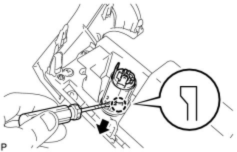

3. REMOVE POWER POINT SOCKET ASSEMBLY
(a)Disengage the claw and remove the power point socket assembly.
pic 2

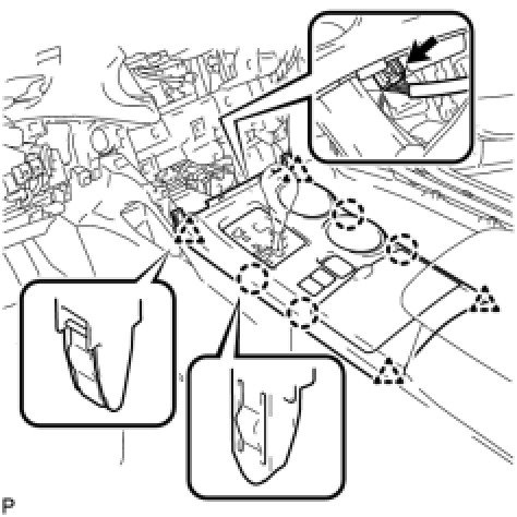

4. REMOVE POWER OUTLET SOCKET COVER
(a)Disengage the 2 claws and remove the power outlet socket cover.
pic 3

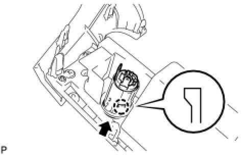

1. INSTALL POWER OUTLET SOCKET COVER
(a)Engage the 2 claws and install the power outlet socket cover.
pic 4
