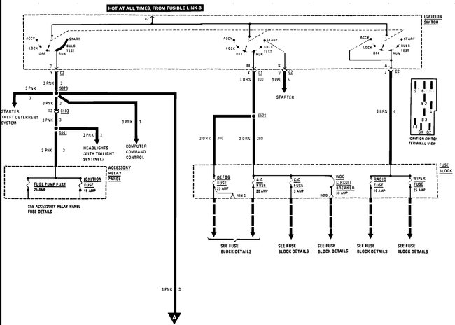

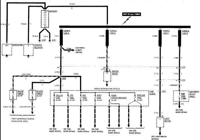

Next get a simple test light. Connect it between the battery positive terminal and the positive cable. With a draw it will light up. Now start removing fuses one at a time starting with the lower amperage ones first.
Pull a fuse and look at the light, is it still on or did it go out?

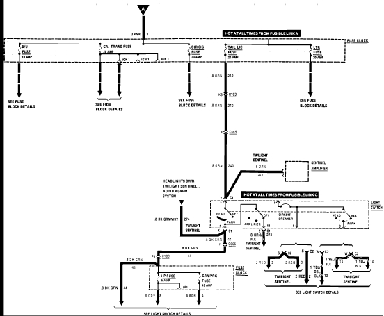

You will find that one or two fuses (some circuits use a fuse powered from a larger fuse) turn out the light. Then you can look at that circuit to find the problem. Many fuses will only have one label, but they may actually power multiple circuits. For instance the GA/transmission fuse, it actually powers eight different circuits, so if you pulled that fuse and the light goes out, you then need to test each of those branch circuits to find the drain.
