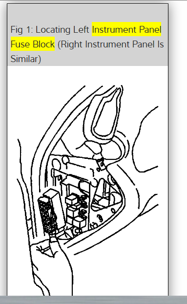

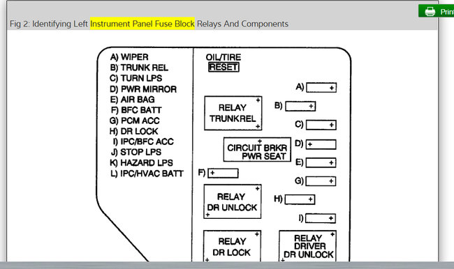

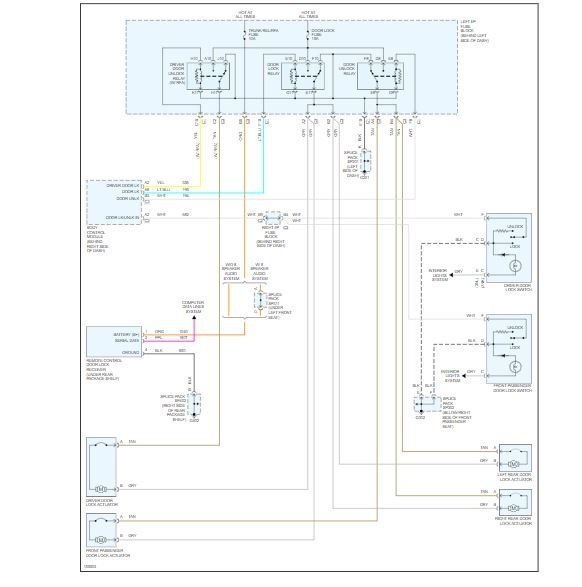

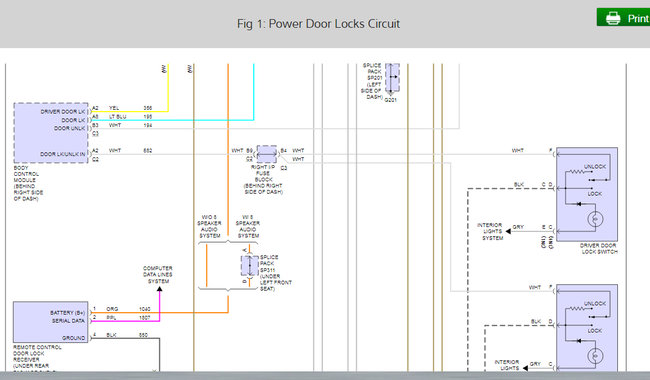

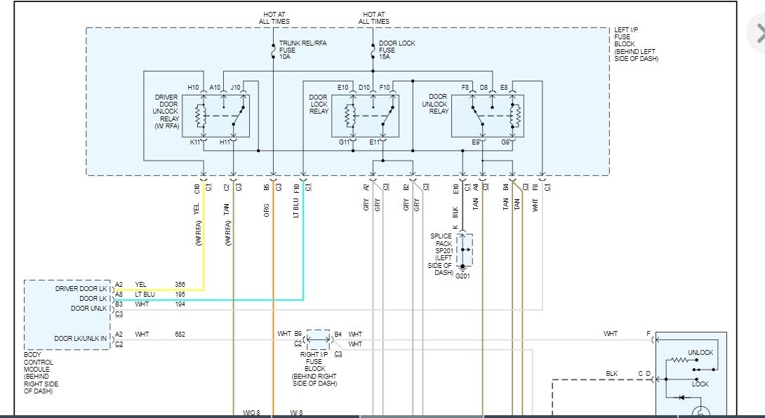

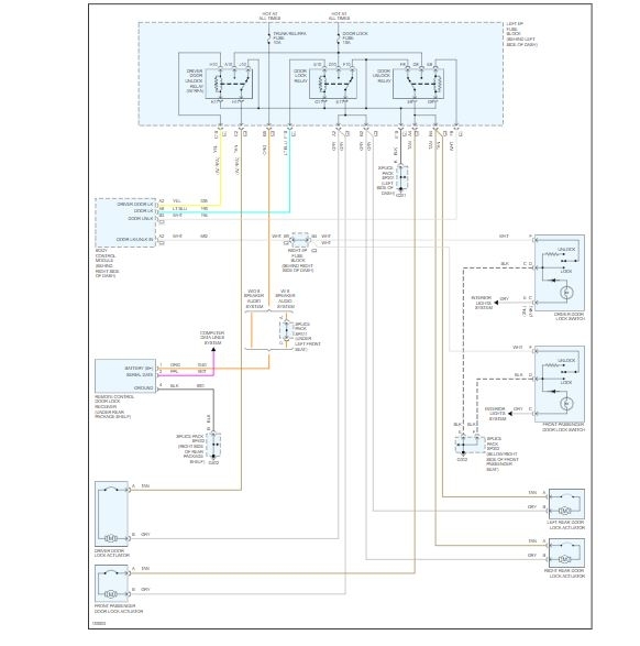

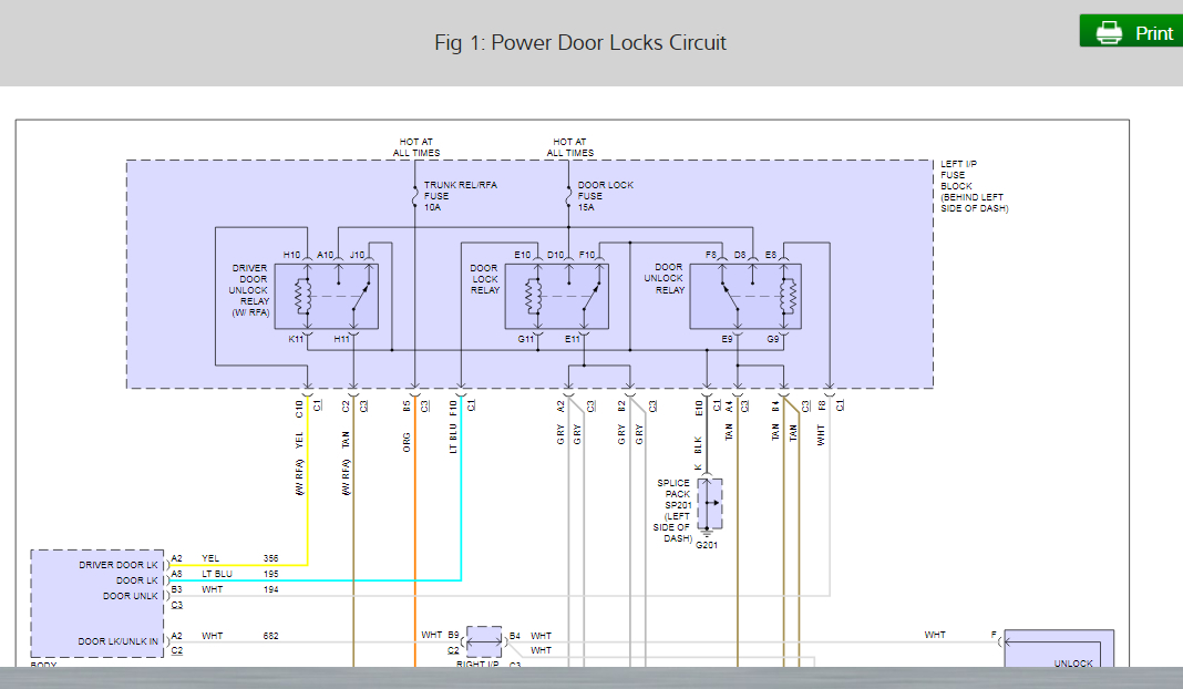

Where is the location of door lock relay?
Apr 25, 2019 at 6:07 AM
Good afternoon,

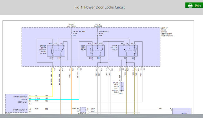

The relay is on the fuse panel in the car. I attached a wiring diagram for you to view with the location.
Apr 25, 2019 at 6:21 AM
SCGRANTURISMO
  • 4,897 POSTS

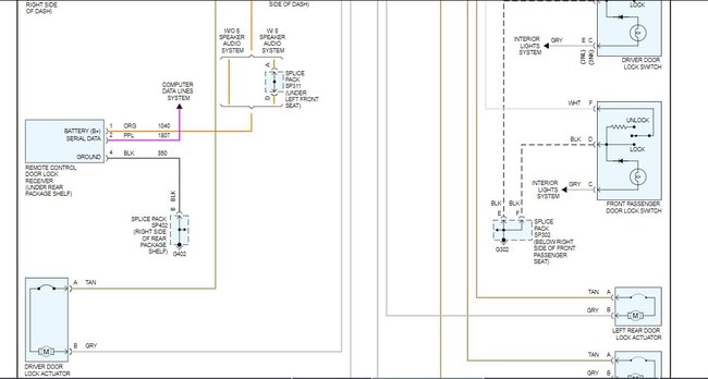

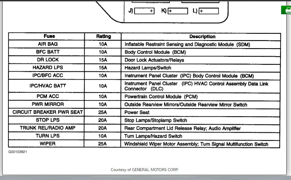

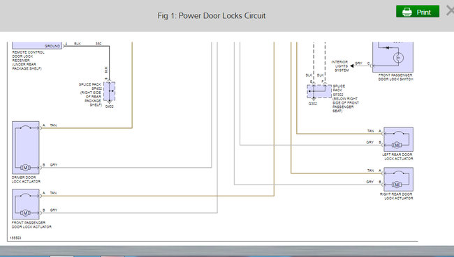

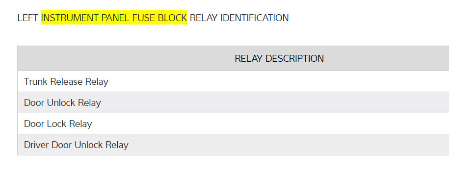

They are located in the left side instrument panel fuse block located, you guessed it, on the left side of the instrument panel. I have included wiring diagrams for the door lock circuit and location and a detailed description of the fuse panel in the diagrams down below. Please, if you have any other car related questions, feel free to ask. It's why we are here.
