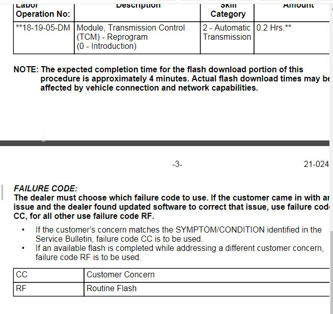

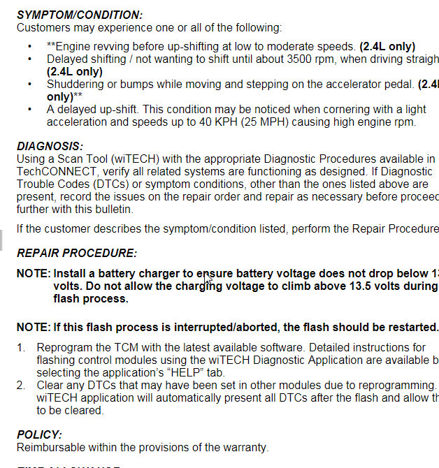

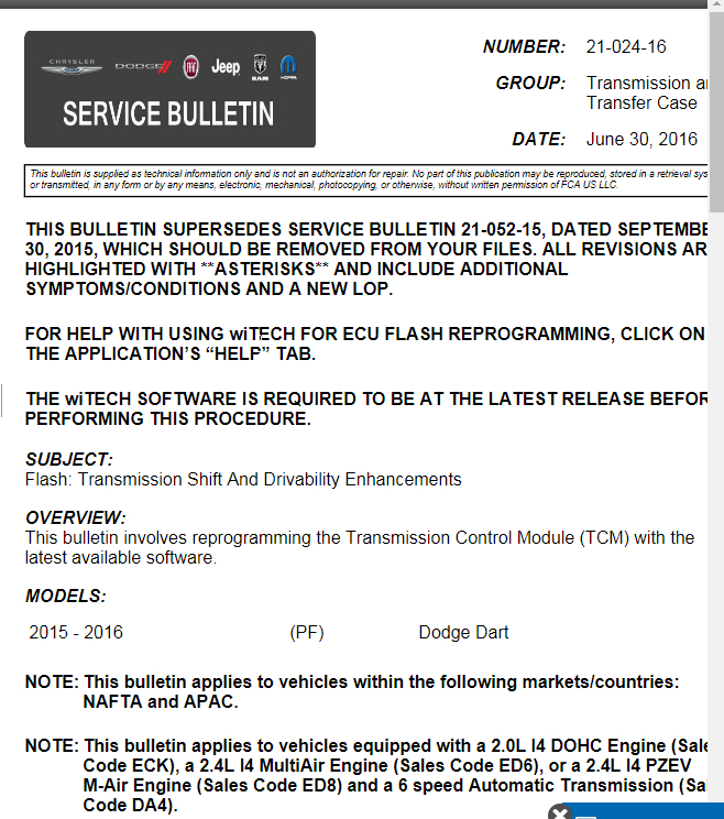

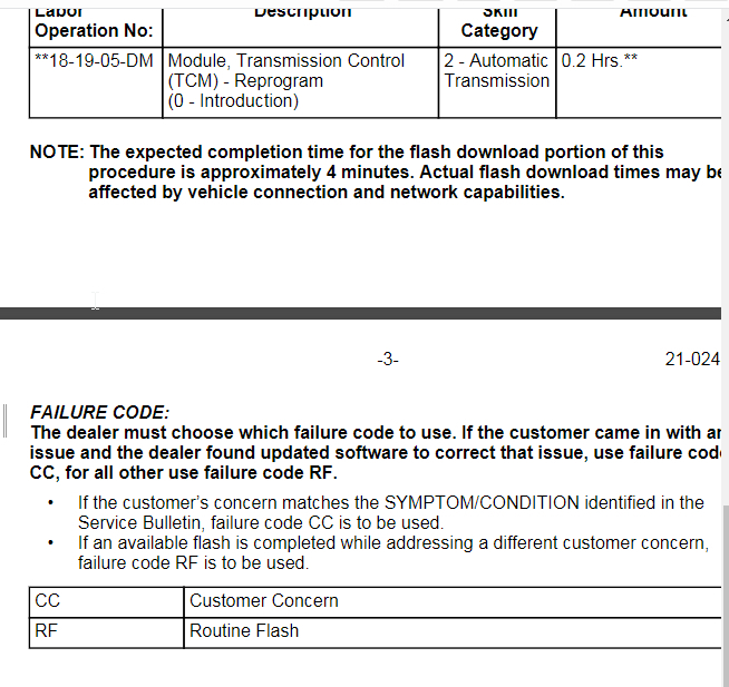

I am not finding any TSBs related to the traction control system but attached one for a flash of the TCM that they may have been talking about.
