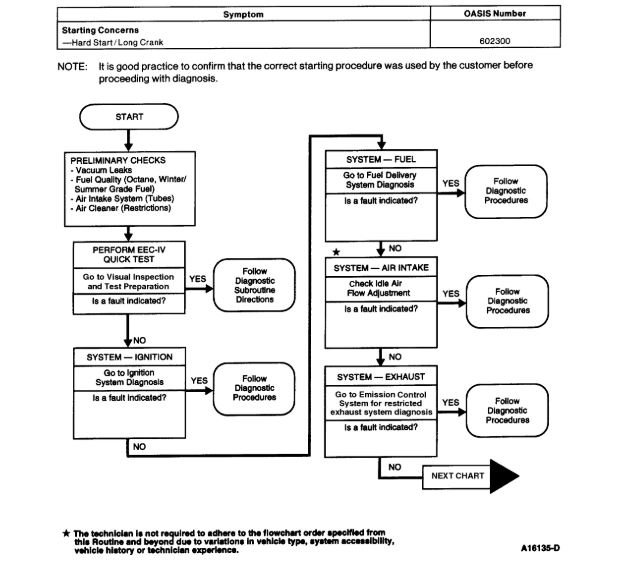

Sometime doesn't start first time, but has started eventually. sometime engine quit's while driving, does start when it want's eventually. ABS light comes on and goes out randomly.

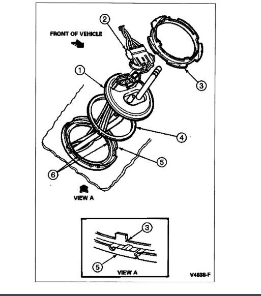

The engine could be low fuel pressure. I would check the actual pressure before assuming anything.

Just checked fuel pressure on fuel rail. I think it's low as you suspected, does not spray fuel it just kinda runs out.
Mar 7, 2020 at 6:39 AM
There you go. Good find.
https://www.2carpros.com/articles/how-to-replace-an-electric-fuel-pump
Mar 7, 2020 at 6:54 AM

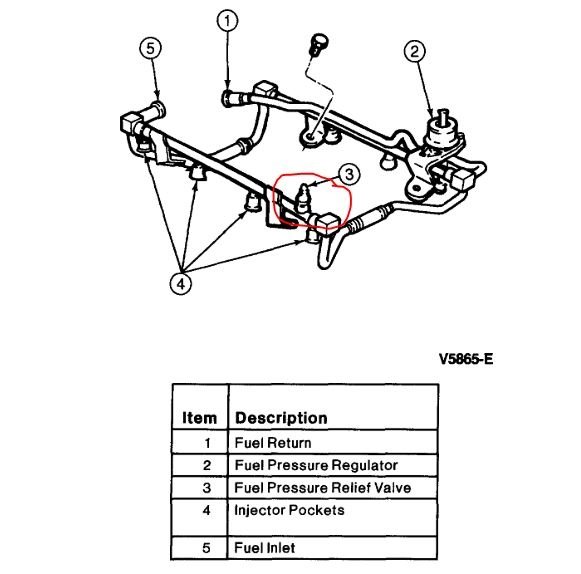

Hey Roy, changed fuel filter,lot's more pressure. took it for a drive two k down the road the ABS light came on.checked fuel pressure seem's like not as much fuel volume. Raining too hard to continue trouble shooting ,Doesn't make a difference which tank i use. any ideas ?
Mar 7, 2020 at 10:23 AM
Check the actual pressure. You will need a gauge.
Again, I need the ABS fault code for that.

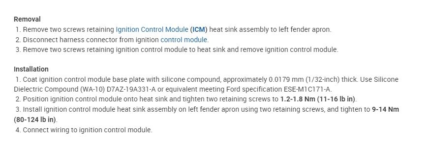

I think the problem is electrical. I originally thought it was the ICM, but when it died i put on my spare ICM ,didn't make a difference,still didn't start.when it did start i tried the other ICM and it started also.like there was no power getting to the ICM.

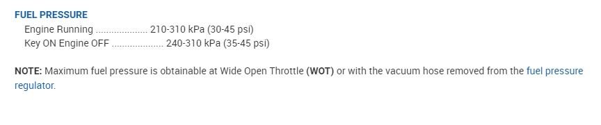

Me again.I did a pressure test,fuel pressure is around book spec's. I took it for a short drive last night,it shut off but started right back up.it was fine the rest of the way home. Any other ideas?
Mar 9, 2020 at 12:32 PM
Okay. what was the exact pressure?
Mar 9, 2020 at 7:54 PM
MORE FOR LES
  • 11 POSTS
32 psi ,when truck is running.
Mar 9, 2020 at 8:06 PM
35-40 pounds is the spec for the pressure.
I think you need a fuel pump.

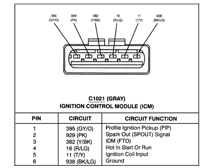

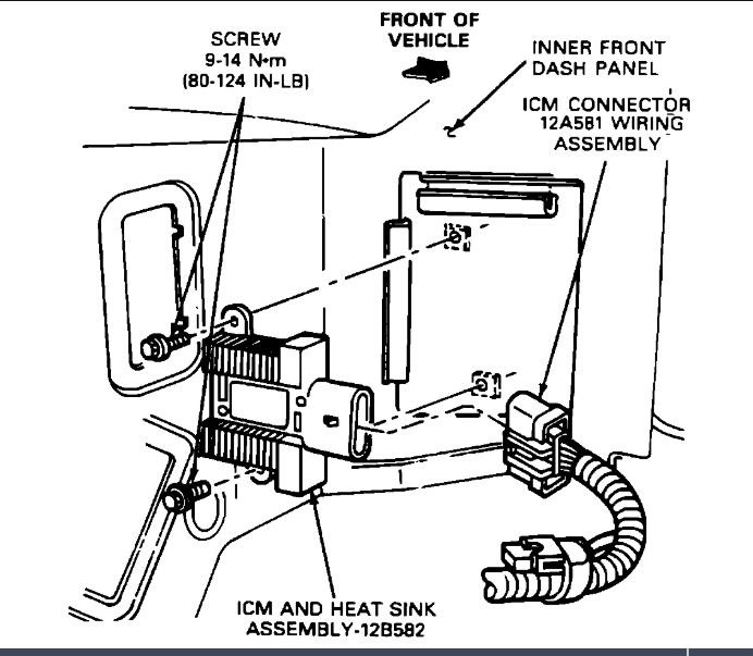

Both tank's have a fuel pump. same pressure reading in both tank's. seem's to be more of a ignition problem.Truck does not sputter or starve for fuel,it's more like i'm turning the key off.wondering what would cause the ICM to not have power to it?
Mar 10, 2020 at 4:40 AM
It could be the module or the distributor pick up if it is ignition related.
I would not blow off the pressure so quickly.
How did you verify you have no power to the module?
Mar 10, 2020 at 6:39 AM

to reword things; it'snot the ICM, one time when it shut off i changed the ICM with a good working ICM, still didn't start. this problem has been doing this intermittently for 4 years. I'm not sure if it's possibly the hall effect or maybe a short in the coil or maybe the power-train control module. sometimes it will go for hundred's of kilometer's without any problem's.
Mar 10, 2020 at 10:20 AM
When it does not start, do you have spark and fuel pressure?

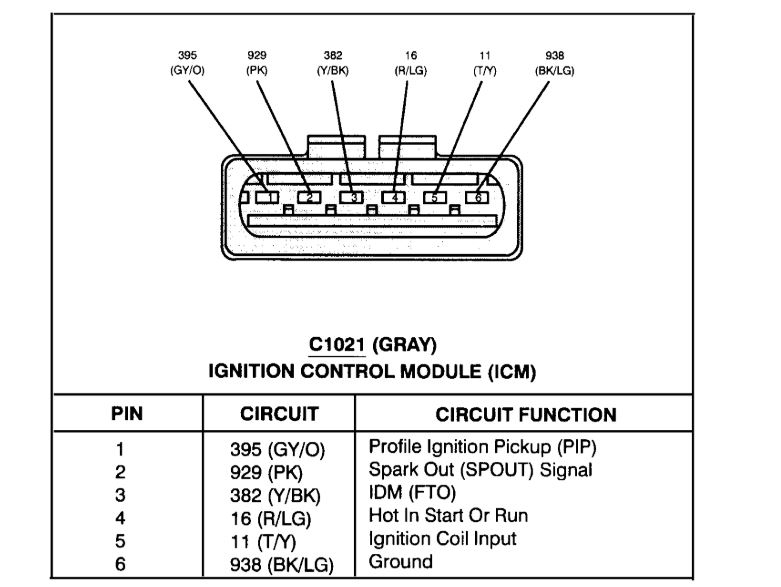

Supposing there is no spark. what's the diagnosis Doc?
Mar 10, 2020 at 1:28 PM
You will need a test light and test for power on the negative side of the coil. There should be power. Then crank the engine. The test light should flash while cranking.
If it is flashing and you have no spark, you need a coil. If it does not flash, you need an ignition module.
