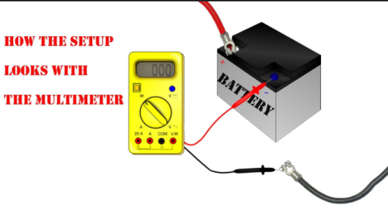

Hi, I'm in the UK and have a Kia Ceed (Forte).
When I turn my side lights on, I lose use of the rear window heater and A/C button and the radio display is dimmer than it should be.
I have been using a test light between the negative battery terminal and the battery lead (disconnected) and it lights up. I've been pulling fuses one by one, and the light goes out when I pull the audio fuse. Also, if I pull the room fuse the test light is dim and flickers - room and audio fuses come out together in a cradle so I've been testing by putting fuses back in individually.
Not sure where the best place to check next is. would appreciate suggestions.
Thanks, Jason
Feb 9, 2022 at 12:11 AM
This could be a ground issue, but we need to do the same test that you are doing with the test light except with a meter and find out how many amps are being used.
Basically, the radio is going to always be on so when you pull that fuse, and the test light goes out it is not unexpected.
The question would be how many amps it is drawing. It should be less than 35 milliamps (.035 amps). I attached a diagram below to show this.

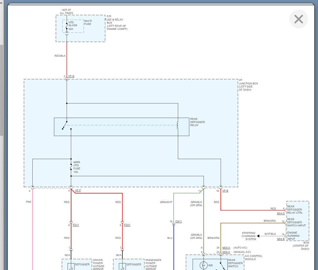

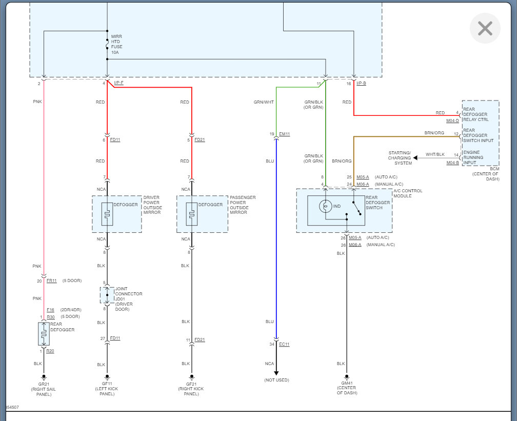

As for the lighting issue, we need to start with one system and turn it on and find out where we are losing power.
I would suggest we start with the rear defogging system and find out what the issue is with the side lights on.
I attached the wiring diagram below. Basically, we need to check the power when the lights are off and then verify the power goes away when you turn them on. Then we need to trace the circuit to find out where the power is and then that will tell us what the issue is.

Thank you for your response. Since posting I've done two more investigations and think that the Aircon switch is actually working, it's just not illuminating the switches and dimming the radio/clock display when the side lights are switched on (the exterior lights are all working). so probably an internal grounding issue.
