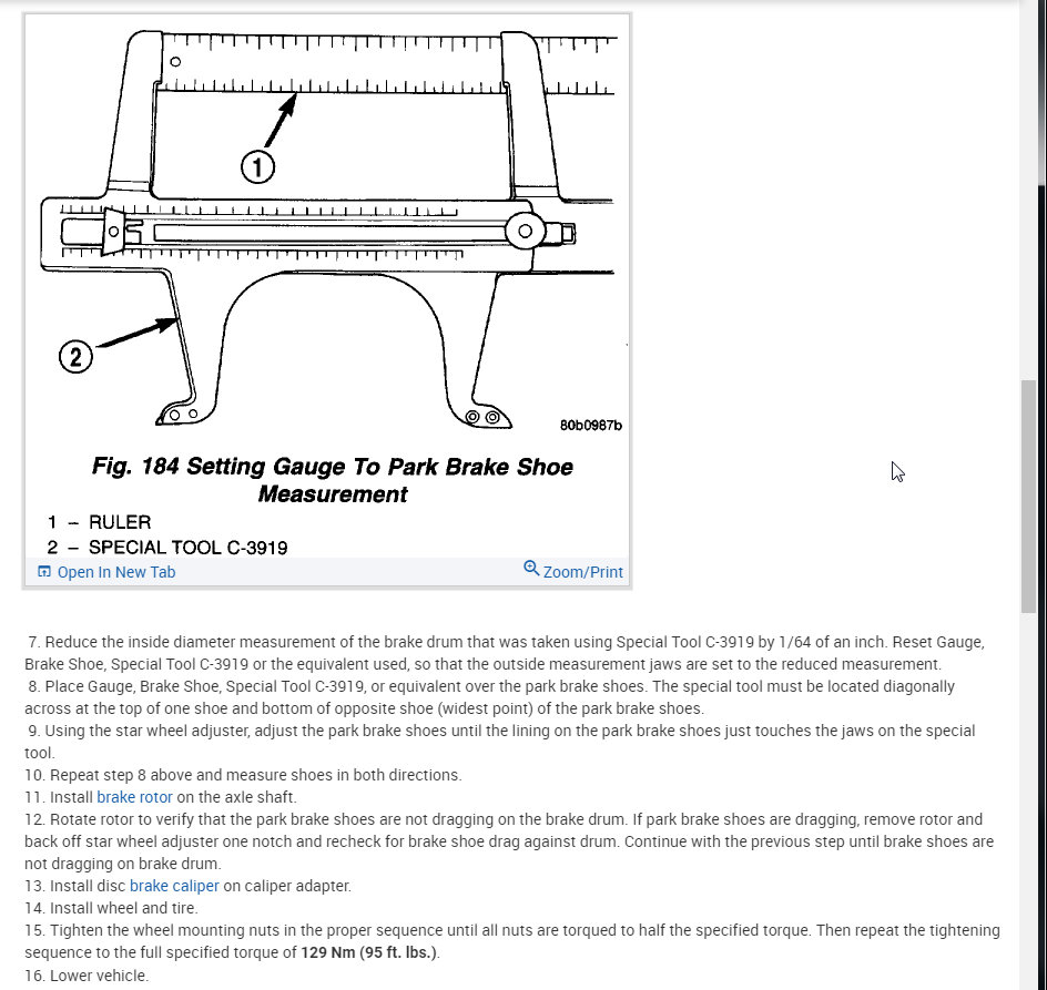

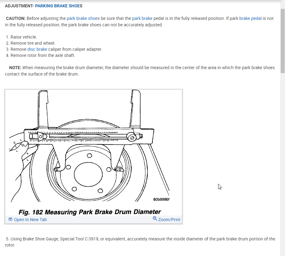

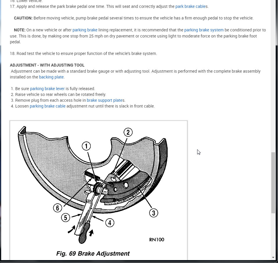

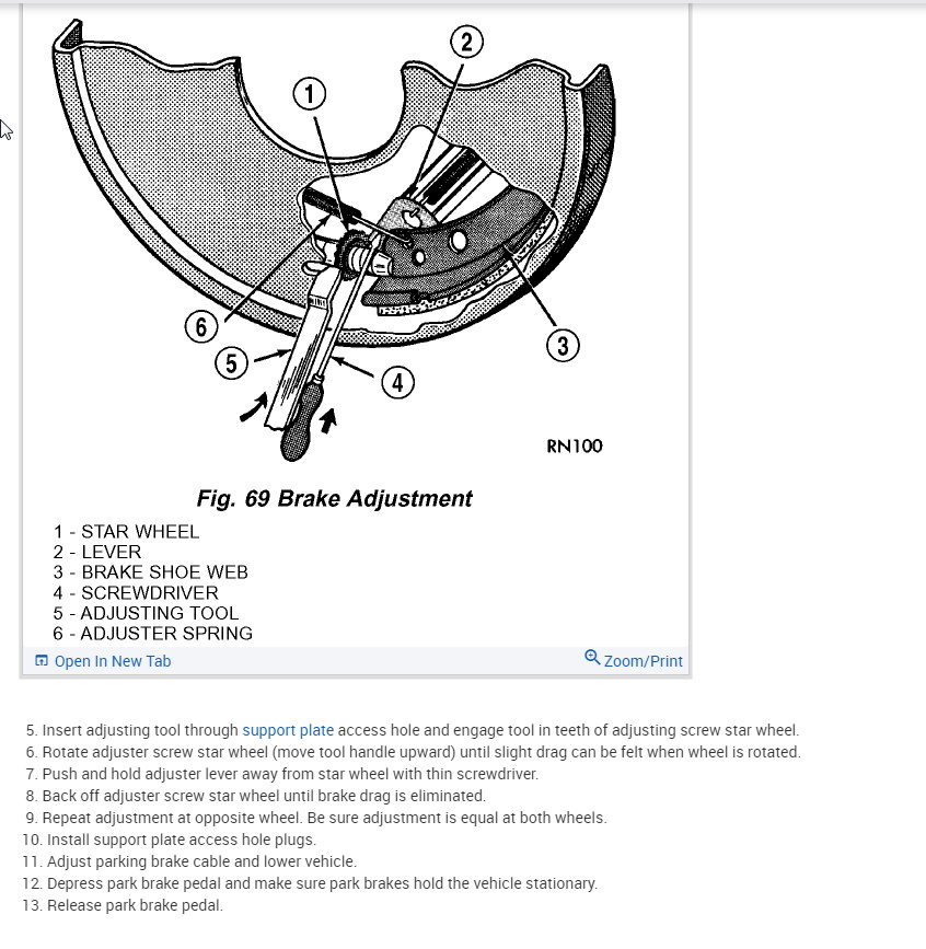

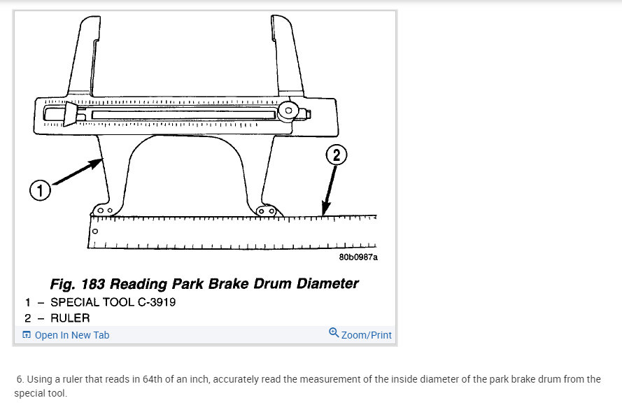

Was the transmission in neutral? If it was then yes. They should spin. I suspect the parking brakes are adjusted to tight and they are actually dragging. I attached the procedure to adjust the parking brake in the rear. The other possible cause is the parking brake is applied indicating the lever or cable is not adjusted properly.
Let me know if you have more questions.
