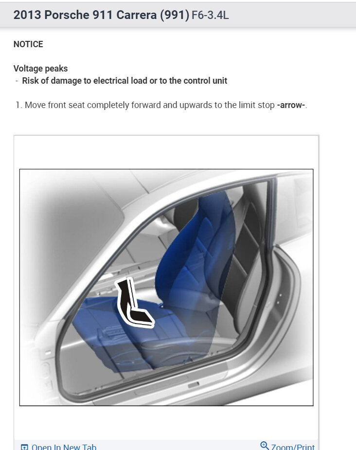

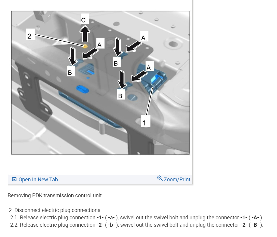

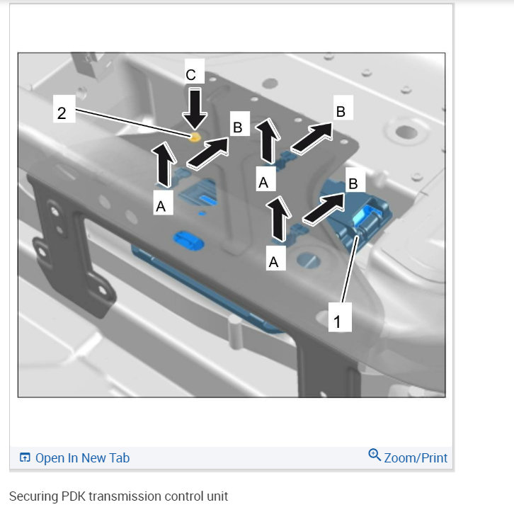

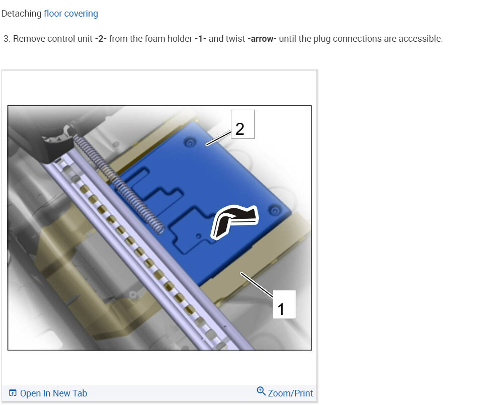

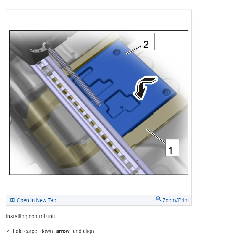

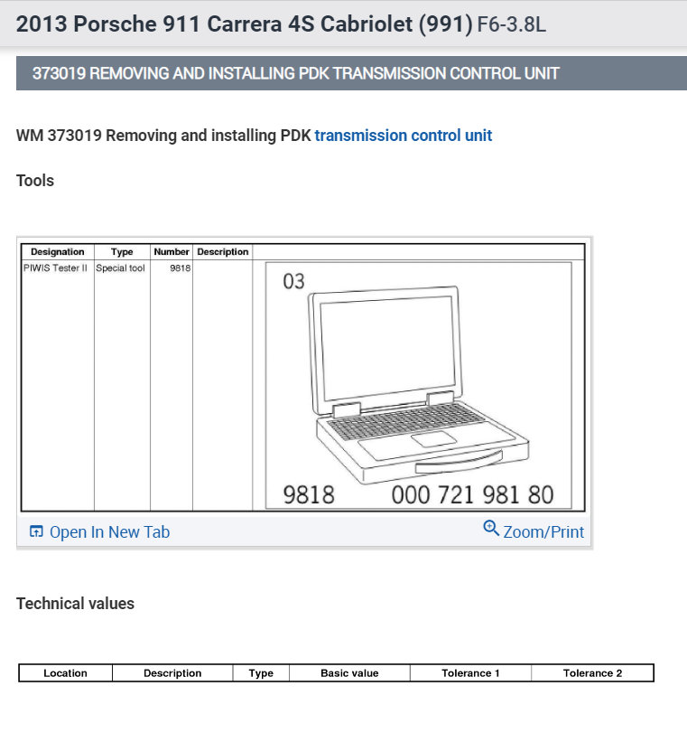

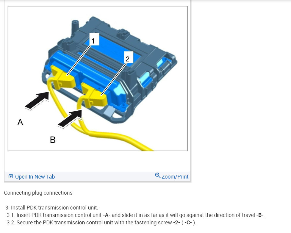

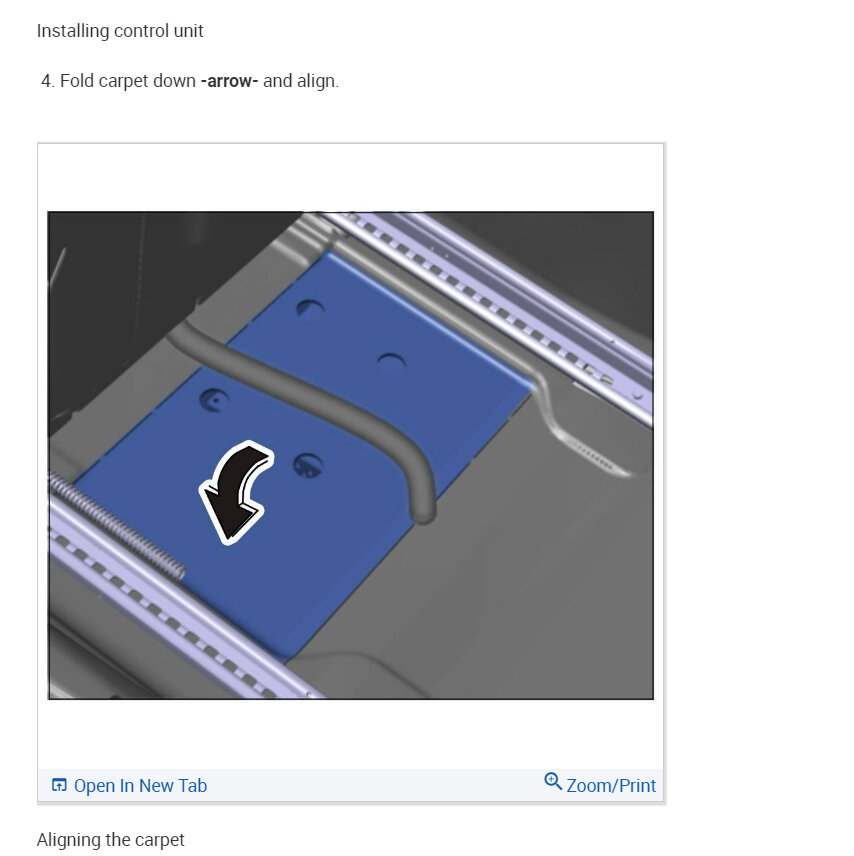

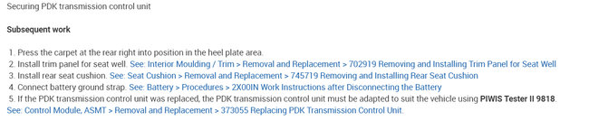

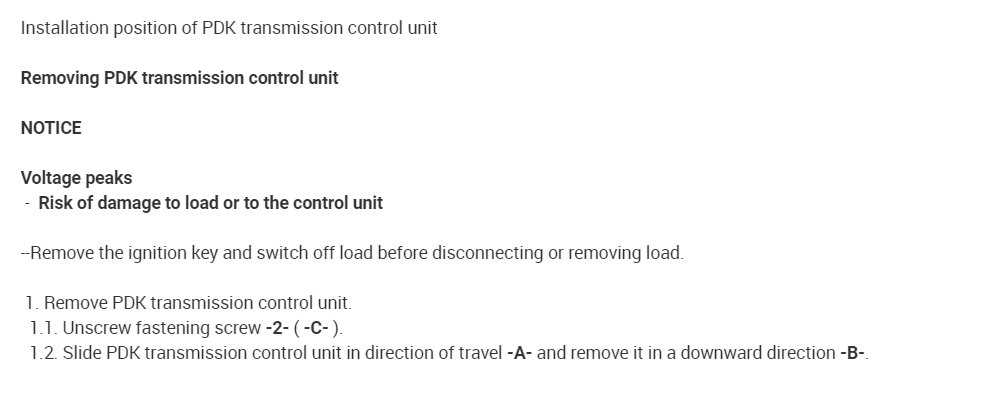

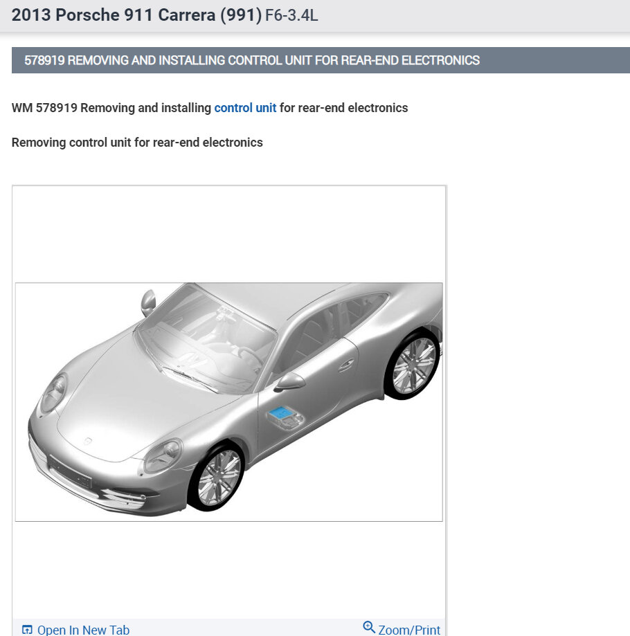

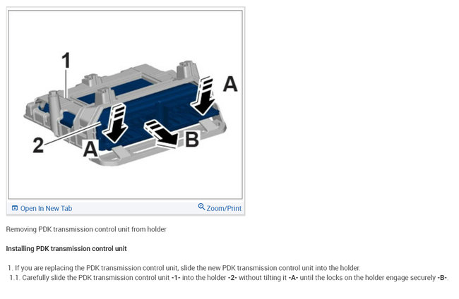

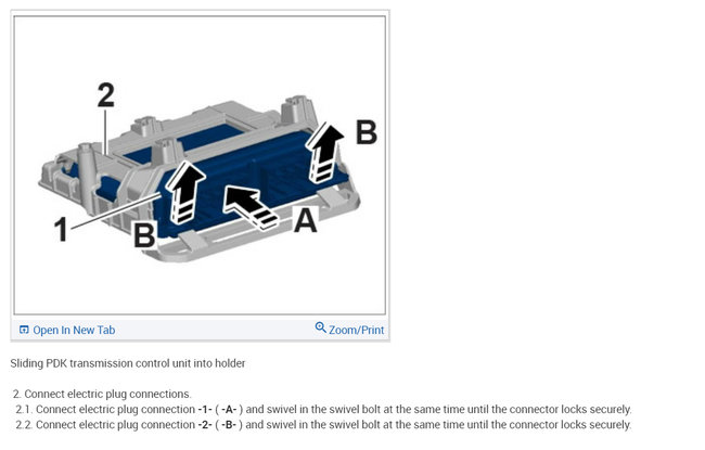

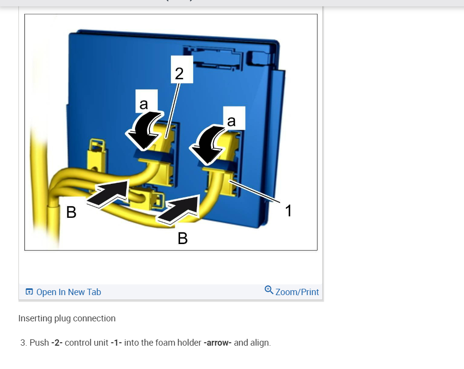

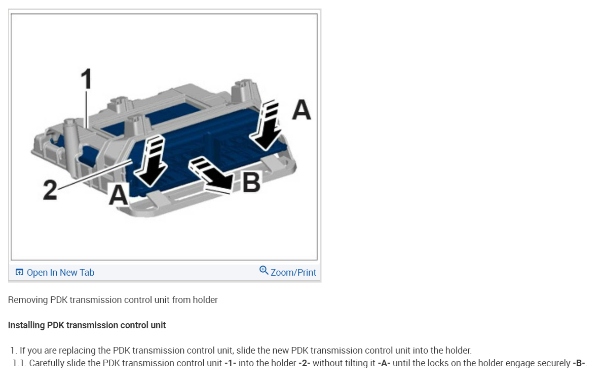

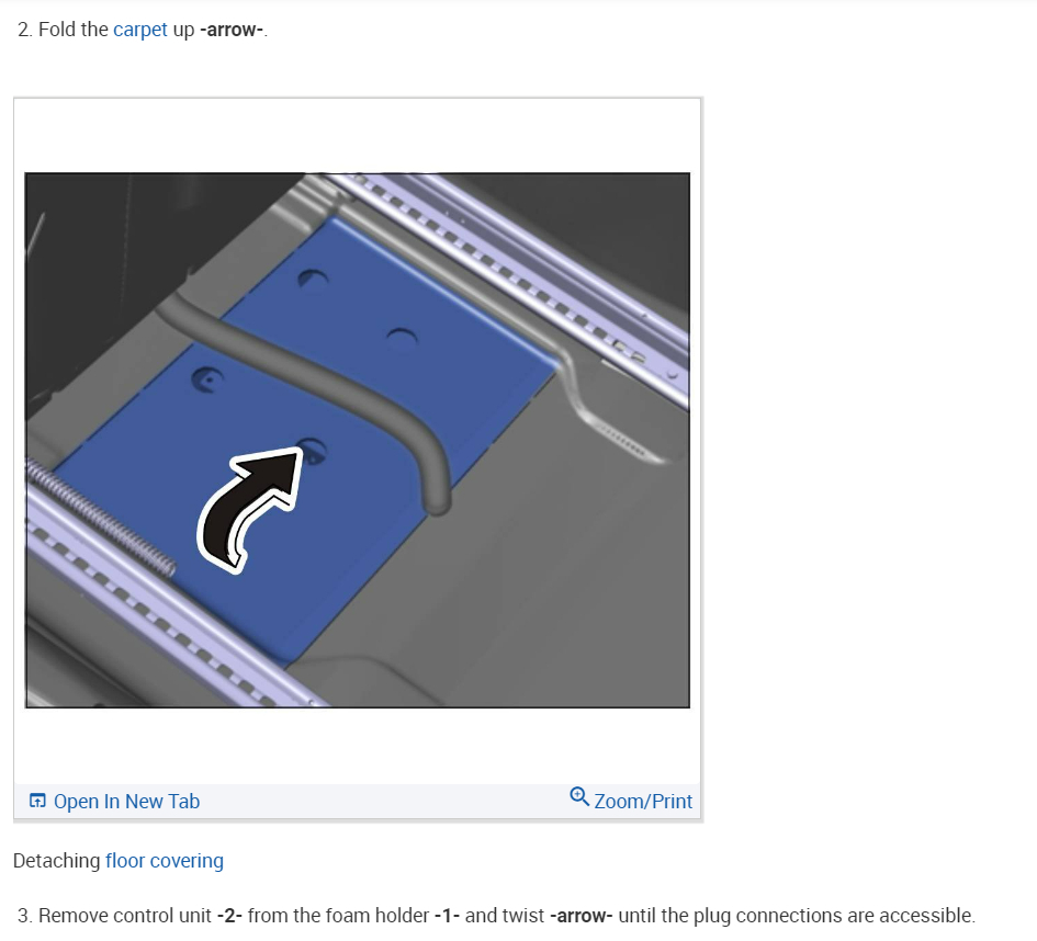

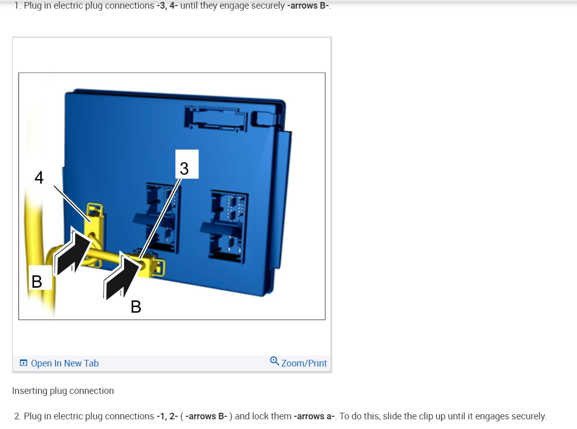

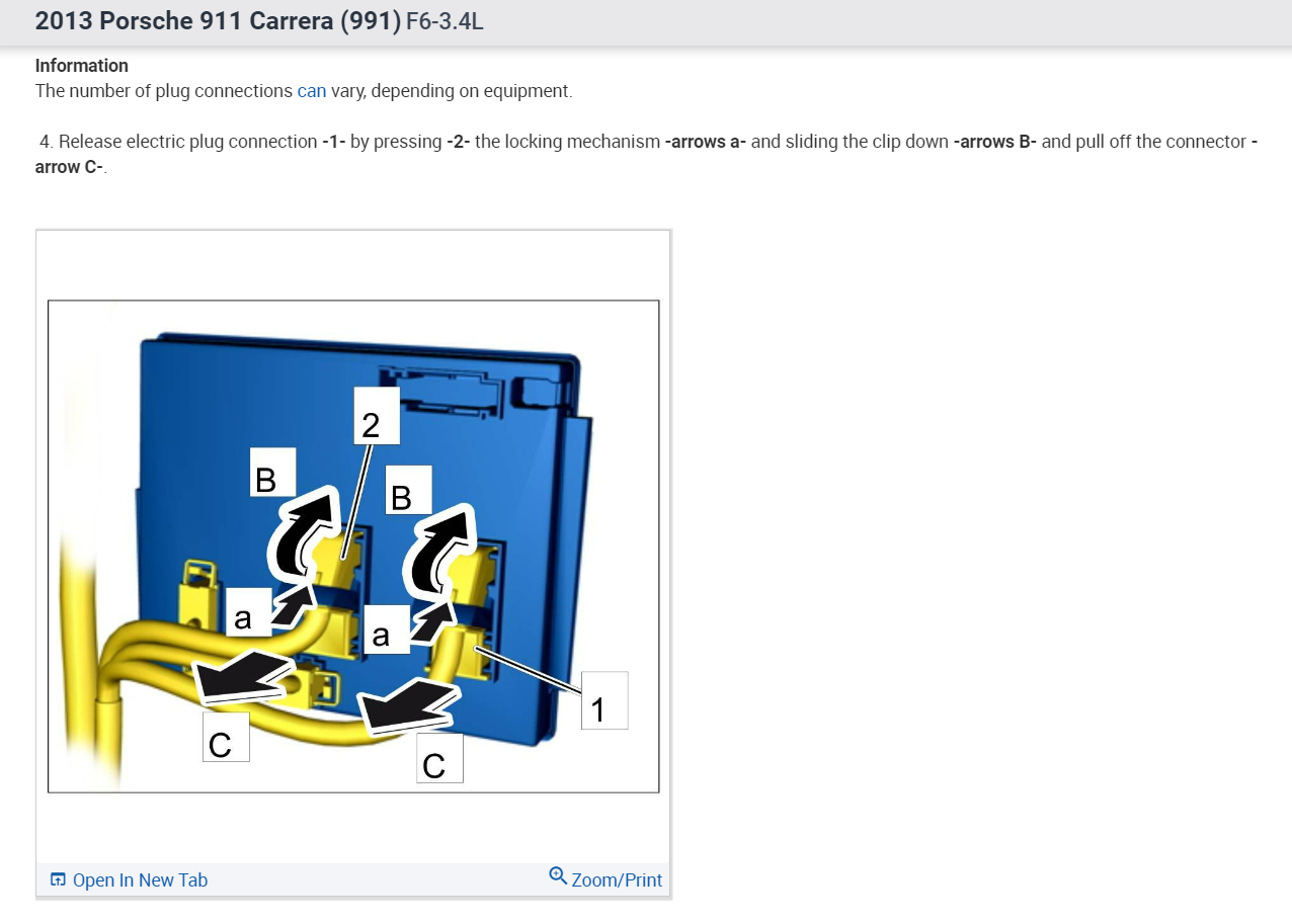

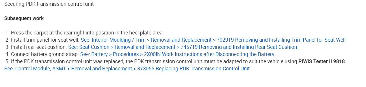

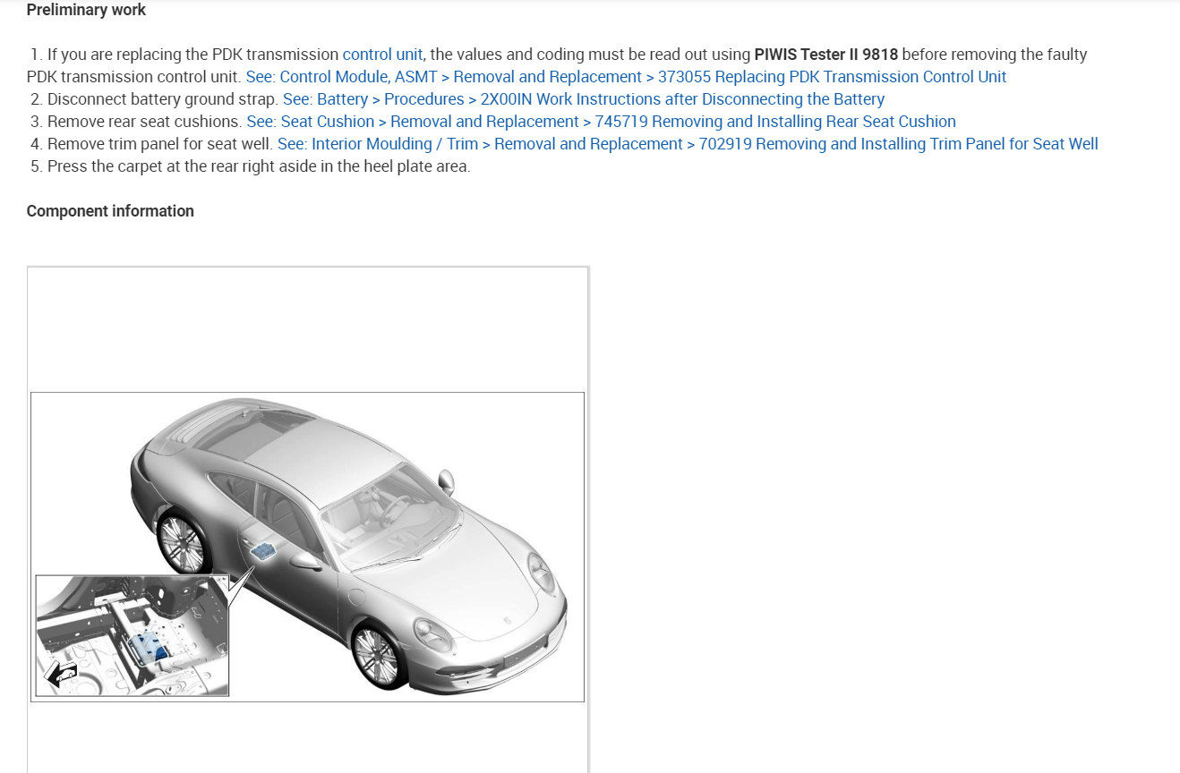

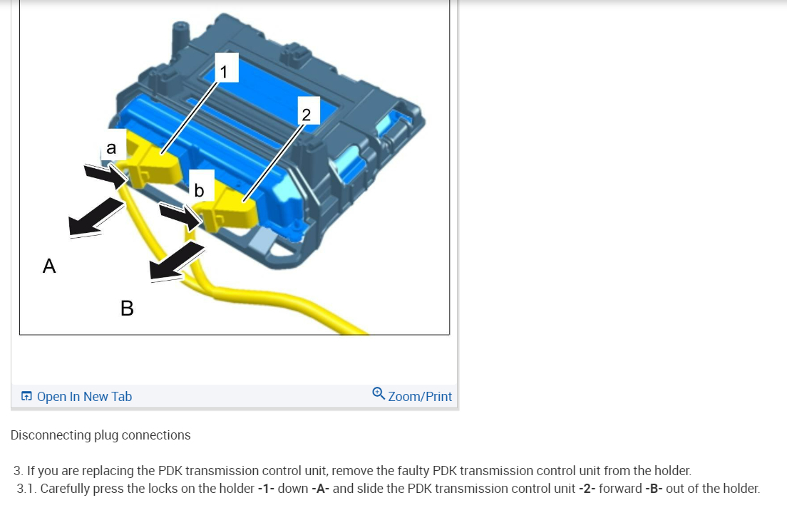

P1732 transmission fail safe and P0700 Transmission Control System Malfunction. And the fact that once it malfunctioned again even more codes came up, I would say the TCM is going out. here is the location and how to replace it, so you know what you are in for when doing the repair.
Control Module 99161827015 $1004.18
Trans Controller, R&R 1.4 HRS

Hello Ken, the shop has installed a new TCU already and they are currently in the stage of reprogramming using PIWIS 2 and 3. The current issue is that the calibration process does not want to complete despite several attempts. Any advice? Thank you

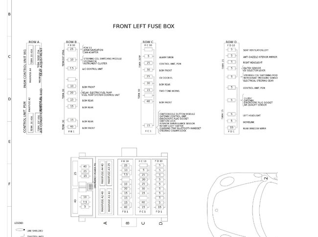

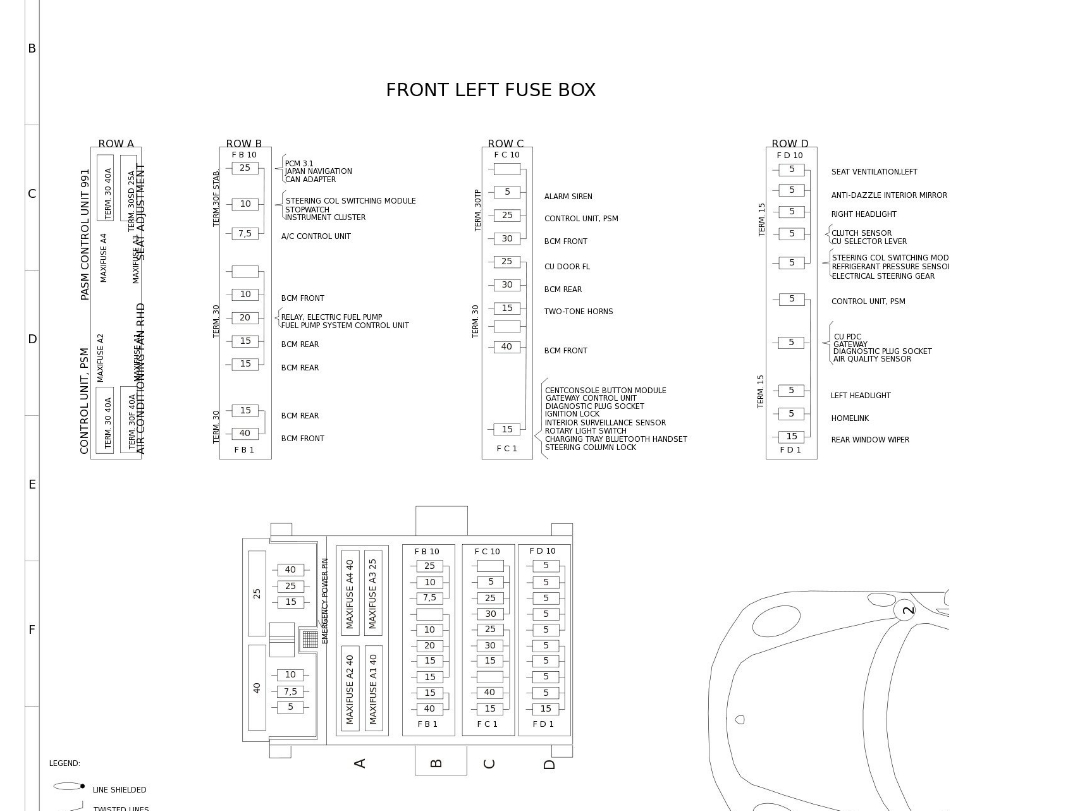

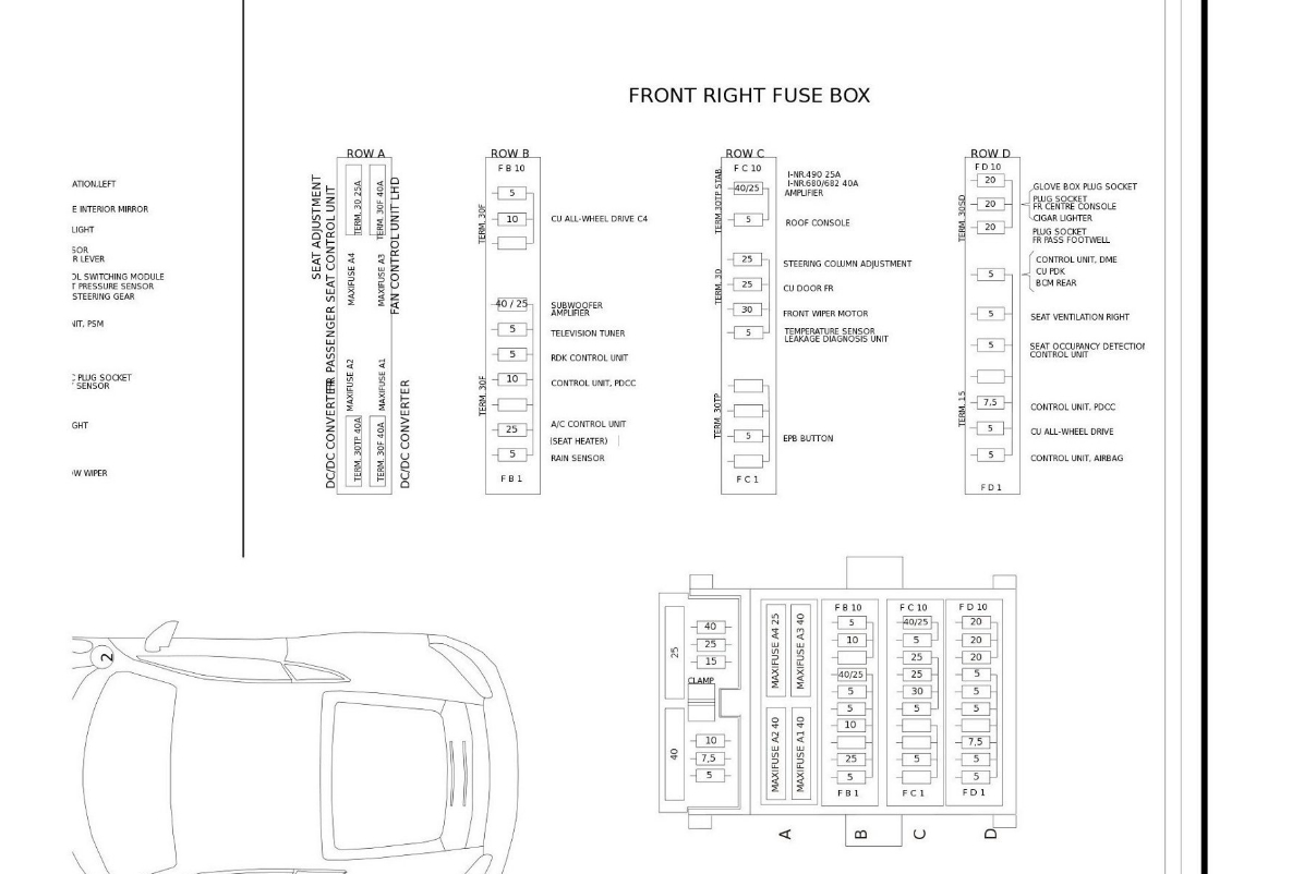

Does it give you any error? What happens when they try to reprogram it? Go over all fuses to make sure they are good, this guide can help:
These cars are temperamental so not one fuse can be out for the car to work correctly. Check out the images (below). Let us know what happens and please upload pictures or videos of the problem.

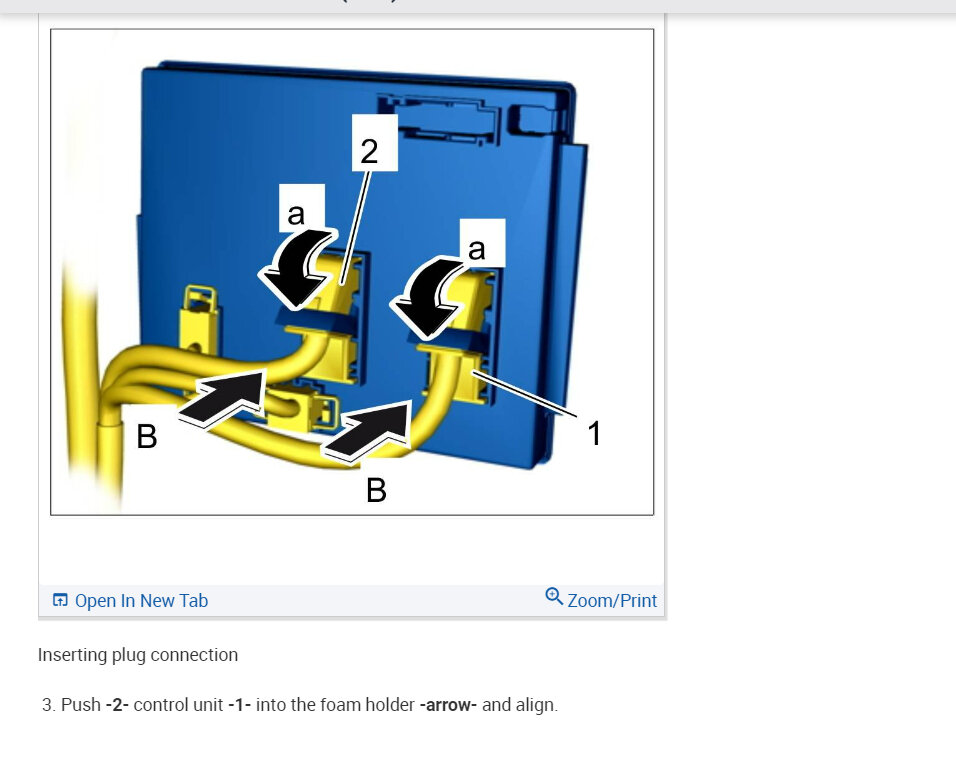

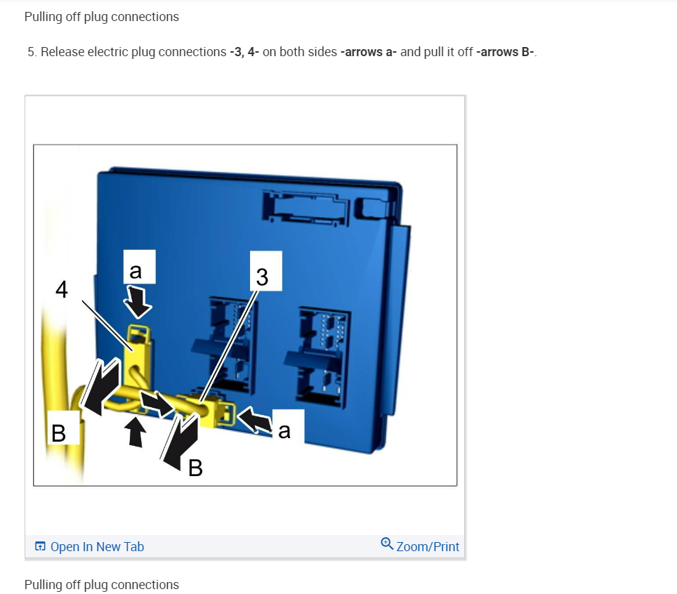

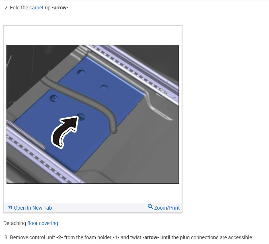

Going from bad to worse, hmm, did this car have any water damage? I noticed the BCM is down under the driver's seat, I would see if the connector were corroded which will tell us water damage for sure. Check out the images (below). Let us know what happens and please upload pictures or videos of the problem.

No water damage. The shop's location is sits fairly above street level where rainwater could not reach, I believe. The car is also stored properly inside the shop's hangar. I will ask the shop to check the BCM's condition. Thank you

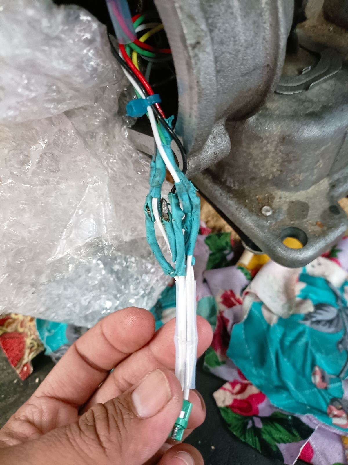

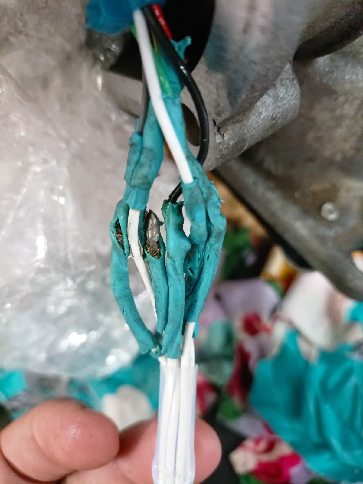

Hello Ken, the shop discovered the problem. They said the wiring of the PDK Distance Sensor looked like it melted. See the green tube tapes in the pictures attached. Would you know what caused it and what material they should replace it with? Thank you
Nov 3, 2022 at 2:52 AM
  • 54,832 POSTS
Good find, that is a bad wiring job for sure, I would solder the wires and use high quality shrink wrap. That should fix the problem, thanks for the images.
