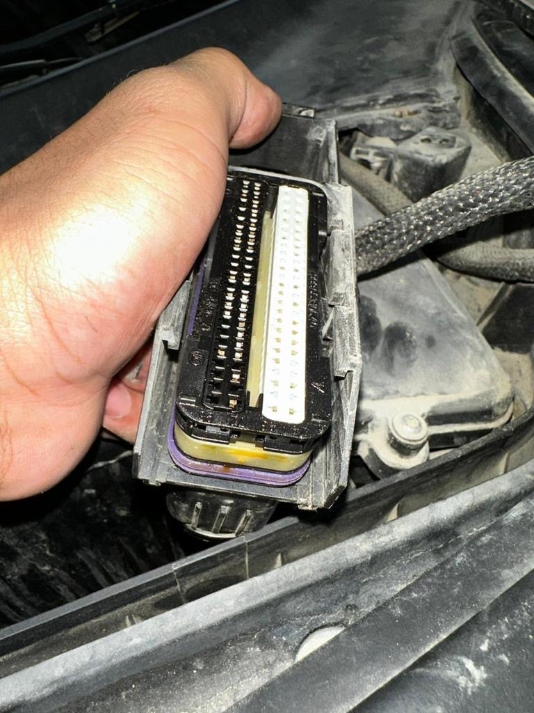

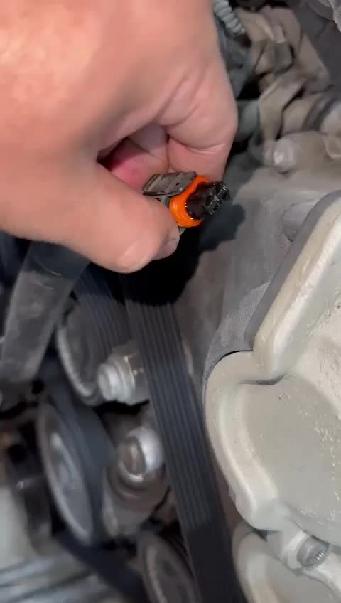

so, I been told by agency that due to an oil leak I need to change the full front wiring and crank vent heating replacement as they have seen oil leaks on the wirings and if problem continues change DME as well and quoted for parts as below which will be around $7,000.00 as the bill below is in UAE AED and very expensive for me to repair!
Is there any temporary fix for these or way to make sure which will stop the engine cutting off problem or solution to fix it with aftermarket or outside mechanic not agency?

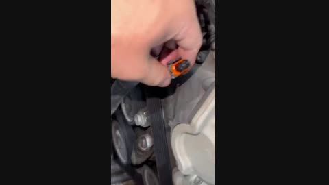

The video shows the leaking on the wiring.
Please let me know.
Thanks
Jan 25, 2024 at 7:35 AM
  • 110,244 POSTS
I watched the video. I truly don't feel they need to be replaced. I would simply clean them with something like an electronics cleaner and then blow out any residue.
Why are they saying the harnesses need to be replaced? Simply because of the oil? If that was the case, 75% of vehicles on the road would need new ones. At least that is my thought.

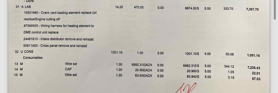

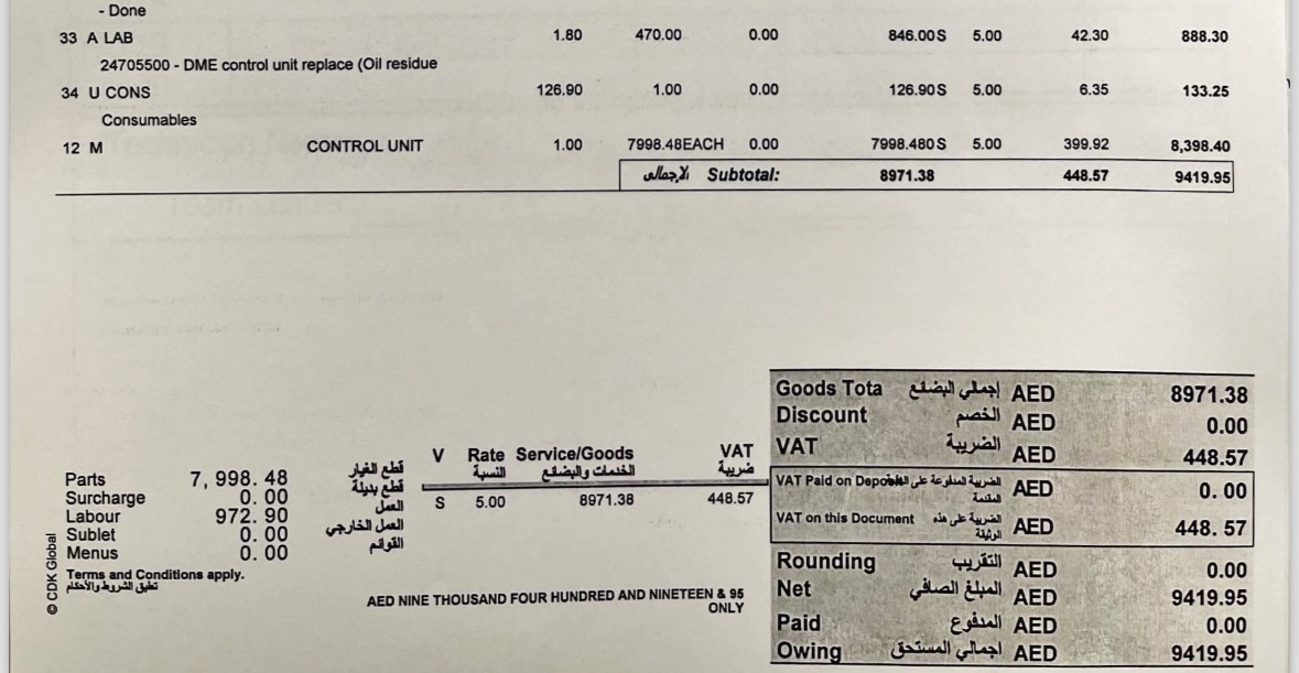

So, yesterday I visited Porsche agency again to discuss their observation in person and based on what they told me as I said they need to change full wiring cables below and most probably the DME unit as they believe an oil leakage has reached DME unit that's why engine keep shutting off and showed me like images below!
However, their quote estimation is crazy as labor hours would be 15 hours which is $150x15= $2250 just labor and same amount for the original wiring.
Even cleaning wiring would cost the same as the labor fee for new one.
And DME unit would be another $3,000 and with discount total would be like $5,500.
So, I'm very tight on budget right now that even if I find the wiring from outside still the labor fee is crazy so I will see if it's possible to at least find the DME from cancelled cars garages but for wiring apparently must be genuine new part and only agency itself can fix it!
My question is, if you think there is any temporary fix, or the end of the wires can be cleaned until I sell the car in a few months?

Wow, that is a lot of money! The one thing that concerns me is it doesn't appear they are guaranteeing this will fix the problems. What if they do it and the problem isn't resolved? Will they not charge you?
As far as what I would do would be to disconnect one harness connector at a time, check it, and see if that resolves the problem.
