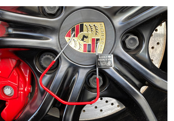

how do you remove the center wheel cap?
2009 PORSCHE CAYENNE
JIMDDTAMIT
Sep 15, 2010 at 3:09 AM
SQM
  • 6,383 POSTS

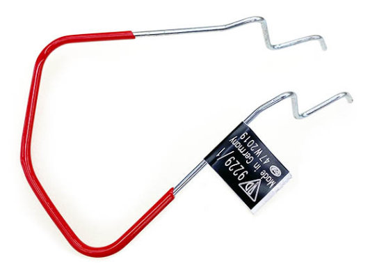

This actually requires a special tool, which needs to be inserted into the two holes that are on the center cam and pull.
It is difficult to take off those caps without damaging the wheels, if you do not have the tool.
I have attached pictures for your reference.
