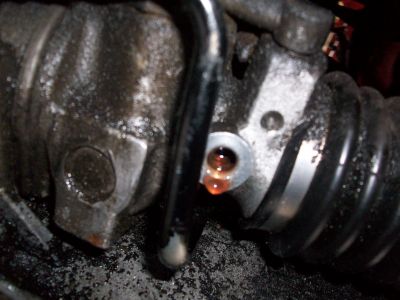

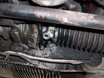

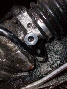

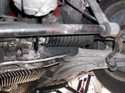

Popkih21 PostPosted: Wed Oct 13, 2010 1:31 pm Post subject: 1986 Porsche 944 Steeing rack gone bad? Steering problem 1986 Porsche 944 Two Wheel Drive Manual Here is where I am leaking power steering fluid out of the Steering Rack. It looks like the hole is threaded and may be missing a plug but there was a black gasket/plug/seal in this hole before and it didn't leak at all before (ok...maybe a drop or two) Any info on this situation would be Greatly Appreciated!!! Thanks in ADVANCE : )
https://images.2carpros.com/forum/automotive_pictures/582694_Picture_004_2.jpg
https://images.2carpros.com/forum/automotive_pictures/582694_Picture_005_2.jpg
https://images.2carpros.com/forum/automotive_pictures/582694_Picture_006_2.jpg
https://images.2carpros.com/forum/automotive_pictures/582694_Picture_007_2.jpg
