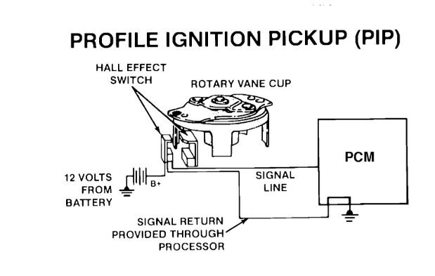

When the problem is happening, does it feel like a misfire or as if it is a throttle issue. It clears up so I have thoughts, but can't confirm without being there.
I'm starting to question of the crankshaft position sensor or a camshaft position sensor issue. The cam sensor's info is used by the PCM. The PCM uses this information for fuel injector timing and calculating ignition timing advance.
The vehicle also has a profile ignition pick up which functions as a crankshaft sensor. The Profile Ignition Pickup (PIP) sensor is a Hall-effect type switch located in the distributor. It sends the Powertrain Control Module (PCM) information on engine speed and crankshaft position. If that is failing, it is possible for these symptoms. However, most times when they fail, the vehicle doesn't run or there is no change in the poor running condition.
See pic 1 for the PIP
