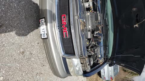

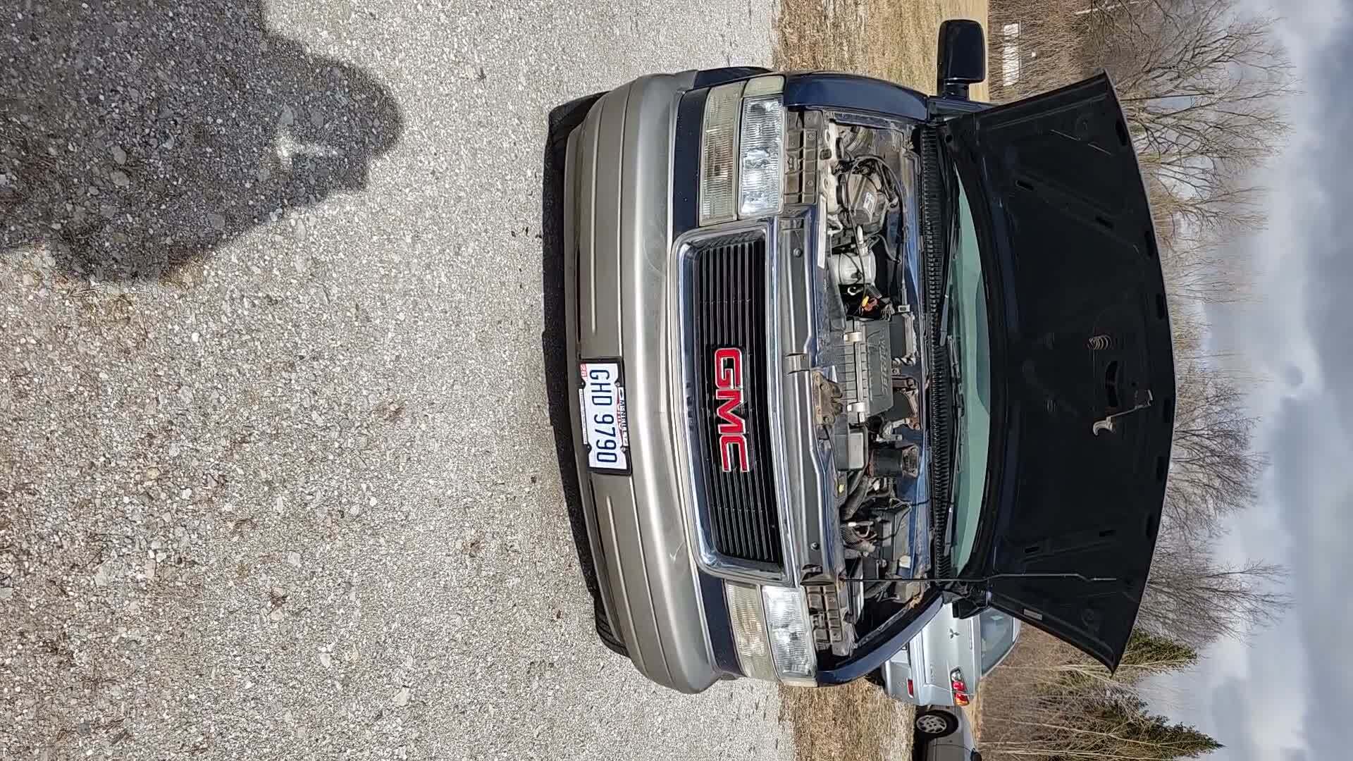

There is a popping noise when driving or idling?
2004 GMC SAFARI
136,000 MILES • 4.3L • V6 • 2WD • AUTOMATIC
TIMAPRIL
Sounds like it's under the hood somewhere.
Feb 9, 2023 at 12:23 PM
  • 110,194 POSTS
Does the engine seem to still be running properly? Has the check engine light turned on while the engine is running? Is the sound louder with the hood opened? Is there anything that changes the speed of the noise or intensity? For example, if you rev the engine, does the sound change?
If possible, record the sound and upload it for me to hear. That may be helpful. Also, check the serpentine belt to make sure it isn't coming apart and a frayed portion is hitting something.
Feb 9, 2023 at 4:21 PM
TIMAPRIL
The longer I let it sit running the idle is getting rougher and shakes pretty good. It's not popping while idling right now but giving it a little gas here and there. The RPMs go down low after you let off and builds back up.
Feb 24, 2023 at 9:35 AM
  • 110,194 POSTS
By chance, has the check engine light stayed on while the engine is running? Listening to the video, it sounds solid.
By chance, do you have or have access to a live data scan tool? If you do, when the engine is at operating temperature, check the short-term fuel trims and let me know what they are.
