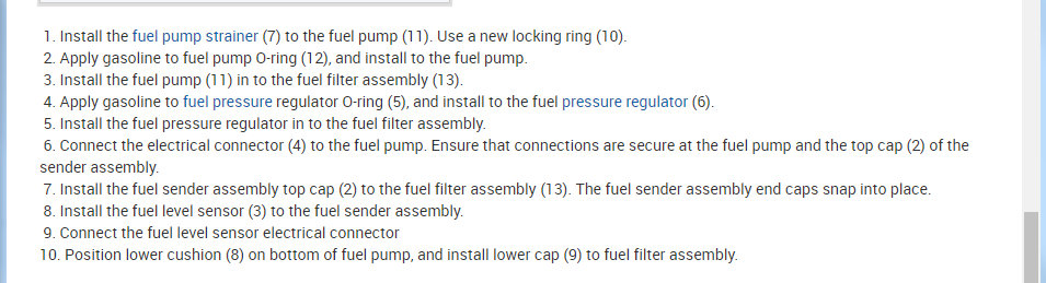

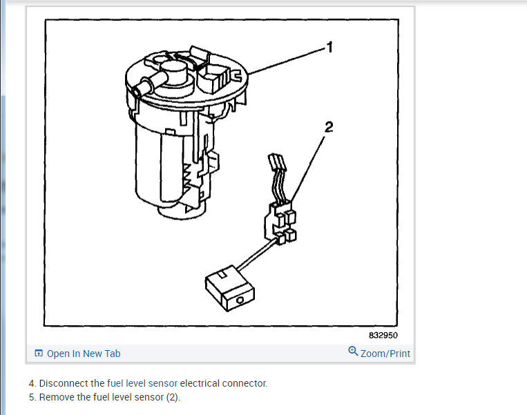

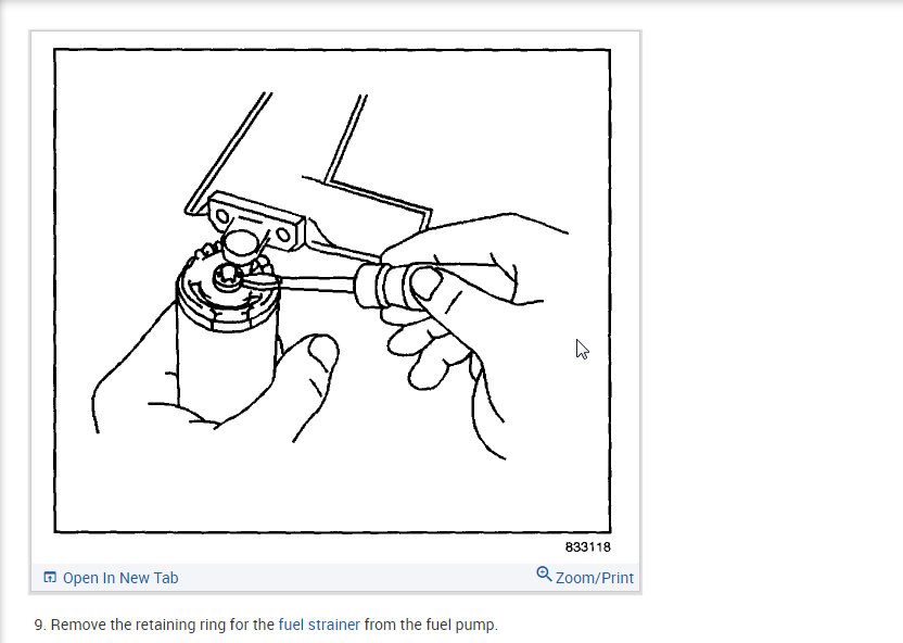

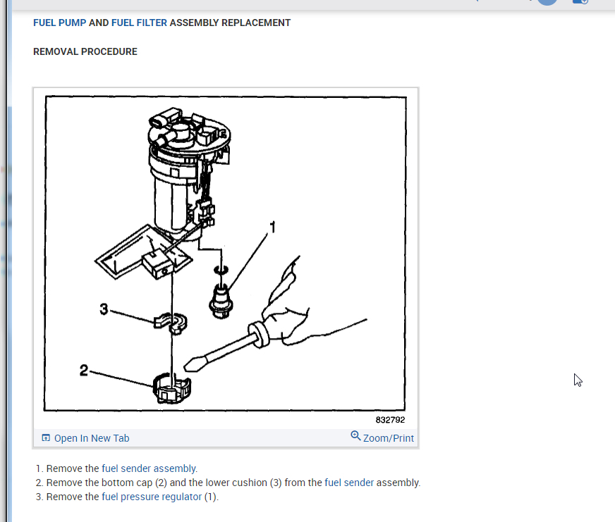

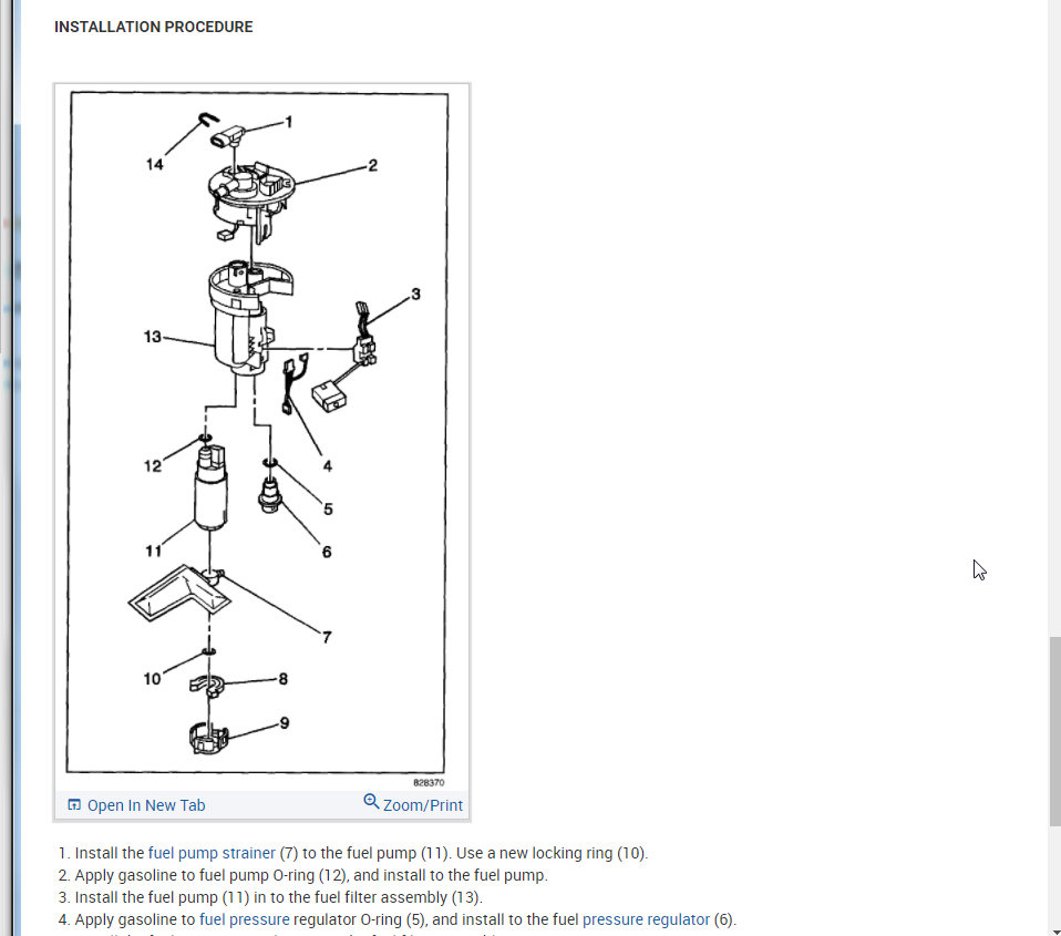

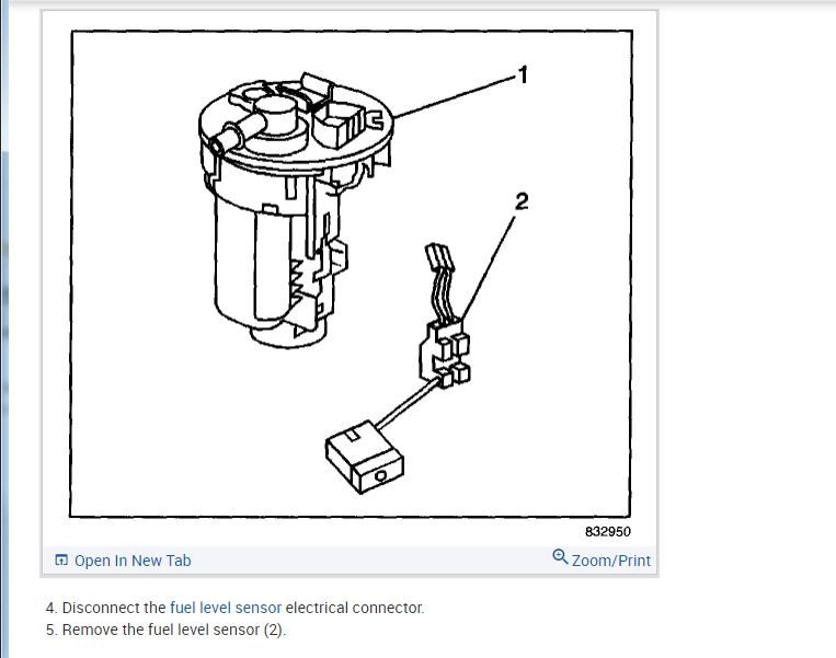

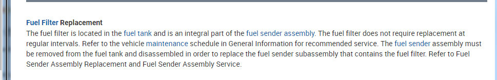

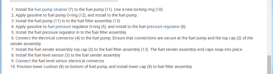

How and where do i change the fuel filter?
Mar 13, 2009 at 4:26 AM

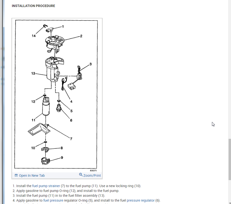

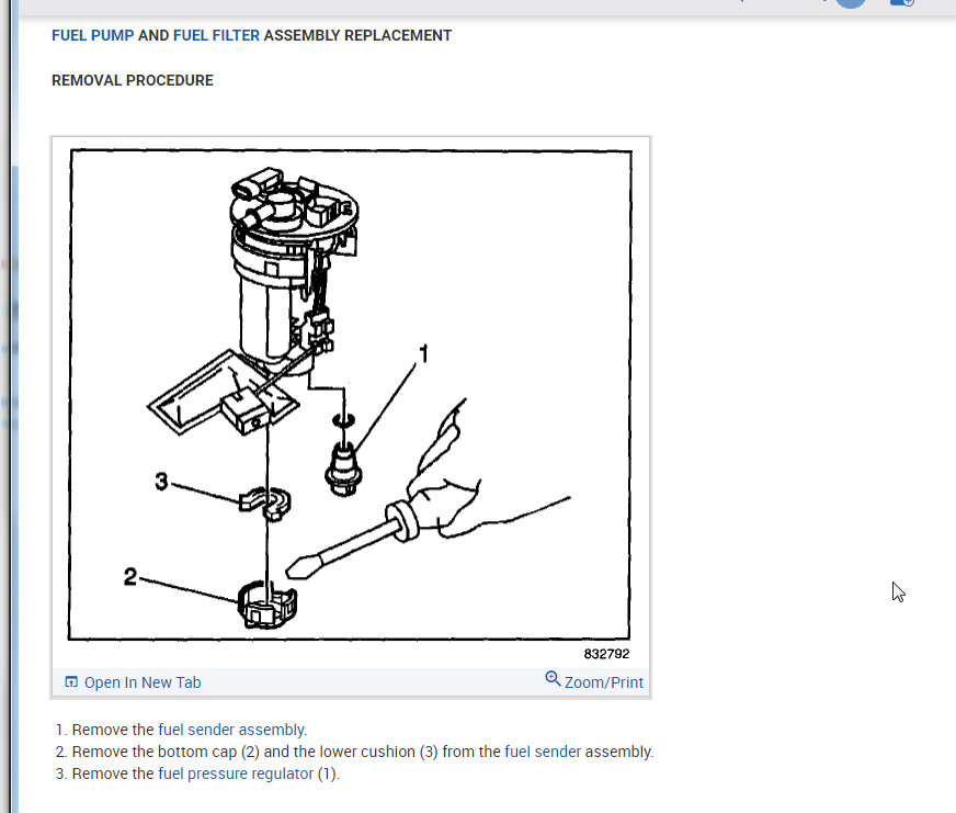

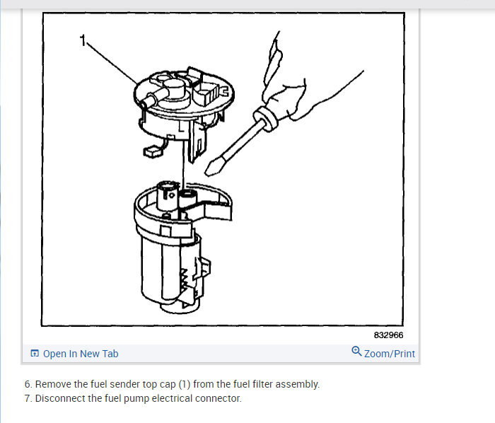

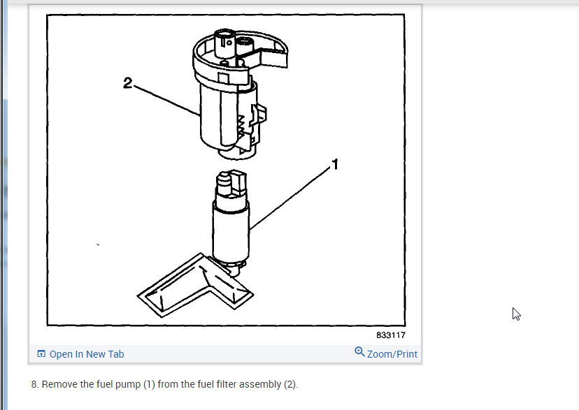

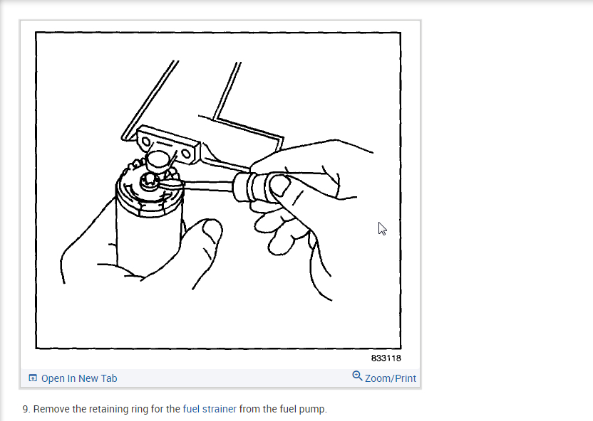

This fuel filter is located in the tank and part of the pump. It only needs to be changed if the pump needs to be removed for another reason. You are not required to change this as regular maintenance.
I attached the process from the manual for your review. Let us know if there is more info that you need. Thanks
