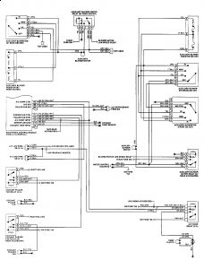

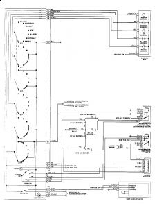

1. Wiring diagram. I will email you the diagram as well. It looks better with Windows Photo Gallery.
https://images.2carpros.com/forum/automotive_pictures/55316_92transportac1_1.jpg
https://images.2carpros.com/forum/automotive_pictures/55316_92transportac2_1.jpg
https://images.2carpros.com/forum/automotive_pictures/55316_92transportac3_1.jpg

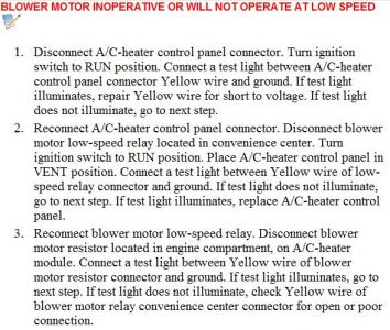

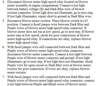

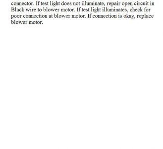

2. Here is the diagnostic steps to check the blower motor.
https://images.2carpros.com/forum/automotive_pictures/55316_92transportac01_1.jpg
https://images.2carpros.com/forum/automotive_pictures/55316_92transportac02_1.jpg
https://images.2carpros.com/forum/automotive_pictures/55316_92transportac03_1.jpg
3. Just battery voltage. 12.6 volts. Don't worry about the amps.
