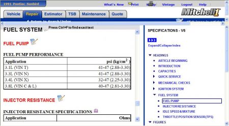

Sir-can you provide the fuel pressure readings. The injectors listen to it if its clicking, or use a noid lite to see if its getting power and get back to me.

Alright, the fuel pressure at the schrader valve is consistently at 41psi. It seems to hold that preasure for a good amount of time following fuel pump prime. Also, I used a noid light to test the exposed injector...the light flickered as if the injector was to be properly working. I appreciate your help. Thank you.

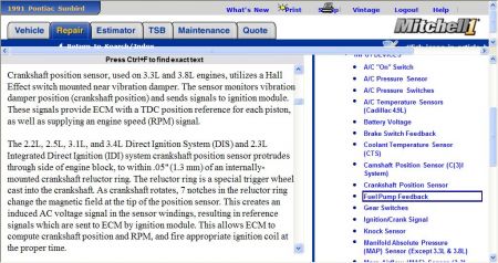

Test the crankshaft sensor resistance should read 900-1200 ohms. Also set the meter to AC 2 volt scale crank engine over reading should be .05volts slow cranking to 1.0volts at greater cranking speed

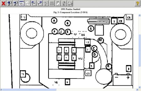

Sir-some auto references says it has a CPS and the software that am using says it has one for a 3.1 engine. Is this a direct ignition system-meaning don't have a distributor. and also is it VIN T engine? Try looking on the right side of the block below the exhaust manifold-see below pic location E

Thank you for your assistance. This motor has a direct ignition. The sensor you reference as "E" is located against the block below the manifold near the knock sensor. This according to my parts store is the camshaft position sensor, but this is not a crank sensor? I've already replace the camshaft position sensor located at "E". I appologize for any confusion.

The CPS protrudes thru side of engine block to within .05 of an internally mounted crankshaft reluctor ring-
CPS -Also look under the DIS module
