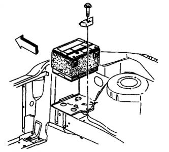

The Battery hold down on my montana won't come off. Is there a nut on the bottom which needs to be held to undo this.

Battery Hold Down Retainer Replacement
REMOVAL PROCEDURE
https://www.2carpros.com/forum/automotive_pictures/12900_bh_1.jpg
Remove the battery hold down retainer bolt.
Remove the battery hold down retainer.
INSTALLATION PROCEDURE
Install the battery hold down retainer.
NOTE: Refer to Fastener Notice in Service Precautions.
Install the battery hold down retainer bolt.
Tighten
Tighten the battery hold down retainer bolt to 25 N.m (18 lb ft).

I'm trying to get the battery out of the vehicle, but the fastener bolt won't come out.
I'm using the 13mm socket, finally was able to turn it, but it does not lift, only turning. The bolt does not look 'round' nor does the socket. I've tried to get a screw driver under. Stuck.
