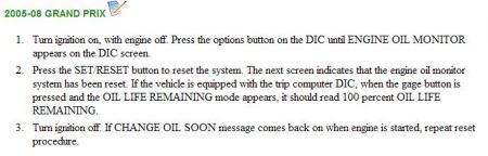

I just recently changed the oil in my 2007 GP, and after following the owners manual on how to reset the dash so my oil life would return to 100%, It wouldn't do it! Now every time I turn on my car I have to hear it beeping to "change oil soon!"...How can I reset that alert (since the owners manual did no help)????

Reset procedures are as follows:
https://images.2carpros.com/forum/automotive_pictures/261618_Noname_339.jpg
