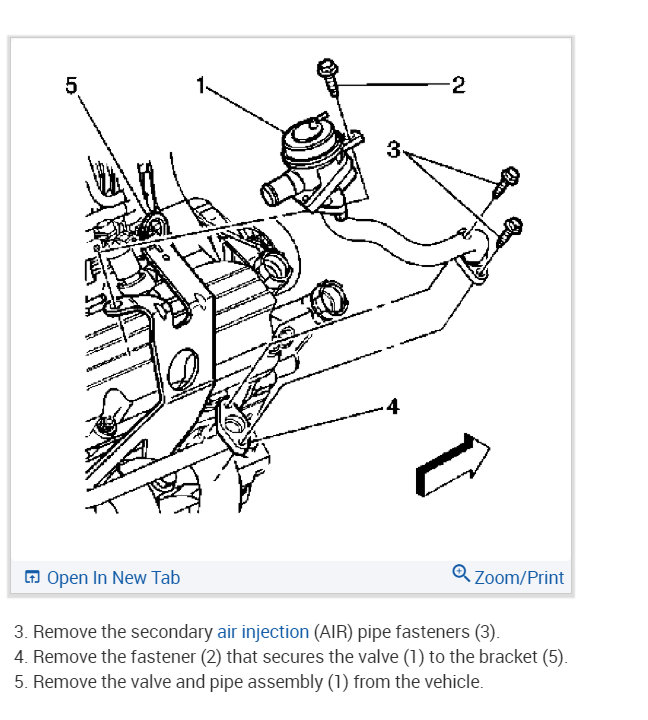

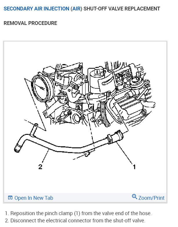

secondary air injection valve what is the problem most likely?
Jun 3, 2009 at 4:02 PM
BRIAN 1
  • 1,030 POSTS
This means the secondary air control valve needs to be replaced here are instructions and diagrams to help you get the job done. Check out the diagrams (Below). Please let us know if you need anything else to get the problem fixed.
