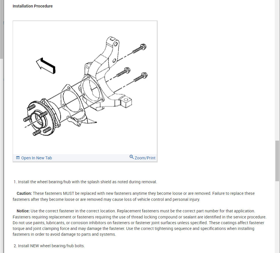

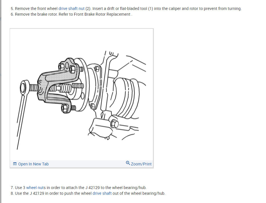

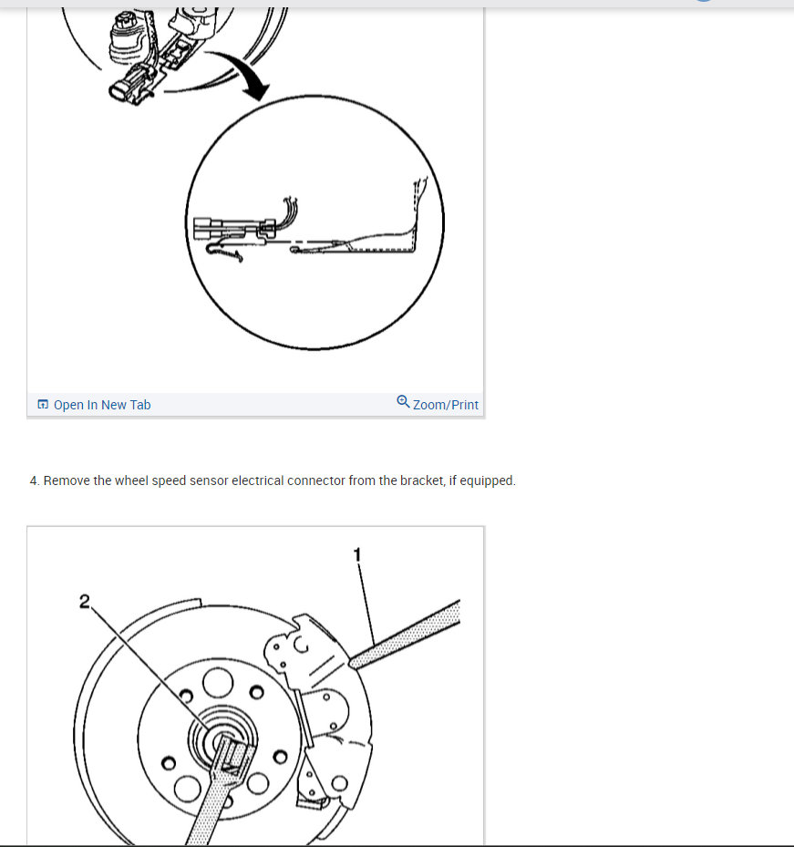

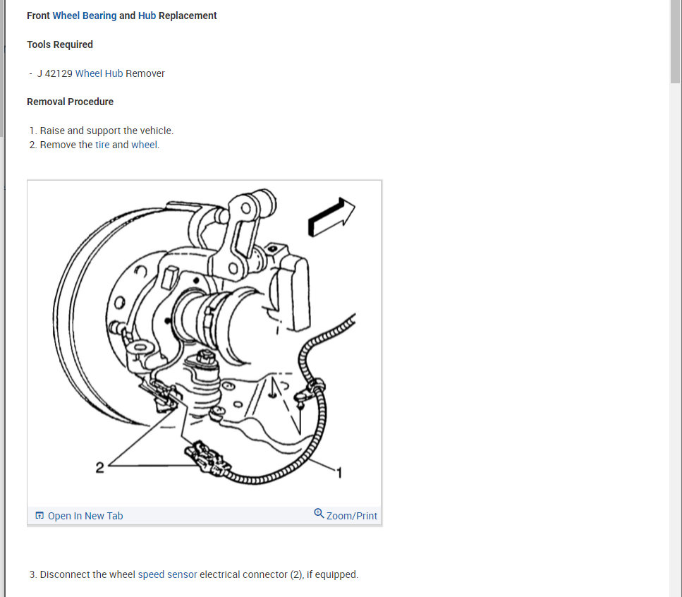

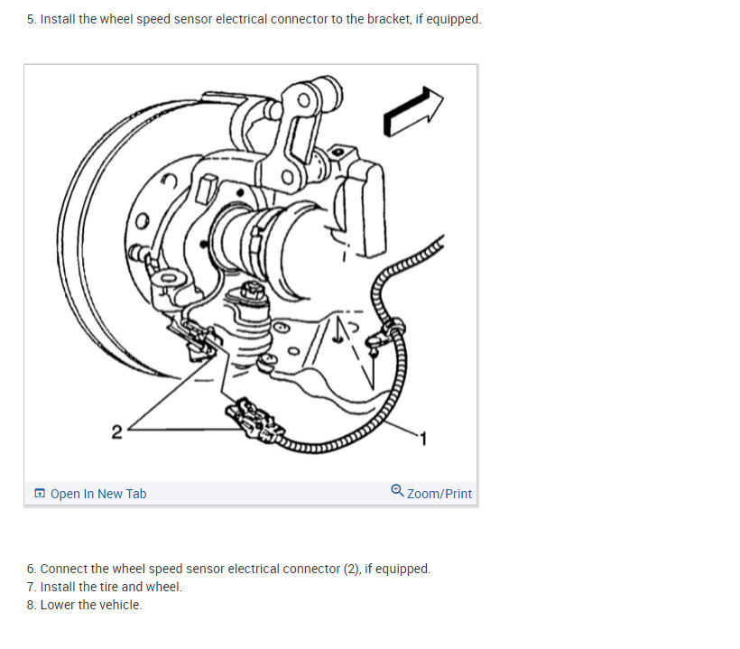

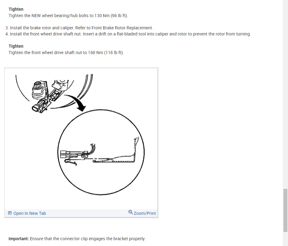

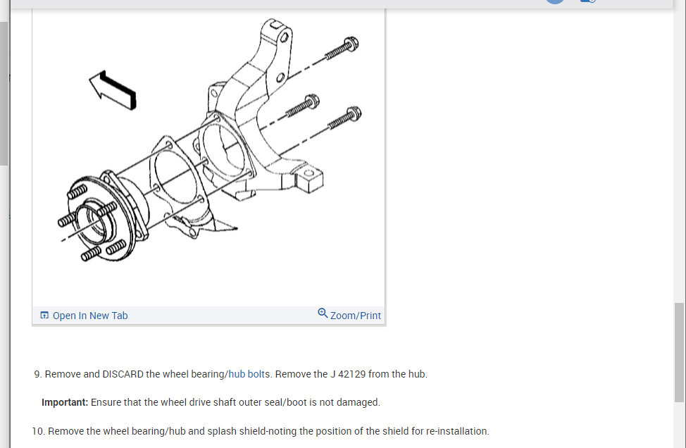

How do I remove the hub from the wheel to replace the bearings?
Saturday, November 15th, 2008 AT 12:44 PM
I am attaching the info on this below. However, here are a couple guides that will help with this as it provides step by step info on how to replace the bearing:
https://www.2carpros.com/articles/bearing-hub-replacement
https://www.2carpros.com/articles/bearing-press-how-to-use
Below is the process from the manual. Please review this material and let us know if you have other questions. Thanks
