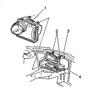

I would also check for corrosion at the PCM harness at the PCM,here is where the pcm is,
https://www.2carpros.com/forum/automotive_pictures/147643_pcm_2.jpg
the pcm is number 4. in all you will probably be replacing the pcm,if you do it needs to be programmed.sorry I wish I was in miami,im in NY.
