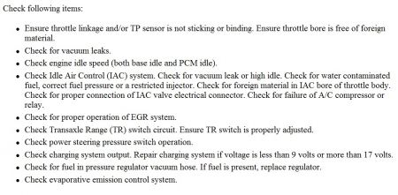

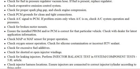

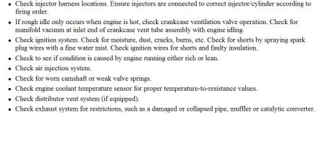

INTERNETMECHANIC
  • 700 POSTS
As far as no code diagnostics, the list of possibilities is as long as your arm. Listed below.
https://www.2carpros.com/forum/automotive_pictures/512072_no_code_diagnostics_1_1.jpg
https://www.2carpros.com/forum/automotive_pictures/512072_no_code_diagnostics_2_1.jpg
https://www.2carpros.com/forum/automotive_pictures/512072_no_code_diagnostics_3_1.jpg
