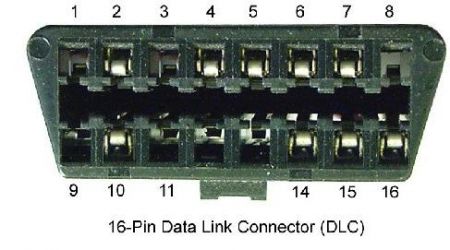

Hello, when you replaced the iac did you remove the throttle-body and give it a good cleaning, all the passages?
https://www.2carpros.com/forum/automotive_pictures/170934_16_pin_data_link_connector_2.jpg
you might check voltage and ground for the scanner at the datalink connector. Pin 16 is voltage, pin 4 is ground for the scanner.

Did you get a chance to check the pins at the data link connector?
Wednesday, June 17th, 2009 AT 12:35 PM
JAMESVOGEL15
Im not getting any power to it, is there a fuse that is inline with it or something?
Wednesday, June 17th, 2009 AT 1:32 PM
JDL
  • 16,098 POSTS
If there is no voltage at pin 16 of the data link connector, check cigar fuse 15 amp, also check that there is voltage to the fuse.
