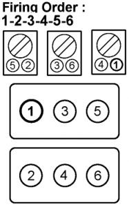

Firing sequence ofthe sprk plugs and where each wire needs to be placed by the number on the distributor cover
Friday, October 31st, 2008 AT 9:55 PM
BLUELIGHTNIN6
  • 16,542 POSTS
Since you did not specify which engine size, I will post both the 3.4 DOHC and the 3.1. Below are the firing order diagrams. Thanks for using 2carpros.com. Glad to help!
3.4 DOHC Engine Below
https://www.2carpros.com/forum/automotive_pictures/261618_81883193_1.gif
3.1 Engine Below
https://www.2carpros.com/forum/automotive_pictures/261618_81883193_1.jpg
