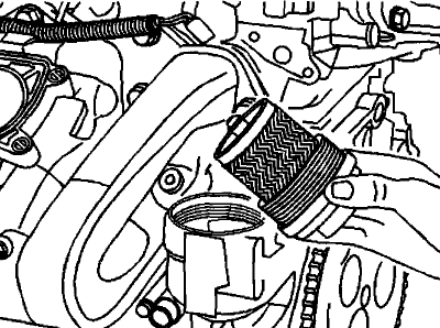

have a 2004 Pontiac grand am ct.engine light is on,change oil light is on. took it to autozone got a reading of the PCM got code 440...what do you recommend I do first? and where is the oil filter on this car?

My guess is you have the 2.2 motor. If I am right,
https://images.2carpros.com/forum/automotive_pictures/30961_oil_filter_1.gif
PO440 has to do with a problem in the evaporative system, possible sealing, purge valve or solenoid problem. Pretty tough for a do-it -yourselfer. Either you throw parts at it or have a shop with quality scanners and smoke machines diagnosis it.
