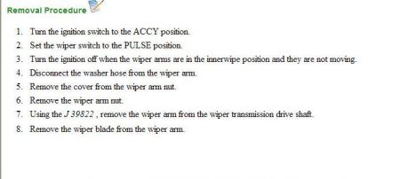

What are the steps to the passenger side wiper arm?
I have removed the nut but still can't seem to pull the arm off.
The pin between the wiper arm and the transmission arm is sheared.
How do I replace this?

https://images.2carpros.com/forum/automotive_pictures/261618_Noname_1411.jpg
https://images.2carpros.com/forum/automotive_pictures/261618_Graphic_261.jpg
Side note: The J tool is a puller designed to remove the arm from the tapered/splined shaft that it is attached to. Sometimes you can get your fingers under them on both sides and wiggle them while pulling up until it comes off
