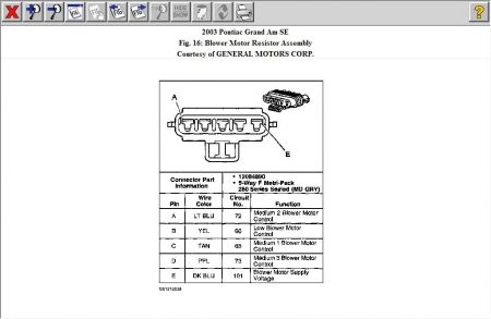

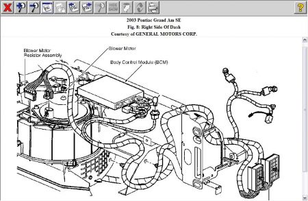

The blower fan works, but only when I put it on the #5 setting. #1 to #4 doesn't blow, but the heater does appear to work. I think it just needs a new blower fan switch, but I don't have any idea how to replace. Is there somewhere that I can get pictured instructions to remove the section of the dash and how to replace this switch? Hopefully there is a free place on the internet to obtain this information.
Any suggestions?

Sounds more like the blower motor resistor is defective-Go ahead and inspec/test the blower relay in the underhood fuse block. Also see below
https://images.2carpros.com/forum/automotive_pictures/12900_blower_motor_resistor_2.jpg
https://images.2carpros.com/forum/automotive_pictures/12900_blower_motor_location_1.jpg
