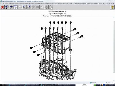

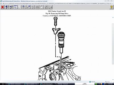

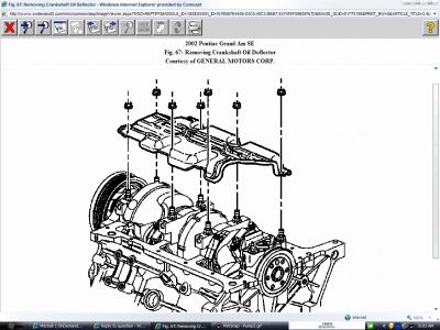

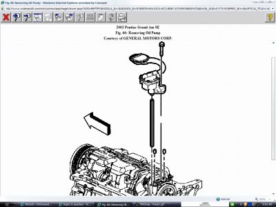

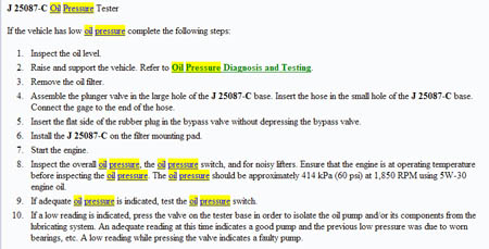

I have had this happen 2 time in the last 2 months. When I start my car the rubber seal on the oill filter has blown out between the filter and the block and of course lose all of the oil. I have the correct filter and use good ones like Fram, use the right oil, there were no extra seals from prior oil changes left on the block and I use a filter wrench to tighten the filter. The temperature outside has been in the 20's both times.
Is there a reason that there is so much extra pressure built up in the engine that it causes this to happen?
Friday, February 22nd, 2008 AT 6:14 AM
MERLIN2021
  • 17,250 POSTS
Could be the pressure regulator is sticking, and in cold weather if that happens, it's like trying to pump molasses.....Might be time to change that oil pump.
