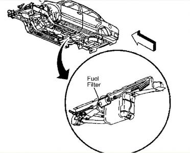

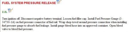

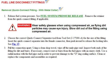

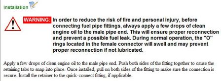

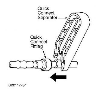

Do you know where the fuel filter is mounted? Last time I've ever changed a fuel filter on a car, it was back when they were still mounted inside the frame near the tank. With these newer style cars, I don't know if they are in the tank (which I doubt) - or up near the engine somewhere.
Second, is there anyway to test a coil pack...or is it just wise to swap it out?
Thanks again! Randy
Jan 16, 2009 at 2:37 PM
BLUELIGHTNIN6
  • 16,542 POSTS

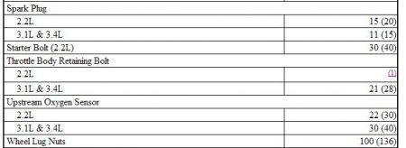

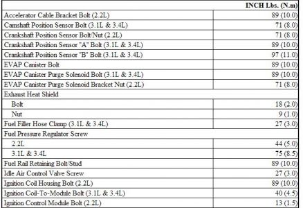

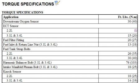

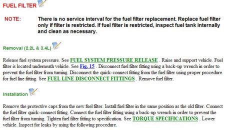

No problem. Your fuel filter is located below vehicle, in the middle of underbody on fuel rail (pictured below) .
https://images.2carpros.com/forum/automotive_pictures/261618_Noname_146.jpg
Removal and installation procedures are listed below for your fuel filter.
https://images.2carpros.com/forum/automotive_pictures/261618_Noname2_51.jpg
https://images.2carpros.com/forum/automotive_pictures/261618_3_2.jpg
https://images.2carpros.com/forum/automotive_pictures/261618_Noname4_12.jpg
https://images.2carpros.com/forum/automotive_pictures/261618_Noname5_6.jpg
https://images.2carpros.com/forum/automotive_pictures/261618_Noname6_2.jpg
FIGURE 13
https://images.2carpros.com/forum/automotive_pictures/261618_Noname_147.jpg
https://images.2carpros.com/forum/automotive_pictures/261618_spec_2.jpg
https://images.2carpros.com/forum/automotive_pictures/261618_spec2_3.jpg
https://images.2carpros.com/forum/automotive_pictures/261618_sp3_1.jpg
https://images.2carpros.com/forum/automotive_pictures/261618_sp4_1.jpg
You can review the following link for testing your ignition system, including your coil packs. https://www.2carpros.com/how_to/how_to_test_an_ignition_system.htm Hope this helps.. Thanks for using 2CarPros.com !

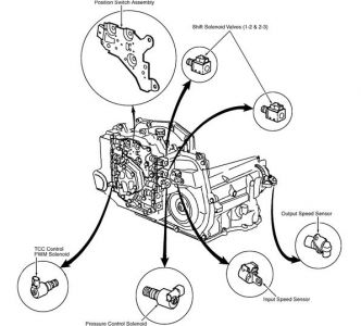

RWBENNER
Previously, you responded to a query I had about bad gas milage (the below thread will hopefully bring you back up to speed again).
You had asked that I let you know how things went after making the changes you suggested (which I've done). Unfortunately, the fuel milage is still the same (24-25 city OR highway).
In the same vein, I have noticed that at turpike speeds, in overdrive, the car will barely ever drop into (what I call) the "lock-out" or "lock-up" for the tourqe converter (when the tourqe converter locks - much like a standard transmission). You'll occasionally see the RPM dip when it does lock, but it holds it for only seconds. It is not dependent on speed, incline, or head wind. It just fails to lock.
Is not that locking mechanism electronically controlled? If so, I'm thinking about changing that part since the RPM never really drops to a crusing RPM - thus burning more fuel and contributing to poor fuel milage. I just don't know where that sensor/control module is...could you help with locating it?
Anyway, I was going to change the tranny fluid and filter while there. Figured with 90,000 miles, it would be time to do so.
Looking forward to your reply, and thanks again. I'm sure eventually we'll figure this out :)
Enjoy the day. Randy Benner
Apr 15, 2009 at 8:43 AM
BLUELIGHTNIN6
  • 16,542 POSTS

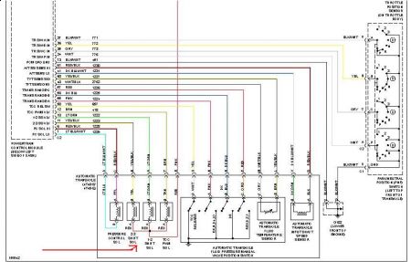

Hello The TCC (torque converter control) PWM solenoid is what you are speaking of. It is located in the transaxle valve body, pictured below...
https://images.2carpros.com/forum/automotive_pictures/261618_Noname_456.jpg
Apr 15, 2009 at 4:31 PM
RWBENNER
Does this solenoid have an external electrical module to control it that mounts to the tranny, or is the whole thing controlled through tranny fluid flow/pressure internally? I used to have a chevy beretta that had an external electrical switch that mounted to the tranny. When it failed, I just replaced it. I was hoping this GM product was similar.
I'm looking for what I can service extenally, without having to remove all the stuff needed to even reach the tranny side cover and pull it off to get to this TCC PWM solenoid.
Thanks again.
Apr 16, 2009 at 5:25 AM
BLUELIGHTNIN6
  • 16,542 POSTS
Below is the wiring diagram for the solenoid I dug up for ya..
https://images.2carpros.com/forum/automotive_pictures/261618_Noname_457.jpg
may need to email to you so you can read it better..what is your email?
