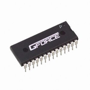

How do I put the chip in my pontiac. I cant figure it out.
http://www.2carpros.com/forum/automotive_pictures/567742_gforcechip_1.jpg

1996 and later have OBDII PCM's. Eariler (95 eariler) have the PROM chip pictured, 96 and later do not have a removeable chip.
This is either for an eariler model or there should be another unit the chip plugs into and then plugs into the pcm.
